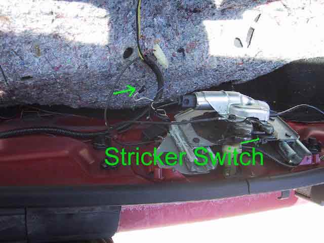

the electric release and the actually pull down is seprete systems. I take it that the thing is stuck in the down position, If you look at the part where the hatch side would contact the catch, there is a little switch (stricker switch) play with the switch and see if it goes up or moves at all. I don't know what the tan wire does I can't rember (Look at topdown solutions site, he has a rebuilt one, or parts needed to rebuild them). Use a test light and see if you are getting power back there, if not the fuse (its a inline fuse located near the fuse box but not in it) may be bad. There is a relay back there that can cause it also.
Hey Lon, thanks again for the parts I ordered a few months ago, fixed me right up :-), but I wanted to point out that My 89 Formula the fuse is an inline fuse adjacent to the box, not in the box, and my car is all stock.

Figured a pic might help, also there is a reverse switch that is hard to get to without taking it off the car, but its normally the stricker. Mine went bad and kept engaging and killing my battery, took me forever to figure it out.
