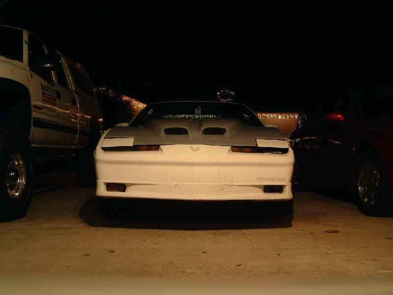

Alright, this weekend, i picked up a ws6 style ram air hood for my 88 TA, and.. it like, goes on & all, but, it's to the left a bit(looking at the car from the front), and the front latches fine, but the sides are up...
Do you think i just need to have the company send me a diff hood, or, would this one work, just needs new hood hinges or some working with? cuz... i don't really wanna do pins to keep the sides down, i really don't.
I had to let mine "settle" for a week or so. The side were up like yours, and the ends by the cowl stuck up a bit. After a while, it just seemed to fit better. Got it painted and now it looks great.
I did use hood pins on the front, due to the hood "floating" at high speeds.
Make sure your hood stops are adjusted all the way down. If still there, take the rubber off of them, too. If you have a STB, might want to take that off and see if it helps. Had to sell my STB because the hood would not sit down right with it on.

aligning hoods are a pain. could be a few things. if you lift the hood up there are them little black rubber things you can screw up and down.. to adjust your hood. that is probably the problem but if you adjust that and it still doesn't look right.. make sure you got a few helpign hands and lossen the bolts back up and make sure the hood is slid to were it has to be. putting a new hood on isn't going to be perfectly aligned in one shot. it's definitely a pain in the ***. good luck

still, what's a strut tower brace, i'm guessing a peice on the hood hinge?
See... here's the main problem.. i can live with it being to one of the sides a bit... but it seems as if the hood just isn't being pushed down far enough in the front... i took out all the rubber stoppers... When i press down on the hood, where you'd put hood pins, the hood is almost fine.. espically on the right side(looking straight on at the car), but the left is still off a bit... i don't want to do pins... Maybe the hood was warpped from being in the manufacturer's trailer, from tennessee?
Imma give it a week, like 88 said, and if it's still all screwy by then, well, i'll call the manufacturer, and ask them... Also, my fender is messed up, so imma put on the new one and see if that fixes anything.

Dont worry, an STB is an aftermarked add-on, and if you dont know about it, then you dont have one. Its a piece which ties both strut towers together.
The hood not sitting right isnt your fault. There has been a recent rash around here with these hoods not fitting, demostrating the exact problem you have. Alot of people claim that no fiberglass hoods fit correctly without work, which is sometimes true. Alot also claim that the age of these cars causes the frames to warp and settle... this is true also. BUT, the hood fitment issue you, as with MANY others discribe, is a manufactures defect, plain and simple, which has yet to be dealt with. The problem is that the hood does not follow the curve of the front end, resulting in the hood almost looking flat, where in reality it should be domed. I will not buy one until the issue is properly addressed by the manufacturer.

figured it was either the bar that went accross or part of the hinges.
& possibly i shall send the hood back in after about a week, after i get my fender on & see how it all works out then.
thx for the info about the hoods..

THE HOOD WAS MADE WRONG. THE FIREBIRDS FRONT END IS CURVED, AND THE RAII HOOD IS FLAT. IT DOES NOT FIT.
Now, if you look at the lines Ive drawn, youll see that the red headlight lines intersect perfecly in the center, on the exact same angle. Now, notice the yellow lines which follows the hoods structure... they dont even intersect anywhere, and aside from that, theyre almost perfectly flat. YOU DECIDE.

Why adjust the front clip? Because after 10-15 years, screws come loose, stuff happens, and everything moves around sometimes. If you can't move the hood down anymore, then logically move everything else up. You have to adjust everything to make it look right and line up with the doors. I'm not saying move the thing 3 inches, but a half inch or so isnt too bad.
Besides, its not like each hood is custm made for peoples cars, their made in a mold in bulk, so yeah, theres bound to be some that don't fit perfectly. Why don't you think about that before you start calling people morons.
PS. Here's your car. Hood looks pretty flat to me.

Really? Coulda fooled me. If ya wanna use my car as an example, at least find the right angle to know what the hell Im talking about.

Yeah thats Triggers car... now ya see what Im sayin. Granted, Ive seen a select few hoods look nice, but the owners never said how much work was needed to get it that way.
The thing Im most pissed off about is the fact that I want one of these damn hoods BAD, but Im not paying for junk, and especially not losing money if I have to send back a defective product. I just wish ASCD would do the right things with these issues, fix the molds or what ever is the problem, and make a good hood again.

ah, ya, sorry, still didn't do the pix thing.. um..
maybe i will tomorrow, but.. hey, i think i figured it out, i had a friend of mine that works at an auto shop.. and he looked at it, he noticed, the brackets, they didn't let the hood settle right, for the front.. which i noticed as well. i had ralized this before, that they where quite massivly spaced, but never thought much of it.
anyways, since i got in my fender, after i paint it, & put it on, i'm going to mess with the holes on the hood brakcets.. as well as bend them back into place. and then see if that helps.
see.. the holes are just too far down on the hood, and i'm not about to drill into the hood, esp w/ the chance of sending it back if it doesn't work. so i'm going to drill out the hole more on the bracket, going up... so the screw can rest down easier.. wait.. no, drill the hole down on the bracket, sorry... anywyas, goodnight, going to bed. :-D
