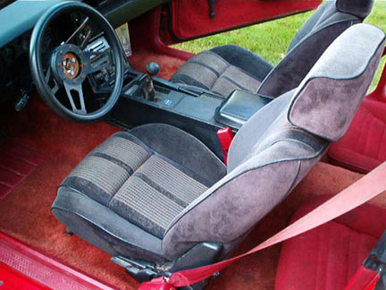

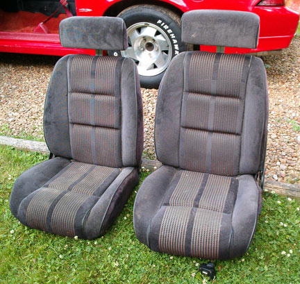

Here's the Cavalier seats that went in; not exactly red, but a big improvement:

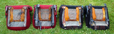

Side by side seat comparison, they were EXACTLY the same on the bottoms/mounting areas... swapping tracks was effortless:

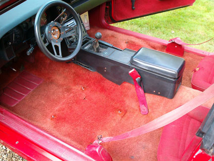

Freshly scrubbed carpet... still wet; Febreze knocked that funky old carpet odor down too... the trick to getting it clean (or semi-clean) is to soap-up the carpet REALLY well w/ a thick solution of color-safe-bleach, laundry detergent, and water... then scrub the H3LL out of it w/ the scrub brush until foamy(you'll be able to tell when it's time to quit scrubbing).
Then use a bucket of clear water & a towel to 'mop up the grime/soap residue'. Wring out towel and dump/refill the water when dirty... REPEAT process until the towel/water remains semi-clear when rung out.
(Approx. time - total - 1 hr. for both sides).

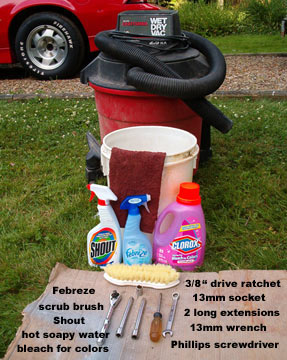

Tools/Cleaners used:
The job was pretty easy; I cleaned-up & sprayed the slightly rusty seat tracks w/ black spray paint and lubed them up well w/ PB Blaster and axle lube.
The most time consuming part of the whole job was getting that NASTY carpet clean.
