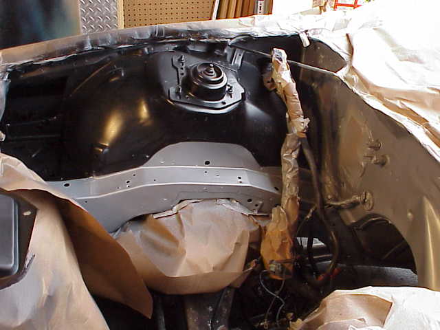

This is with a Campbell Hausfeld special. Colors are GM metallic black, and GM metallic silver. Took the better part of a weekend to prep and spray. Why have someone do easy work, and get paid a bunch of money to do it? I'm talking about removing the wire harness and heater box here.
Attached Thumbnails Painting Engine Compartment-c-documents-settings-administrator
