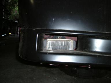

I have had a problem with my foglights being misaligned with their slots in the bumper with my 1988 Trans Am GTA. The car seemed to have this issue when I bought it, I never really noticed it. The fog lights seemed to sit too low and are partially "blocked" by the bumper. Anyway, I replaced the bumper cover (not because of this but because the paint was flaking off and it had some cracks) and the issue is still there. Is there anything that I can adjust or reposition to rectify this problem? or has anyone dealt with this same problem with their T/A or GTA?
I attached some pictures to show you what I am talking about.
Attached Thumbnails Foglight-Bumper alignment issues-c-documents-settings-ben

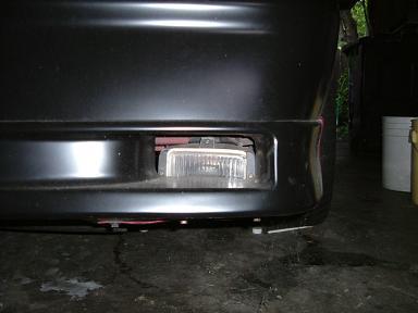

the other side....

The bumper itself seems to align ok with the rest of the car....

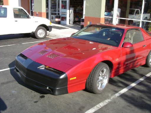

The "Tin Bumper" is really called the Impact Bar. If anything hits the nose of the car the Impact Bar is the first piece to bend. It is thin sheet metal so it crunches before the frame horns.
Anyway, the method I mentioned above will work fine the Impact bar is light enough material it will bend before anything else. If you wanted to do it right, you can take off the nose, and the impact bar and bend the mounting tabs back to factory. But I think that leaving it on the car is the easiest way.
---Or they do sell new impact bars if you don't want to bend yours
Did I say bend I meant "Adjust"
Impact Bar Circled in RED
Jake
Attached Thumbnails Foglight-Bumper alignment issues-c-documents-settings-hp

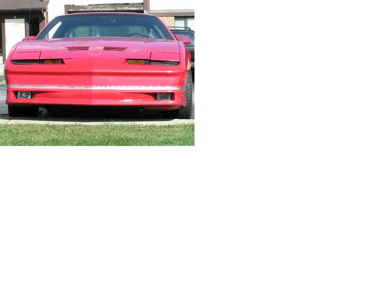

The Impact Bar is what the fog lights mount too therefore..
Impact Bar Bent = Fog light misalignment
In the pictures of your car you can see the metal that the fog lights mount to through the holes in the nose. You should not be able to see it. I have attached a picture of my car after I bent the Impact bar back up where it should have been.
Bending the Impact bar will not will not weaken it. It is just a piece of tin that protects the radiator in a light crash. If you take the front corner ground effects off you can see that it will not hurt it to bend it back up where it goes.
