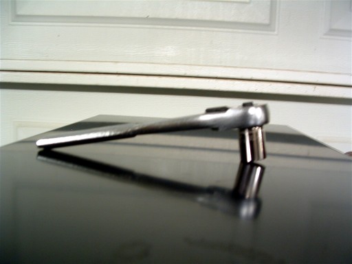

On my power seats the box end or ratcheting wrench would not work because of the seat rails. I had to attack it from above. Unless someone had the seat out before you and did something funky with the bolt, the ratchet and 14 mm socket will work. Like I posted before, not all ratchets are the same, the Craftsman I used was WAY slimmer that the first one and let me get in there.
Attached Thumbnails Taking seats out-c-documents-settings-dad
