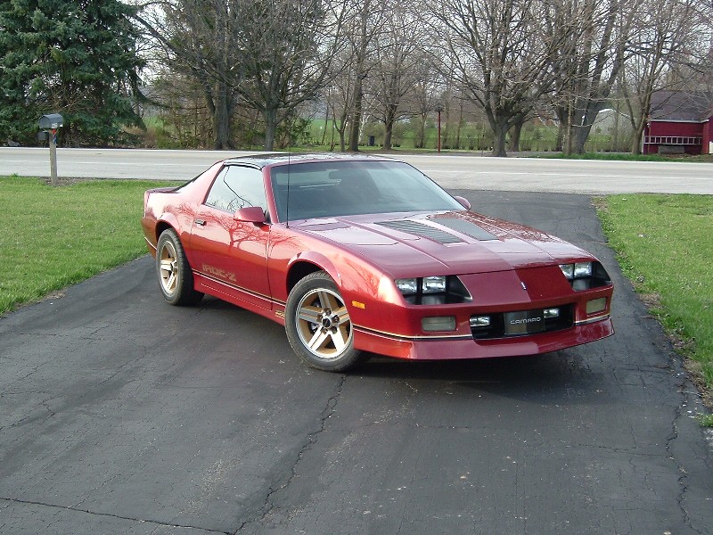

Attached Thumbnails IROC Front to Back Wheel Swap-frontsmall.jpg   IROC Front to Back Wheel Swap-background.jpg
