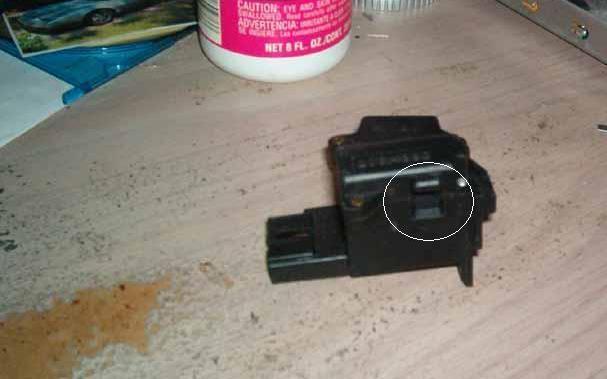

find the switch on the hatch lift motor... it looks like the one pictured below. FLip the switch on the switch to actuate its motion.
Attached Thumbnails How ironic...HATCH STUCK OPEN!-hatch-switch-002-2   How ironic...HATCH STUCK OPEN!-hatch-switch-003-2.jpg
