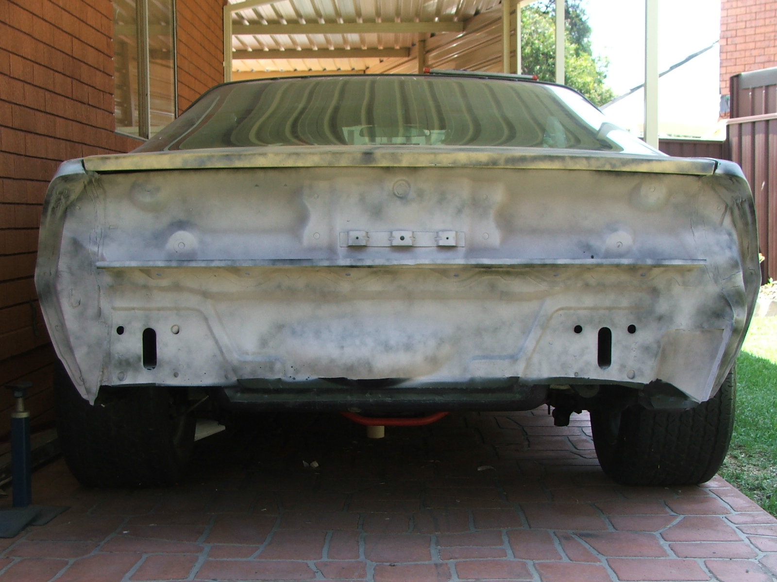

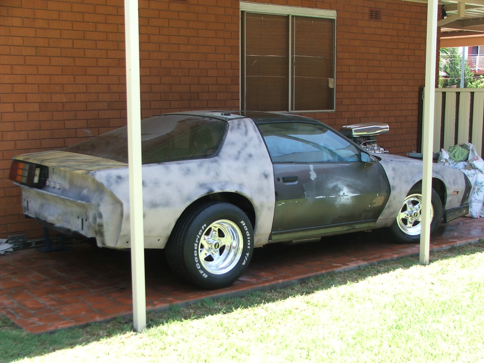

Here are a couple of pics.still needs some cleaning and a few chnges but it is getting there.
Jeff

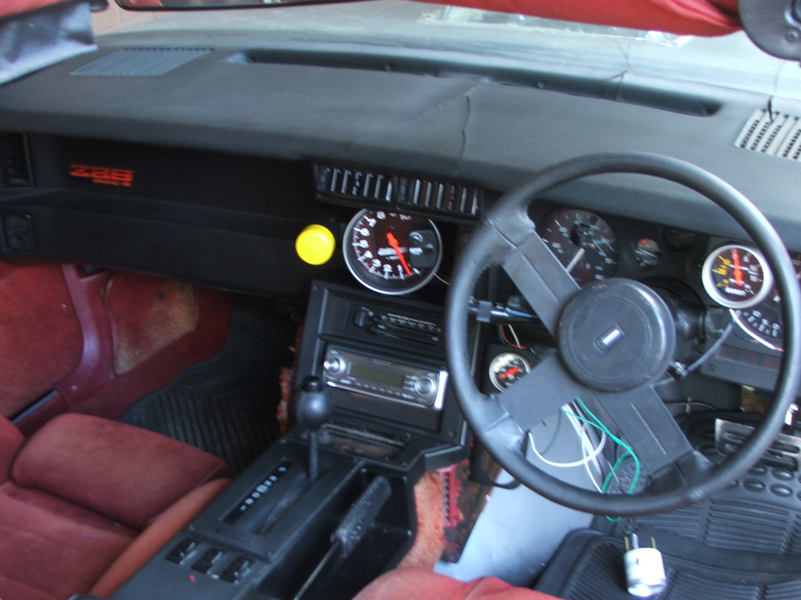

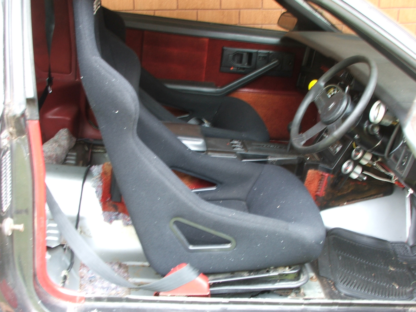

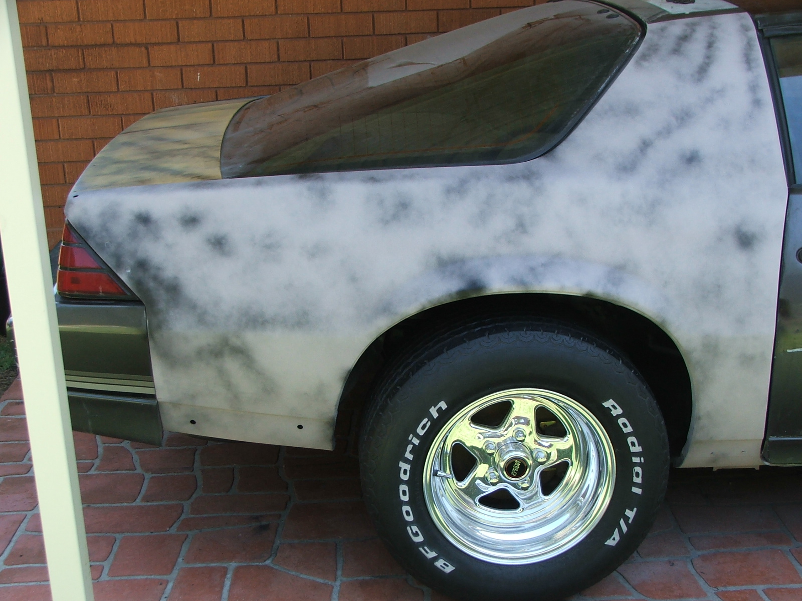

Here's the interior it need's to be redone so i am going all black and here's one more of the body prep.
Jeff.

I'm taking everything back to metal except the rear beaver panel, then spray a couple coat's of primer then a couple coat's of spray putty.
I don't know if this method is correct or not but it has worked for me in the past.
As for the rear of the car that's one place i was expecting some type of rust,but there was not a single bit.So i just sanded it with 180dry and then as above.
It should turn out alright.i'm not putting the final paint coat's on though that's getting done at a friend of a freind's smash repairs.
jeff.
