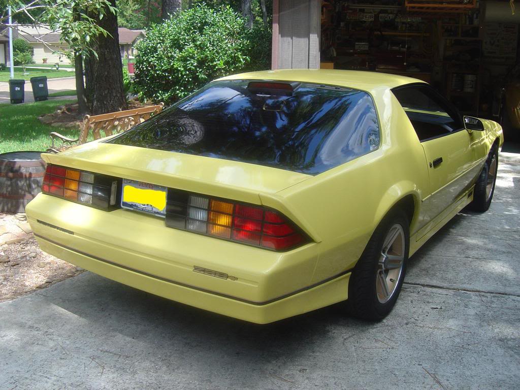

Originally Posted by Brennan
i have yet to see a thirdgen with a perfectly aligned hatch
my 86 iroc-z has a perfect hatch :-)
that is a beautiful car
