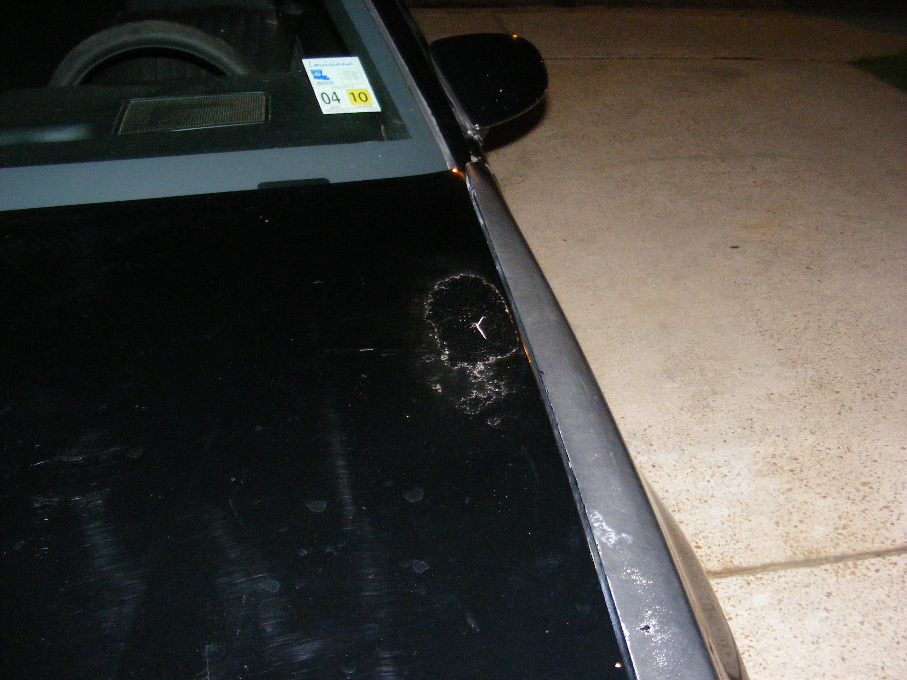

hey my name is jared and i have a 89 trans am 305 auto. there are a few things that i want to fix with the body but im having trouble find the parts. first off i think i just need new weather stripping but if i would want to replace the hatch where would be a good play to look. also someone jumped all on my hood and i need to replace it. the tail light on the right side has a hole in it and in the front driver side on the plastic part of the bumper there is a hole. other then that the clear coat is starting to come off at some spots and it looks like the trimming around the t-tops and back hatch is starting to rust. also in the future im planing on trying to do some upgrades with the engine ( i really want a new one) the exhaust system, and i have a 700R4 transmission sitting in my garage waiting to get put in. if anyone can help me with some ideas or web sites or even if you have parts please send me a PM or just reply. i also have pictures of the car at the bottom plus more on my profile. thanks.
Attached Thumbnails i need help finding things to fix up my 89 trans am. can anyone help?-dscf0321.jpg   i need help finding things to fix up my 89 trans am. can anyone help?-dscf0322.jpg   i need help finding things to fix up my 89 trans am. can anyone help?-dscf0331.jpg

modern day muscle can help ya with the parts like the bumper piece you are searching for and the weather stripping.
as for the paint, if its the orig paint then its due time for it to go south and start peeling. by now unless the car has been totally garage kept all third gens are ready for paint.

Welcome aboard and if you want to find the correct parts for your car you need to look for parts for a base model or Formula . From the pictures it looks as if you have a base Firebird . Check the 5th digit in the vin for a S or W . S is for Firebird or Formula and W is for Trans am . the 8th digit should be E or F or 8 . E is 305 TBI , F is 305 TPI , and 8 is 350 TPI .
