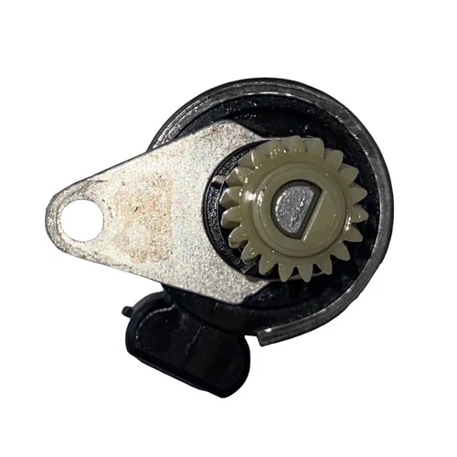

My 89 Firebird with a T5 has a gear-driven VSS:
T5 Camaro Firebird Large Can Speedometer Sensor 10456087 USED T-5 Speedo - Picture 1 of 8
T5 Camaro Firebird Large Can Speedometer Sensor 10456087 USED T-5 Speedo - Picture 3 of 8
The VSS unit I bought during my 5-speed swap came equipped with a 22-tooth gear, but after the swap my speedo was reading 10% low, so I was able to source a 19-tooth gear to account for some speedo inaccuracy (although now it reads 5% fast)
Now I get some minor speedo wiggle above 50 mph - think: +/- 1 or 2 mph, with more variation the faster I go.
I know the drive gear on the output shaft is a red 7-tooth and that the 7-tooth drive / 19-tooth driven gear combo is one that is commercially available for cable-driven speedo setups. Any ideas on cause?
