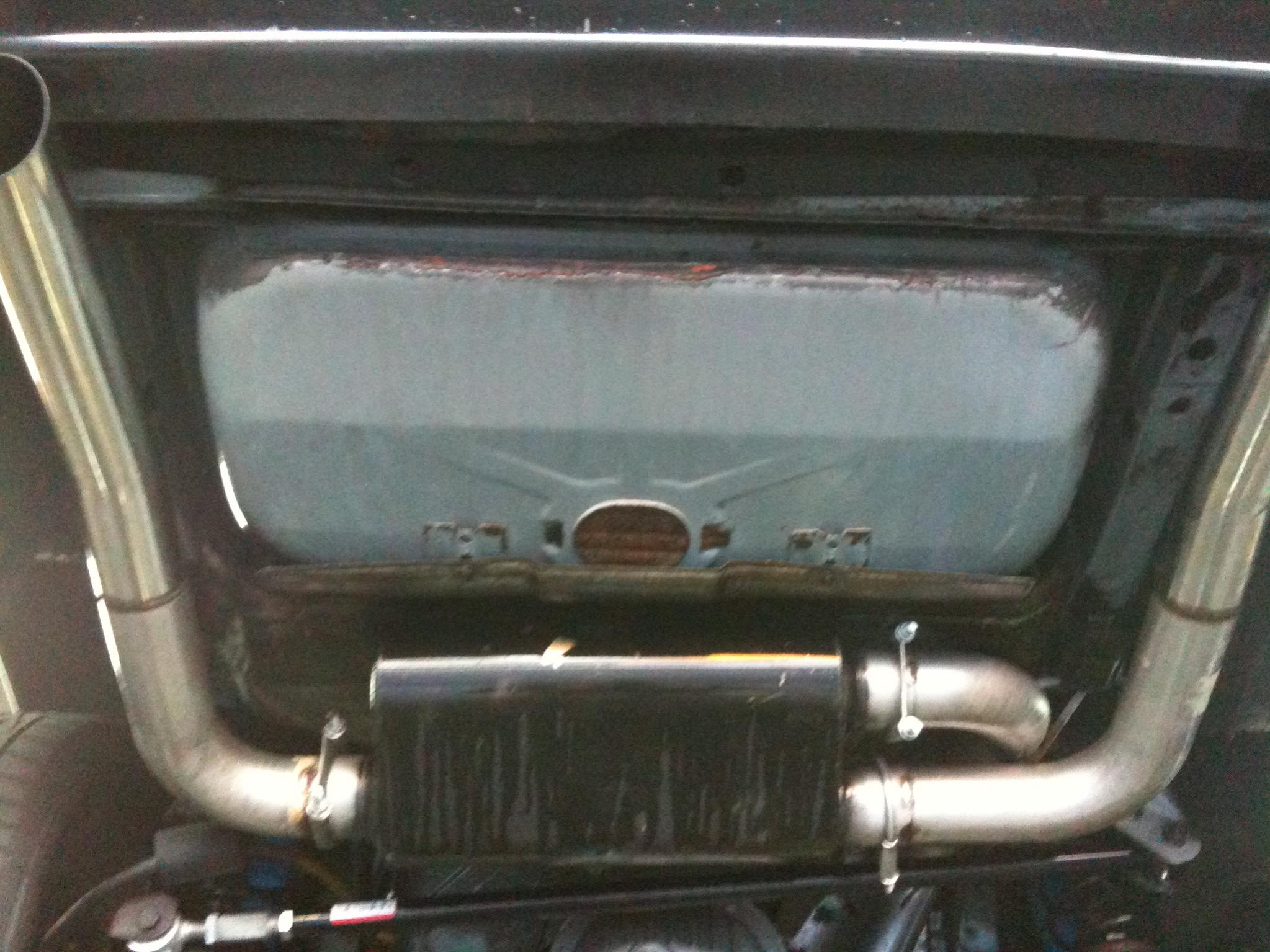

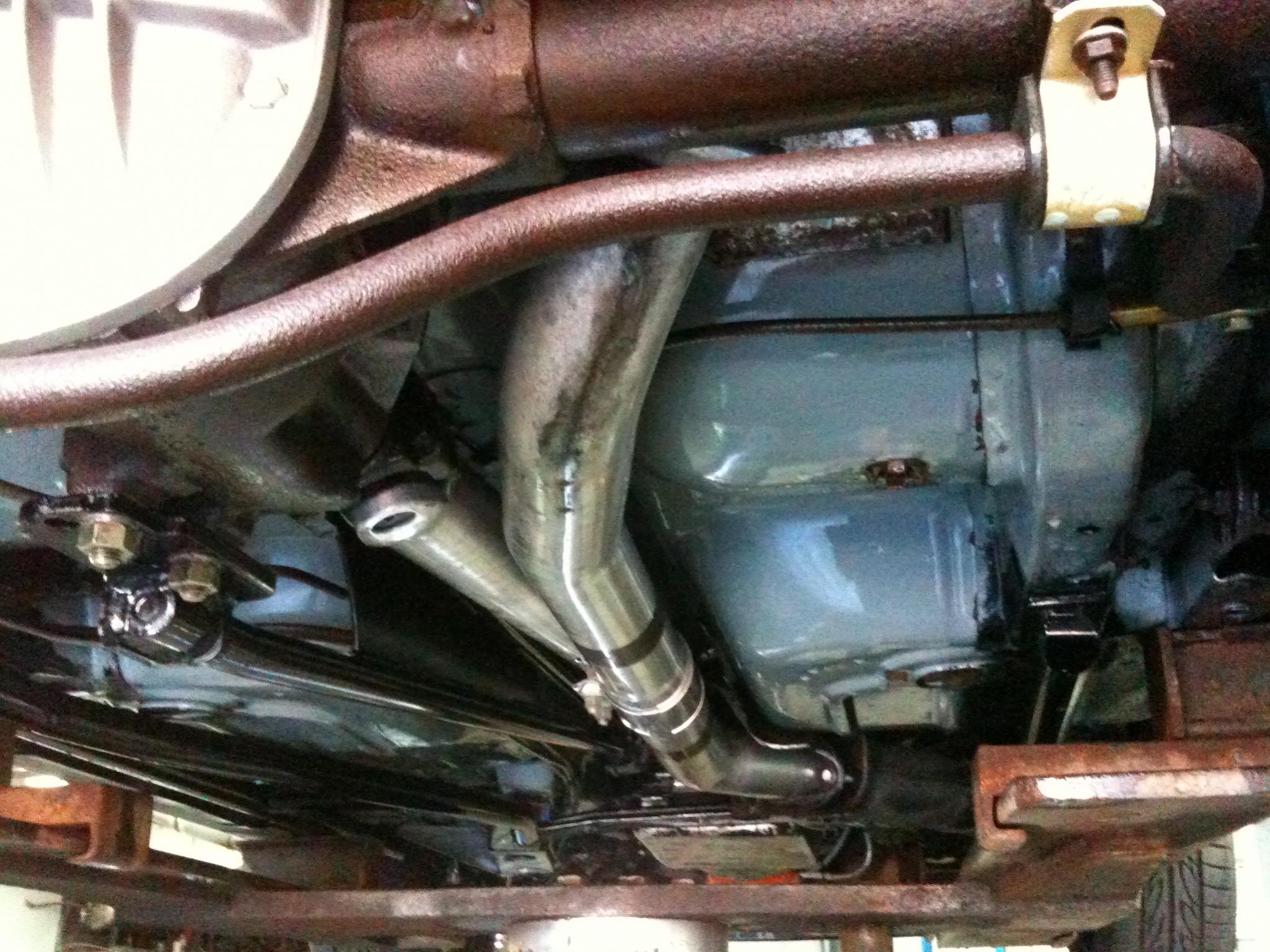

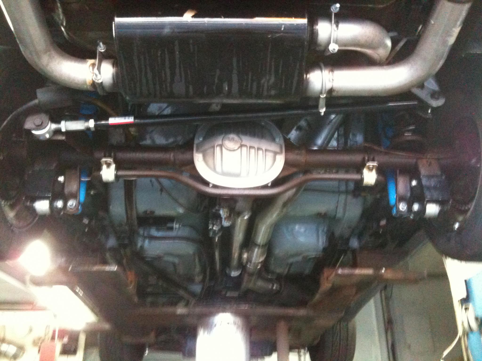

I too was wondering this.. But alas, today we used the degreaser Marine Clean and metal ready and are letting it dry overnight... So far, it just looks really clean underneath, no POR15 yet, just clean bare underbody:
Attached Thumbnails Por 15: paint bubbles-img_0323.jpg   Por 15: paint bubbles-img_0324.jpg   Por 15: paint bubbles-img_0331.jpg
