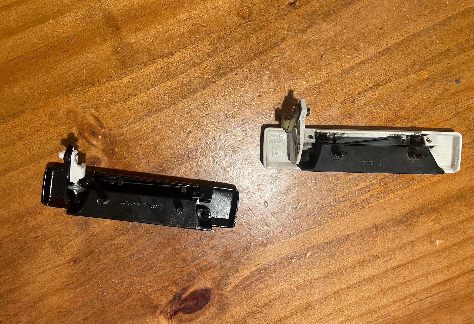

Nov 3, 2023 | 12:31 PM
Re: new door handles have no threads on studs
I’m not trying to restart a 13 year old thread. I’m just adding info to it for the next person who searches outer door handle replacement. I got the Dorman door handle from Amazon. I found a local body shop to paint it white through Yelp. I bought the self threading nuts from Lowe’s. I finally have a working door handle again.
