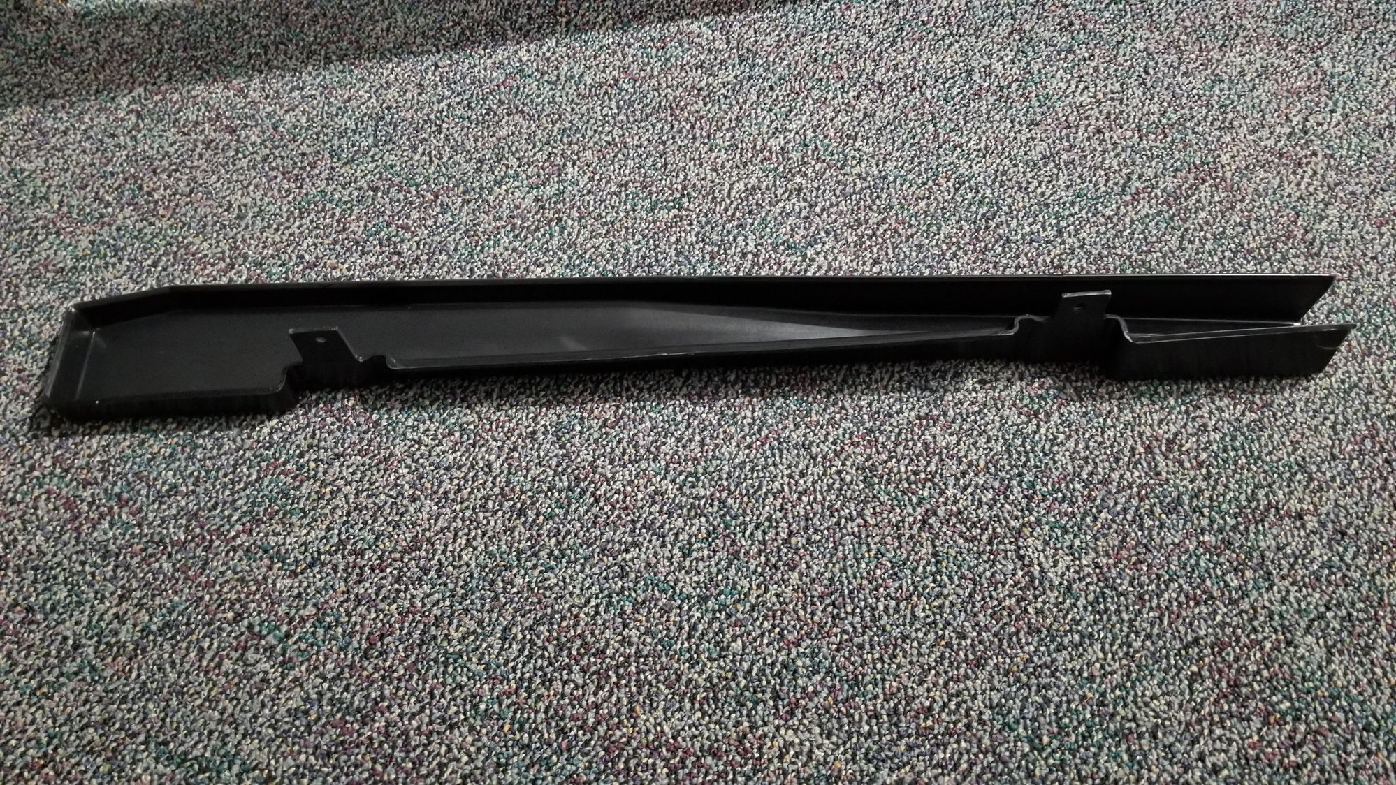

These setups look really cool and I love the the idea of having a functional scoop. Where does rainwater water drain though? Intuition tells me there MUST be some kind of drainage system in the design of the assembly otherwise you're literally pouring water down the throat of the intake.
Does anyone have any pics or could offer some explanation?

Have a drilled out plate over mine. I dont drive it in the rain very often but when i have i havent seen much water under the hood at all. I think heat escapes these hood scoops more so than they draw air in

there's a tray below the back edge. The water drains there down a spout. I've have a couple of the induction units but never had a tray.

Yes, the functional units came with a drip rail.
It attaches like I'm showing it, to the two outer bolts that attach the screen, and it dumps off to the driver side. Screen first, then the drip rail, then the bolts through both.

thanks for the pics!
