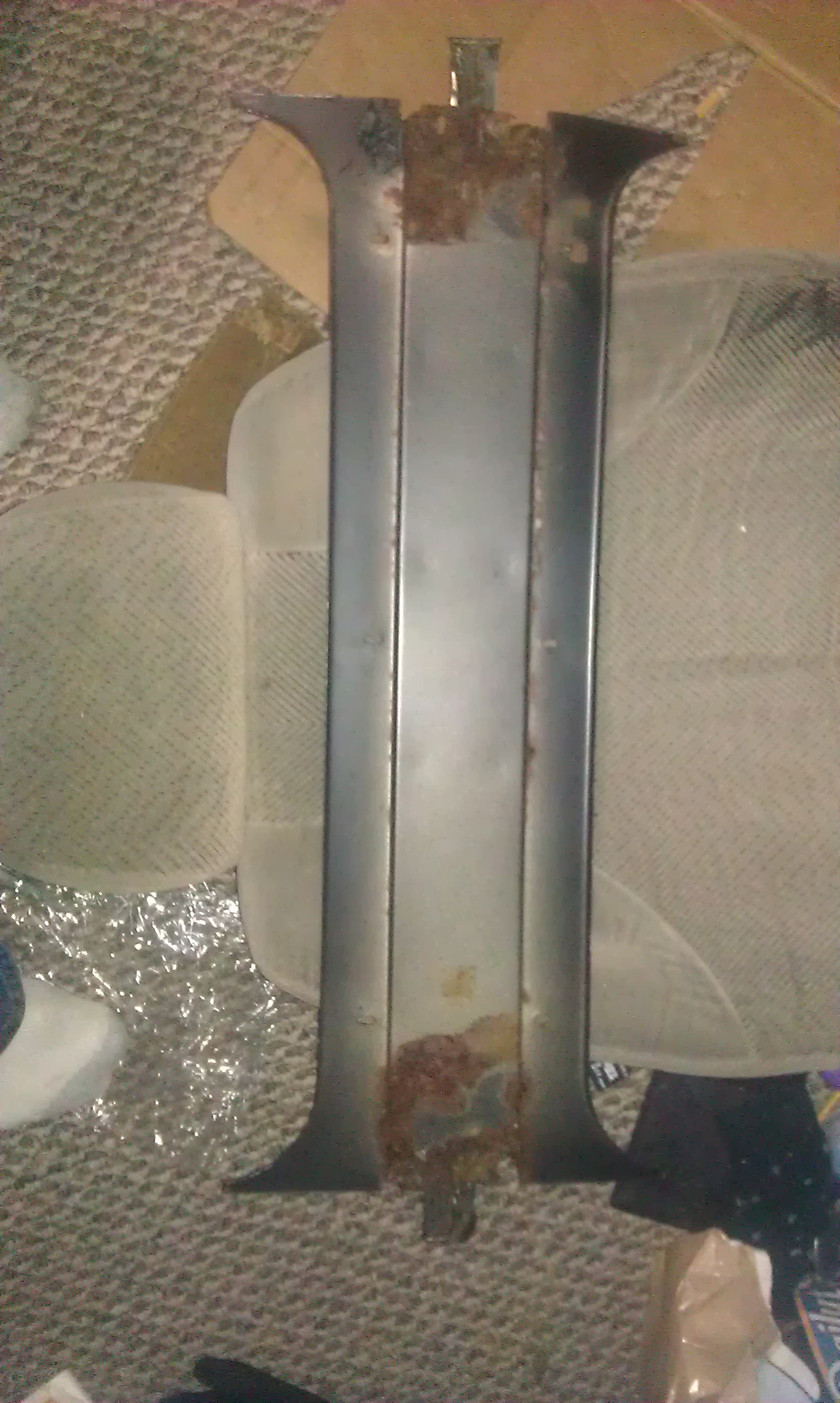

Just wanted to thank you guys, you were spot on for the problem. The body where the t-bar mounted was not that bad but the t-bar was worse than I thought.
I am including a pic to show how bad the t-bar was.
When I put the new(used) on in I made sure to rtv around the edges, screw points, and where the factory seam sealer was used. As an added protection I put a bead around the holes in the roof bar itself, to prevent water from being able to reach there.
Got a heavy rain a few days after I did this and only one leak left. The contact point for the rear of the passenger t-top. Working on that now and the interior goes back in.
I wanted to add, that rick's camaros really pulled through. The original seals I got really were and are crap. I showed them many pics and they went above and beyond and sent me a set of soft seal t-top seals as a replacement. If this is a shameless plug forgive me but they deserve props those seals they sent me are not cheap.
