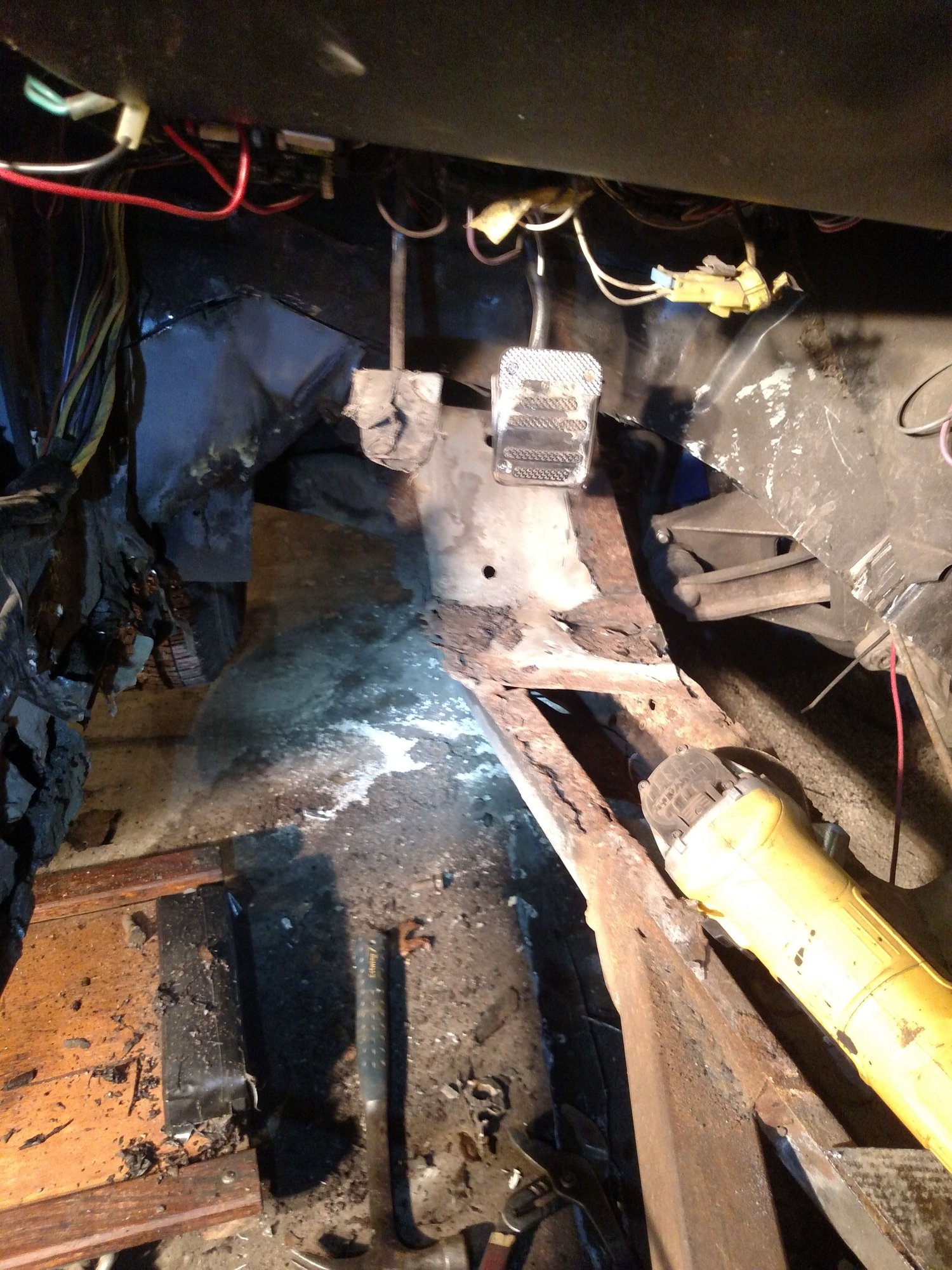

The back right floorboard, almost gone. Drivers floorboard was gone. Someone bought a new floorboard..then epoxied it in place. Drivers rear floor? See above. Drivers side went from pinch weld all the way to the trans tunnel, and almost to the firewall. The rockers got hit too.. Its BAD.
Had to stiffen this bad boy up asap, so I made SFC's out of some 2" square tubing and 1/4" thick plates and had a buddy MIG em on. So, so much better.
So, being that this is my one and only daily, and I have work m-f..I decided this weekend would be an excellent time to start cutting the floors out!
Easy enough to do with a MIG and some sheet metal, or a plasma cutter and my parts car.
If I had a MIG or plasma cutter, that is.

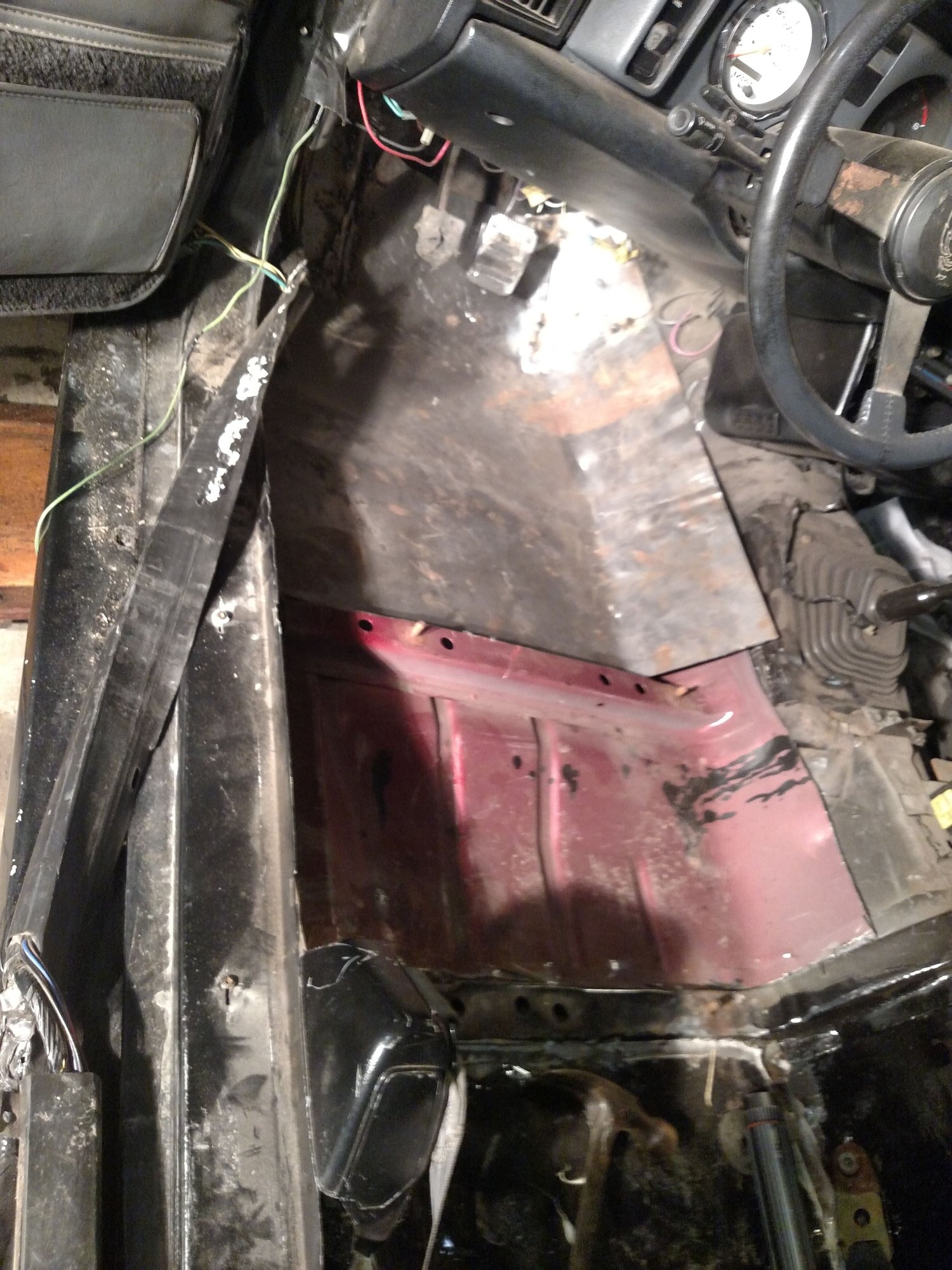

New floorboard in on one side!
It's in, sanded down most other surface rust and then painted a rust cost over the whole shebang.
I saw mixed reviews about por-15, and couldn't prep it properly being my DD, so I went with another product called Rust Trap by SEM. Have had excellent results with their products in the past. Cost $55 per qt.
I just used a wire brush attachment on my drill and went over everything, then blew the dust out and wiped everything down real good with acetone, wiping it before it evaporated.
Then just painted two coats on and let her dry!
This stuff is as dangerous as por-15 though. I wore a cannister respirator in an open shop with a fan going, and even though I couldn't smell it, I was getting light headed and dizzy after not long.
Be very, very careful with these products.
But I must say, I like how it came out! Seemed to adhere great to everything!

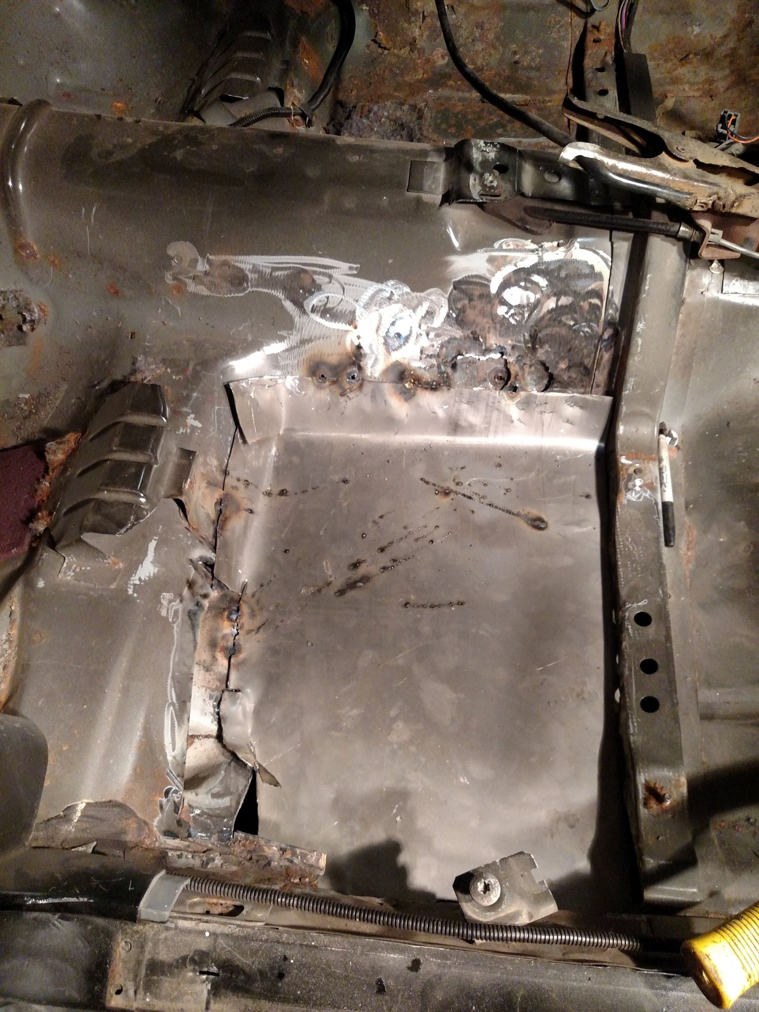

Finally got to the drivers side rear board.
It wasn't horrible. Went at it with a slag hammer to find all the spots where It was thin enough to like through.
Not bad, really. Would need a handful of patch panels, and all thread for the grooves.
But I was lazy, so I just cut the whole pan out.
It was at this moment that I realized I was out of welding rods, and my buddy with an oxy acet/tig rig isnt free till tomorrow.
The show must go on..
A baby floorplan being made! Eyeballed it. Looked like it was close enough (and its all the steel I had left. Easy decision!)
I then went to town on forming it. This side was a little more complex, due to being a different shape than the other side..
Deft hands, fine tools. Only the best crafting technique and tools, based on advanced level schooling. Basically I beat it with a hammer till it fit .
How's the saying go..measure once, cut twice? Doesn't work as well in reverse. Had a spot that was a liiiitttle short. That's what scrap metal is for..
More pics later! Today I'll be laying rust trap on the metal that will be under the pan, letting it cure, working on a BMW, then getting it welded up tomorrow!
Right now it's just held in by ductape.

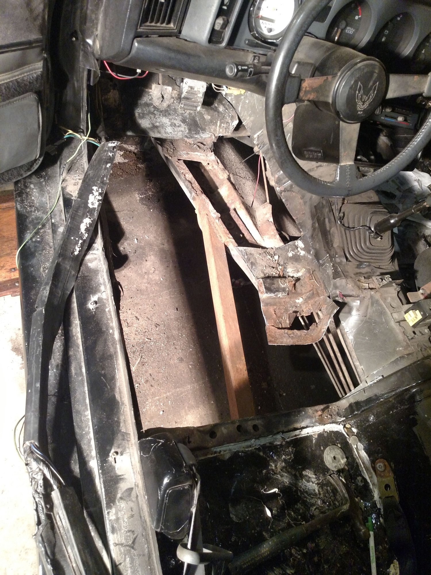

The drivers side..won't be fun. It's the entire pan from the seat mounts to under the pedals, rockers to the driveshaft tunnel. That's where things get tricky, being my daily driver and all..

More updates! Meant to get to this sooner, but life gets in the way sometimes. So do missing cam lobes.
Anyway..
The only spot I have left is the drivers floorboard/piece in-between seat mounts.
Haven't started cutting the crap from my 91 yet, but I started chopping the floor from my 87, and using the rest of the car to form the rest of the pan.
As is now. Doesn't do justice to showing how bad it is, the panel that's there now
Is the replacent that a P.O. epoxied in. From underside really shows how bad..
More pics on that later.
Anyway, here's a few of the new pan being made.
19 ga steel, a saws all, angle grinder/cutter and a hammer
And the piece I chopped from my parts car, frame rail and fuel lines full of fuel and all.
Plan is to finish getting it formed, then next weekend chop out the old, in with the new.
It'll be a bit crude, but who cares, it works.
More Joe dirt style pics coming later!

Huzzah, more updates!
Huzzah! All done with an angle grinder, broken shop lights, a can of skoal straight and a can of monster.
I was just reaaaaaly careful around the fuel lines. I unbolted em from the frame so I had another half inch or so. Also removed the gas pedal, made it much easier. Would have been even easier without the brake and clutch pedal, but who has time for that.
Frame is bent a little from the floor being gone, but she still drives perfectly straight and doesn't eat tires, so hakunahmatata there.
Yummy rust.. A little inside the frame rails, gonna clean it up and hit it with rust mort, then a coating
Forgot to order more rust trap, and por-15..just..no.. So imma try something else, perhaps
Chassis saver.
Fender was bolted straight to the replacement floor..and promptly rusted.
And the new pan! I didn't actually measure anything, I just kinda..cut, and tac'd up a new piece.
So I was surprised that it fit almost perfectly. Maybe a handful of small spots where I'll need a filler bolt/rebar, but not a whole lot.
Finishing prep today, then planning on welding tomorrow, then hitting everything else with phosphoric acid, followed by more rust coating top and bottom.
Sucks about not having rust trap, that stuff works pretty well.
I prepped the inside of my car nicely, and it worked..nicely.
The bottom of the new pans, though, I used whatever was around.
Basically carb/brake cleaner and a rag, yet its holding up very nicely there too.

Got everything in! A mix of tig and stick, its just little 2" welds everywhere,
Enough that I could drive with ease. Gonna go back over it Tuesday with oxy/acet and tig to connect the dots.
Closer shot
Here you can see the Dumbass marks, where I cut once and didn't measure. Gonna stick some bolts or rebar in and fill it..
Getting behind the pedals..sucked..
