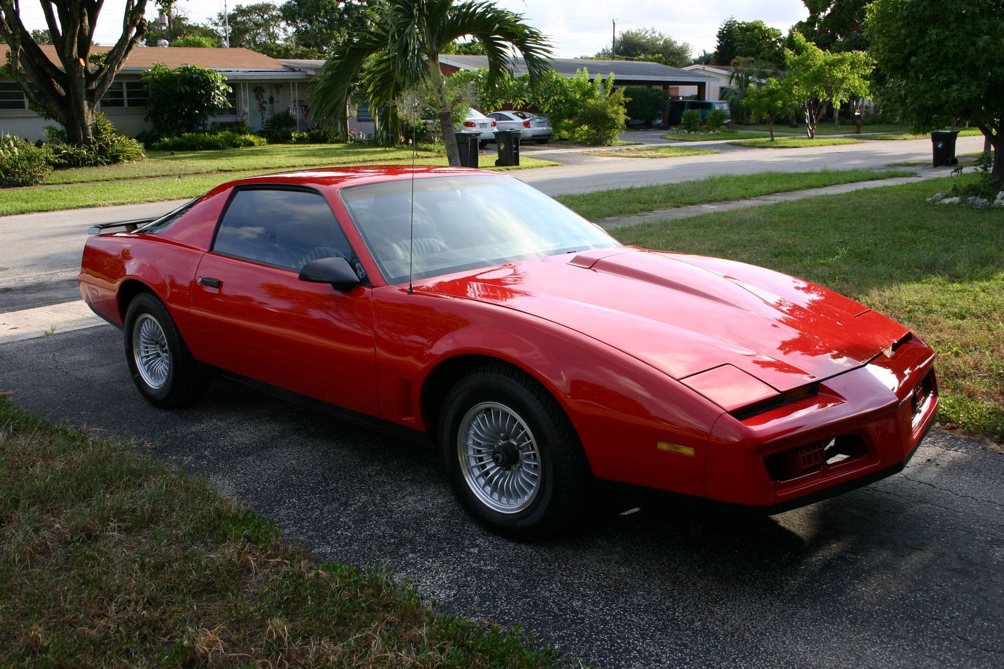

This is the car and why I want to swap out the rusty floor pans... this picture was taken before the new grills were in place. The hub caps have also all be replaced.

That's a bad azz ThirdGen. My 1st didn't have any special value to me other than it was my 1st. It's a V6, Black on Black and I had hope for it but the rust was to far gone and being in Ohio, I should've researched and inspected a little more before I jumped in and threw away $1400 bucks....Cost of car $500, remainder was Parts & Labor. Then again I got what I paid for. You situation is very different, and that gem of a TirdGen you have there I wouldn't let go either and would restore it at all cost.
