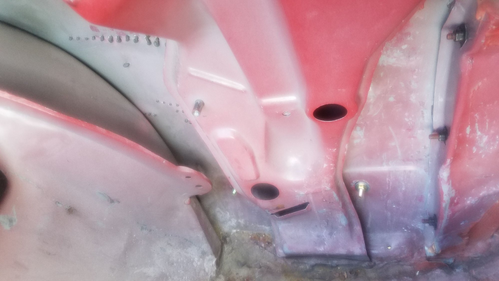

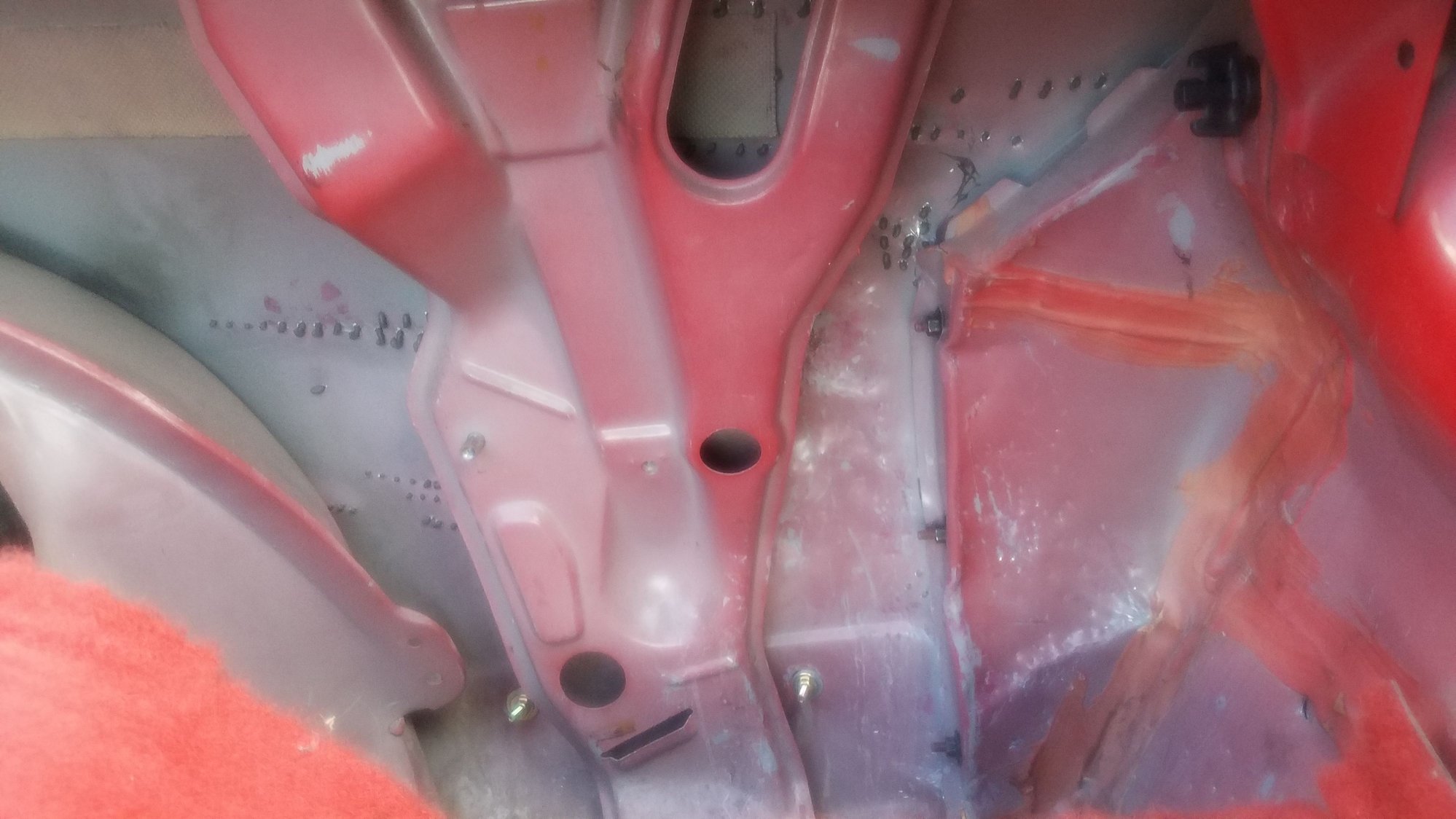

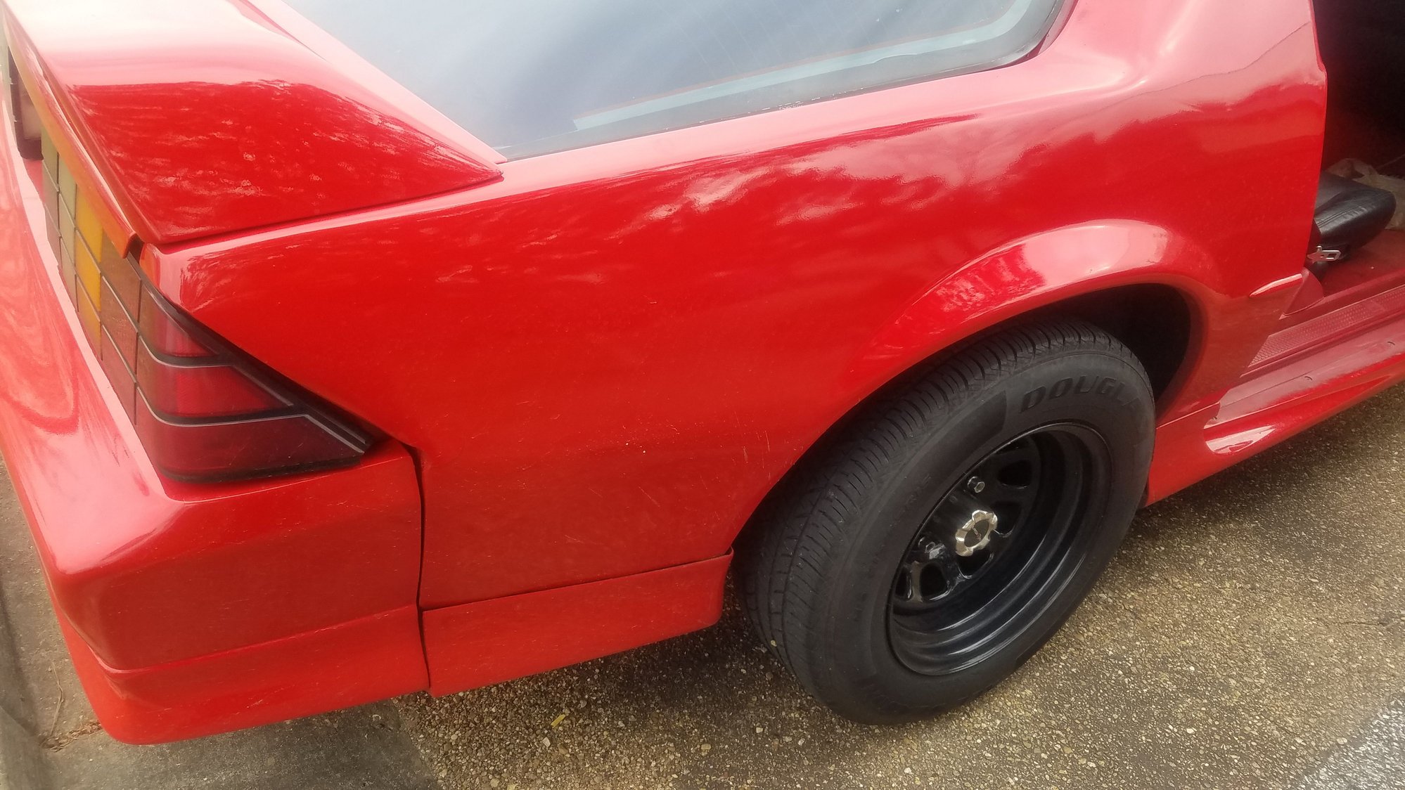

Here are some pictures of it now
the driver side you can only see the first tire groove and then barely see the second one then the passenger side you can see both perfectly

Hmmm...that is certainly sub-optimal.
Did he just add a skin over the old quarter? Not sure how you get a part so far "out".

Because these cars have such good access from the inside when the panels are out, a good tin man can make you believe it never happened....

I would lean to getting a full 1/4 panel from a donor, drill out the spot welds along the hatch and splice it in the sail panel/b-piller.
As a teenager I did a friends $500 caprice, with a roofing hammer, 2x4 scraps as bucking bars, a gallon (or two whos counting) of bondo and a case of fire engine red dupli color spray paint, it looked better than that. He drove it for like 5 years before he wrecked it and it held up pretty good except it dulled fast if you didn't keep it waxed.
How much did you pay to have it fixed? I would be asking for a refund.
One option if you don't have the funds or tools to fix it 100% right would be to take it to Macco or other cheap body shop to have the panel replaced, the welds ground down, and the pannel primed in with no filler, then take it to a good body man to finish it. (no one flame me I know I know... but it will be better than that)

I could be wrong... but that almost looks like he took a pannel off a firebird and then tried to cut the < shape into it to fit the camaro, if you look at the bumper line on my car, that 90 degree corner would explain why the corner of the tail light is so jacked up.

He just tried to pull it out gave up and bondo the whole thing I know I could fix it but I was just thinking what would be a better way to save money because I can find camaros rollers for 1k or even 2k online near me would it just be better to swap it over and start fresh to save money or just hold out and save

He didn't even weld studs to pull it. He made a bunch of holes.
