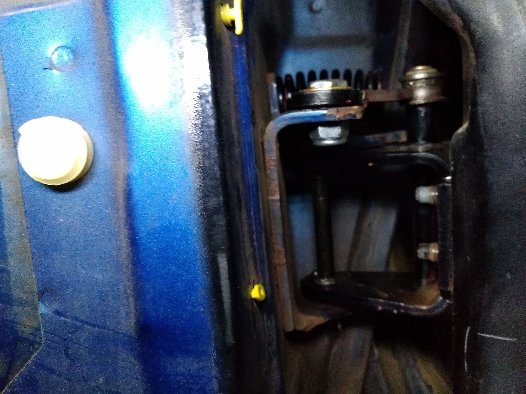

The door is now on the car, so this is the best I can do.

Cool. Looks like your detent roller is worn out too. It appears to be cocked in the picture

The roller is a PITA. The pin will come out with some heat and persuasion. Getting the new pin in is another exercise. Then you realize the top of the post is worn and the new roller/pin still don't keep the roller from tilting. LOL Next one I do, I'll be sure to square off the top of the post before pressing in the new pin. I'm fairly happy with how the roller and detent works now, but I went ahead and bought an NOS hinge just in case...
