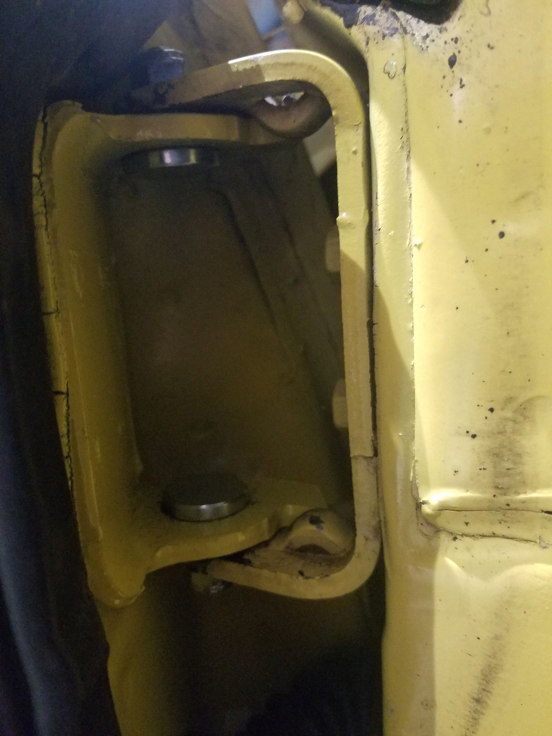

Completed my install today of new upper and lower bushing on my driver door. The door was fairly rough, it would drop down while opening. Determined the lower pin had popped up and could see a lot of movement on the lower jimge.
I used an air hammer to chisel off the edges of the pins in the upper hinge.
Tried to get a good shotnof my air hammer with chisel, definitely tough in a tight space.
I used a Dremel with a cutting disc to slice across the smaller part of the pin, then worked with with the chisel on the air hammer to slowly break it loose. As others have said, takes patience.

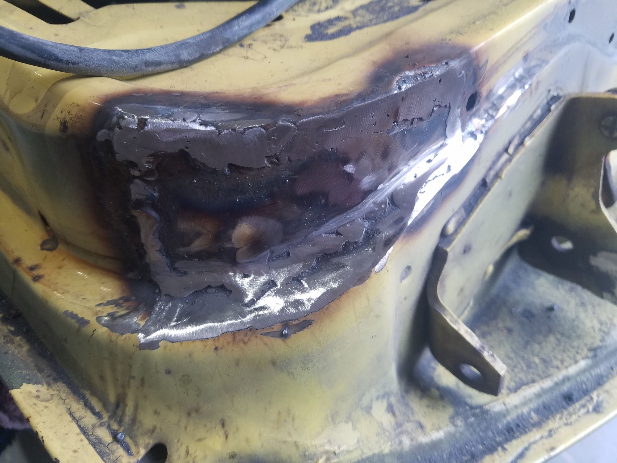

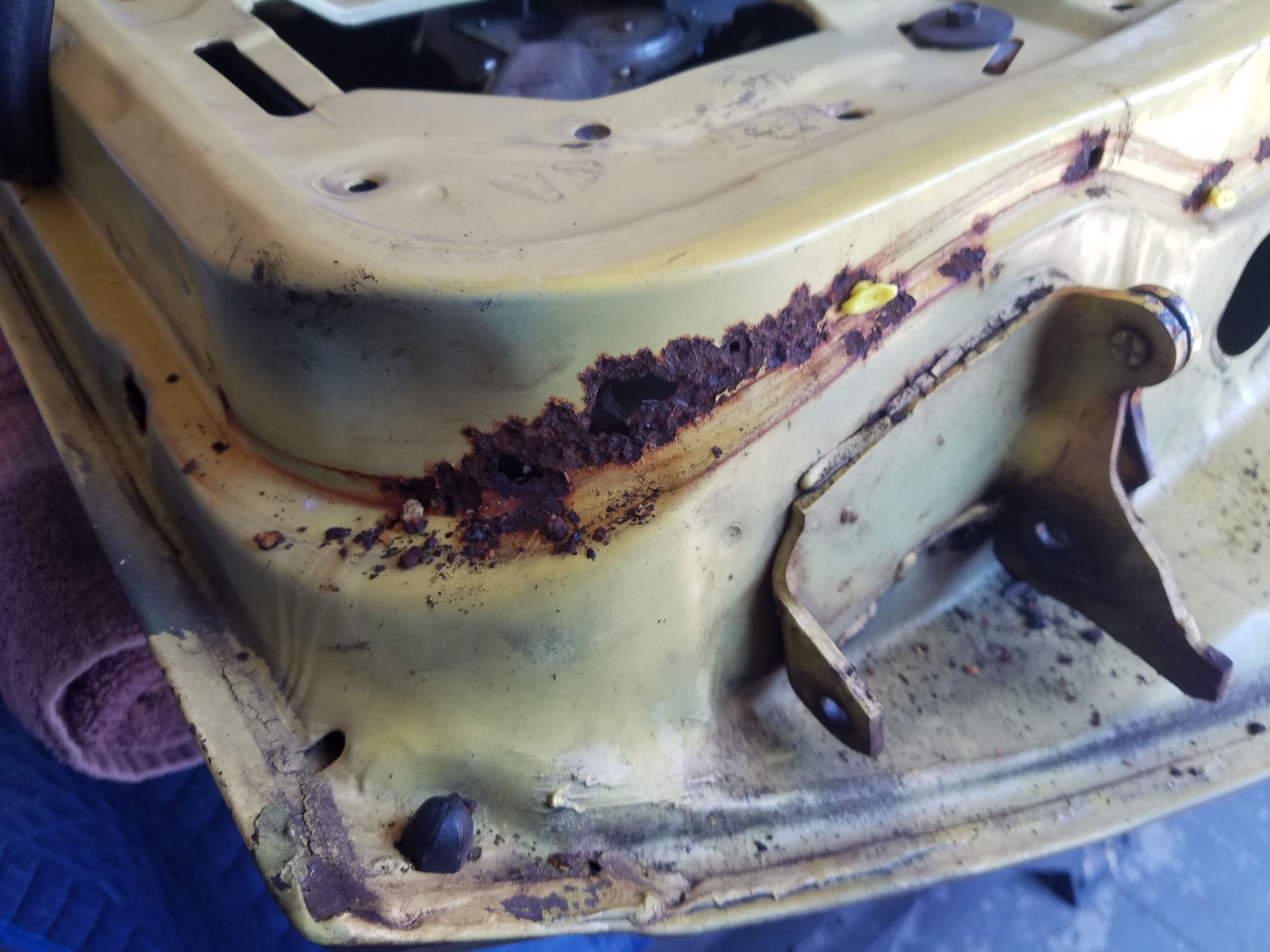

After breaking the upper hinge pins loose, the lower pin popped out WAY too easily. My pictures didn't show much, but after removing the door, I found both upper bushings cracked and chunks missing, and one of the lower bushing slid out without any pressure.

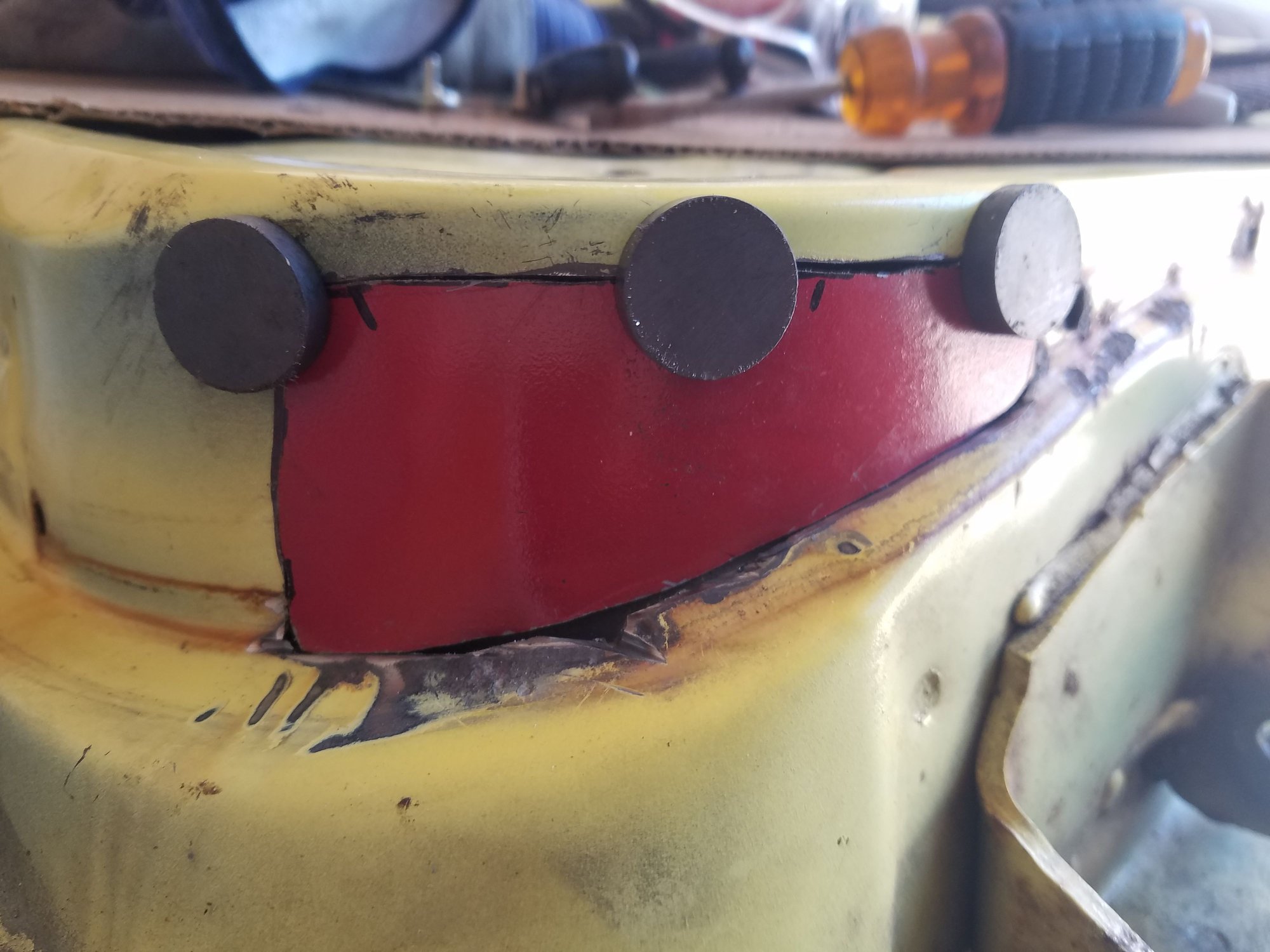

Aside from the trouble closing the door, the other reason I removed the door was to repair the o ly rust spot on the car. A rust hole had developed behind the weatherstripping on the front lower corner.
Odd spot for rust to form. I think water got trapped behind the weatherstripping.
Took quite a bit of work to cut out the rot, shape and weld in a patch, then finish off the repair.
Patch cut from sheet metal on the parts car. Shaped and formed to fit.
Patch welded in place. Took a friend of a friend kind of deal, but it turned out great!

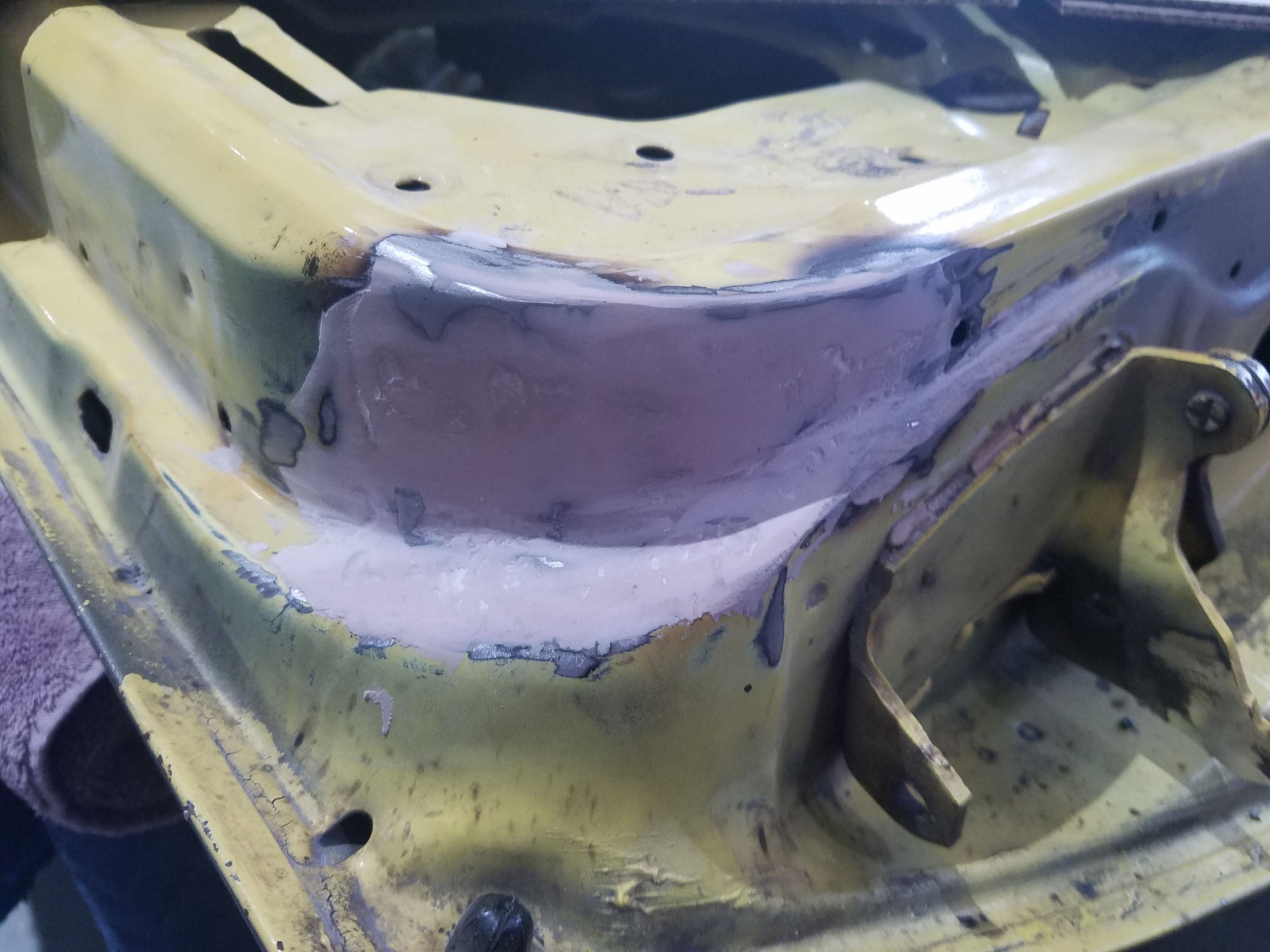

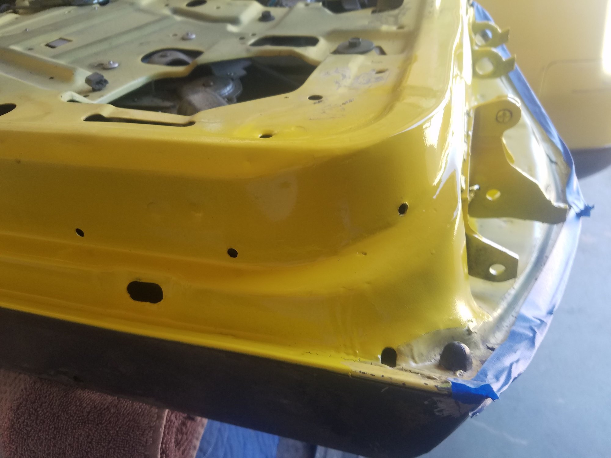

After getting a light skin of bondo and sanded down. Read6 for paint.
Finished repair. Drilled hole for weatherstripping and painted.

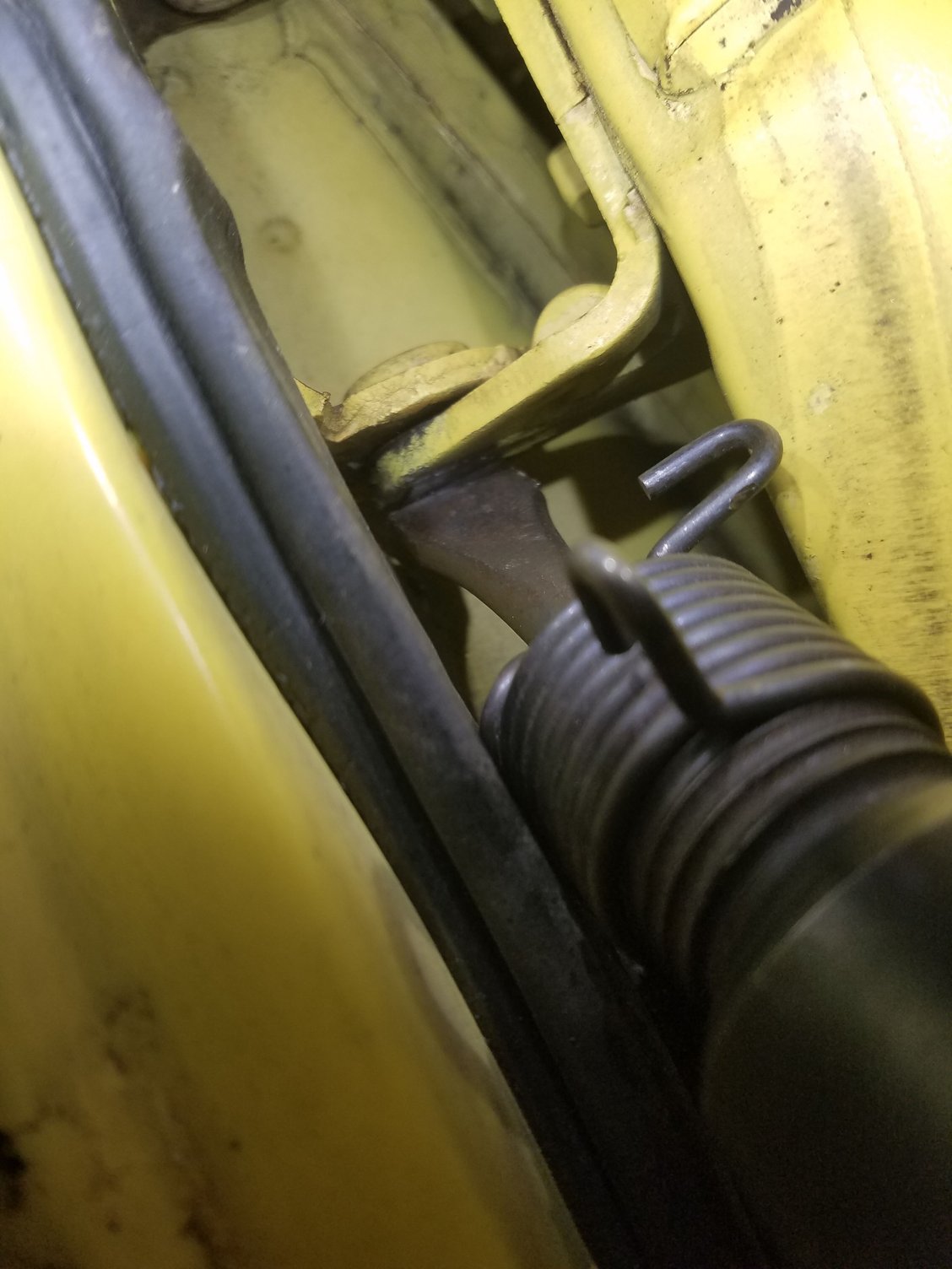

Installed the door today. Pics of the finished product:
Upper pins installwd
Lower pin in place
After installing the pins, the door closed better than I could have expected. VERY happy with the result!

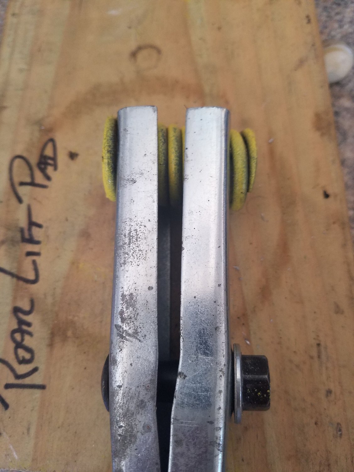

Told and parts I used.
I bought the GM spring compressor many years ago for working on an OBS truck. As much effort as it required to compress the spring enough to fit into its spot, I can't imagine getting the spring into place without the tool

I like how you used the magnets. That's a great idea!!!

Took the opportunity to do the passenger side as well. Had to do some more rust repair, not as ever as the weld in patch, just some small pinholes. Will wait a few days for the paint to cure then hang it too.
Few area where rust had formed. I ground away to clean metal and filled with JB Weld, primed and painted.

I can give you a tip when replacing the door detent spring using the door spring tool. When you've compressed the spring solid to remove it from the door hinge, open the door spring tool fully. Before removing the spring from the tool mark the orientation of the spring to the tool. Then remove the spring and reinsert the tool into the spring capturing one more coil. Now when you compress the spring solid to reinstall the spring it will go in easier. When you've fully opened the spring tool it won't want to come free of the spring. Simply use a large screwdriverto pry it free of the spring.
