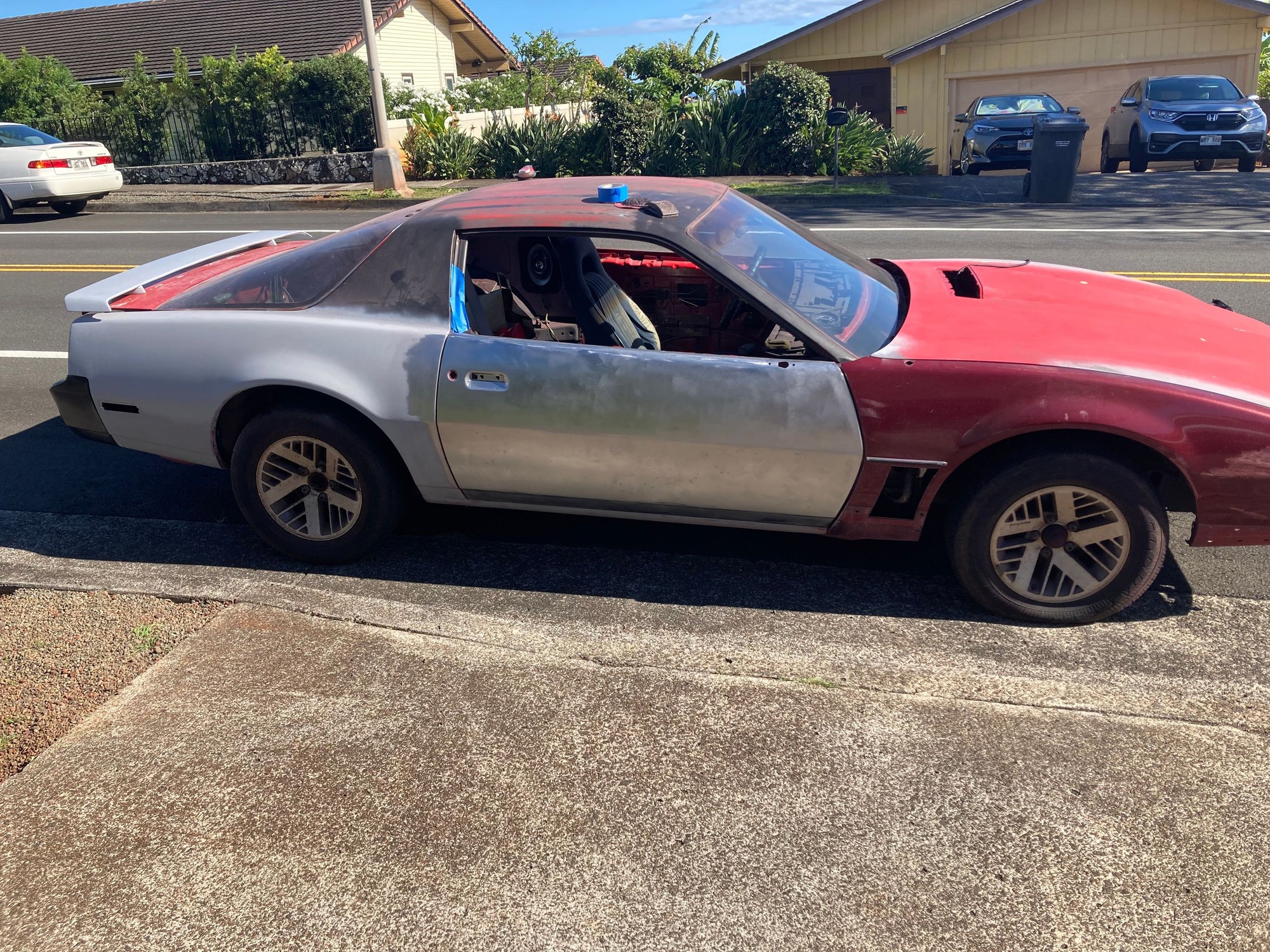

Mine is slightly more bare than yours lol
