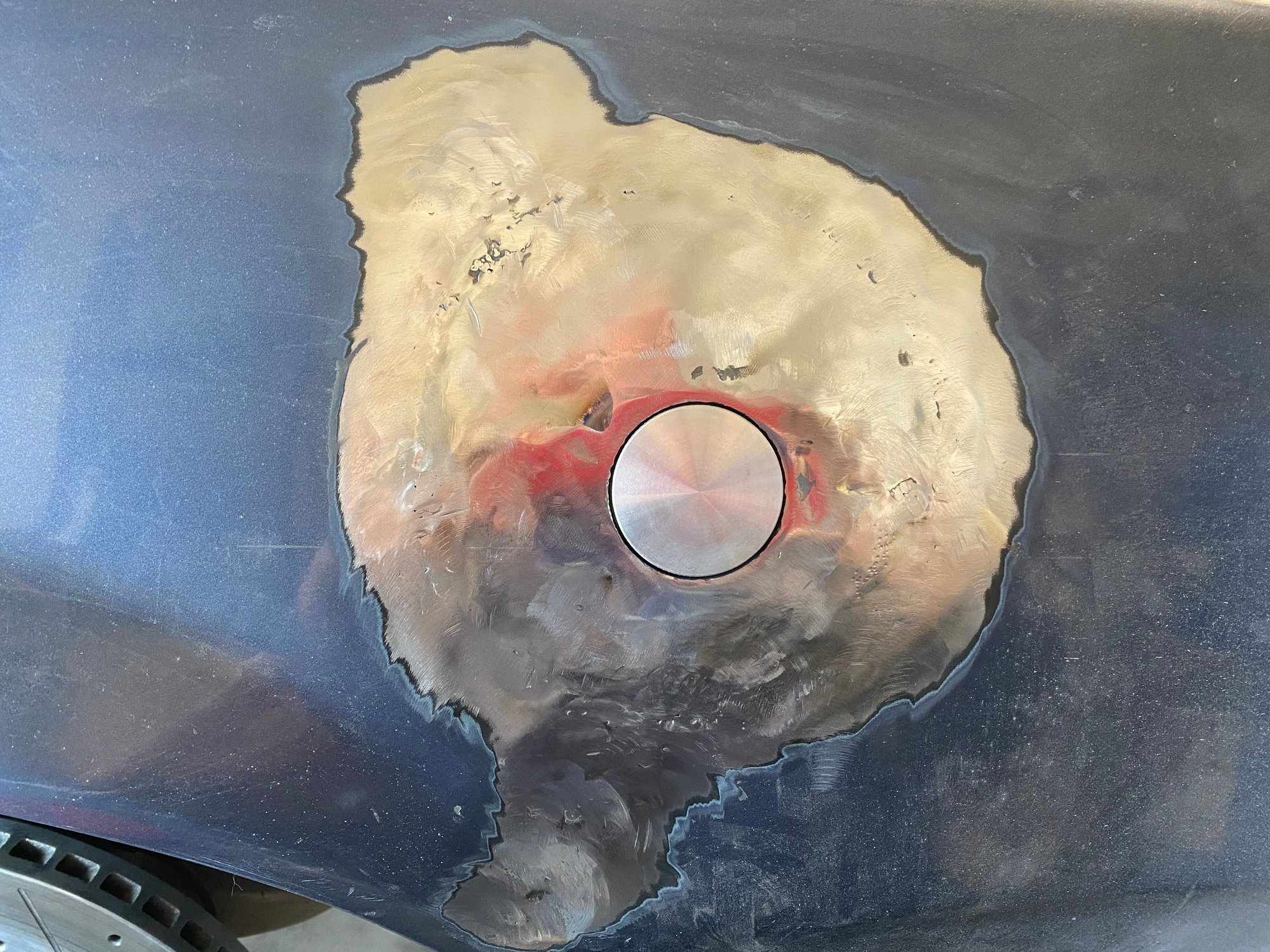

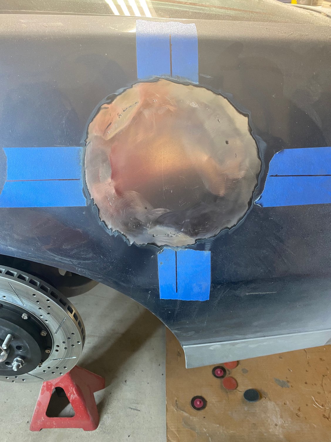

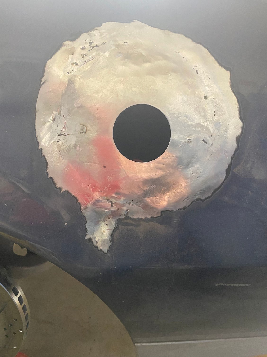

Flush gas cap

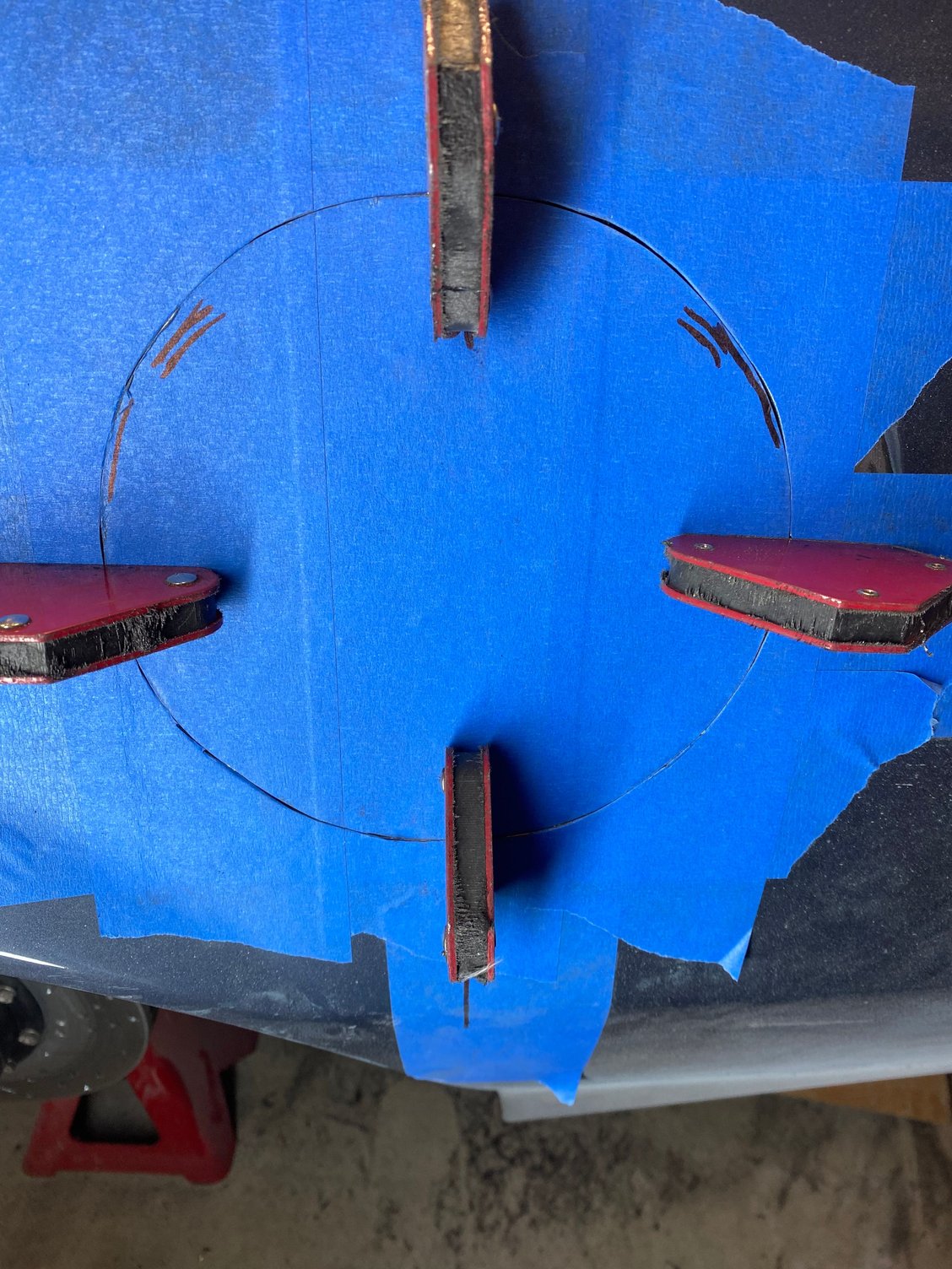

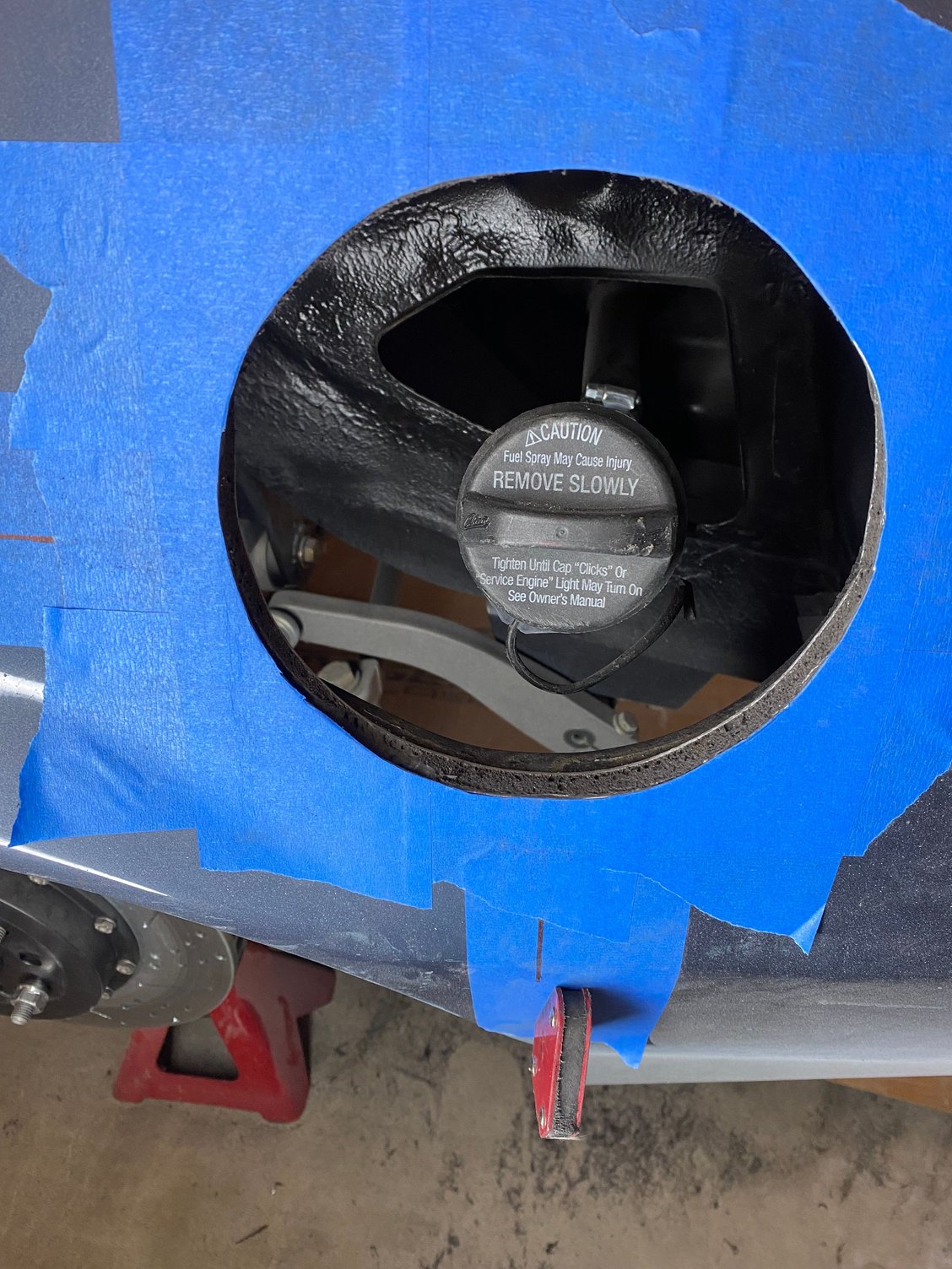

Cut the hinged door flange out

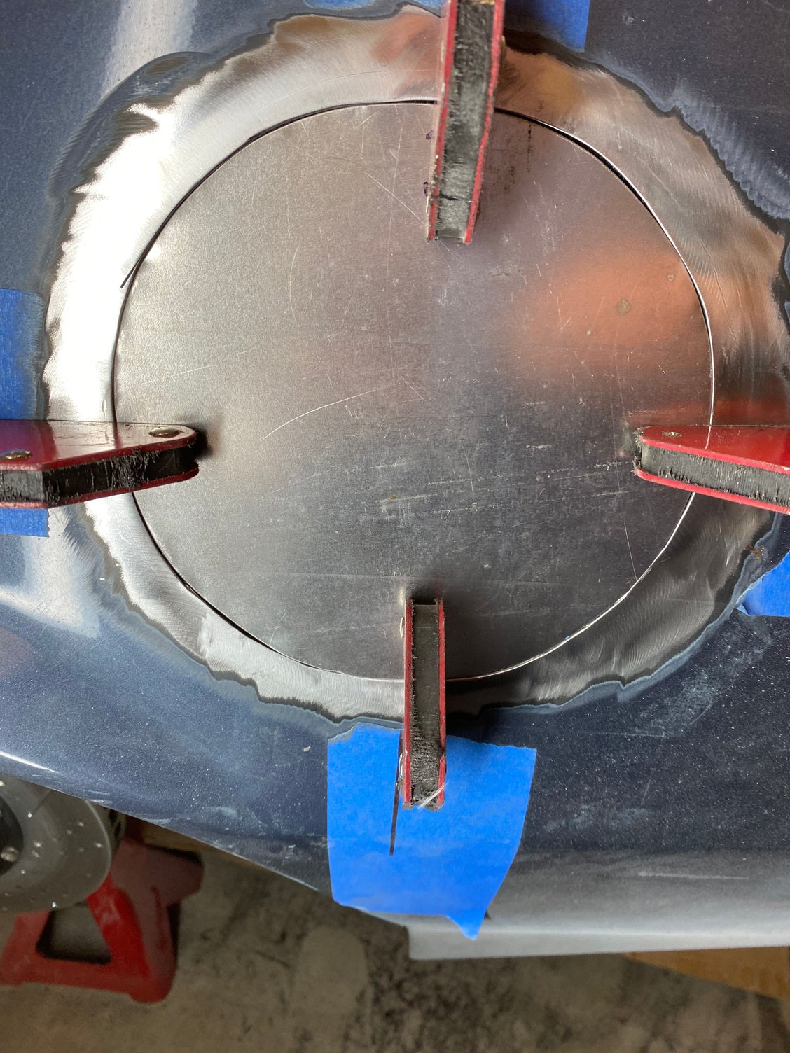

Made a template for the filler panel
Prepared for welding
TIG weld the panel

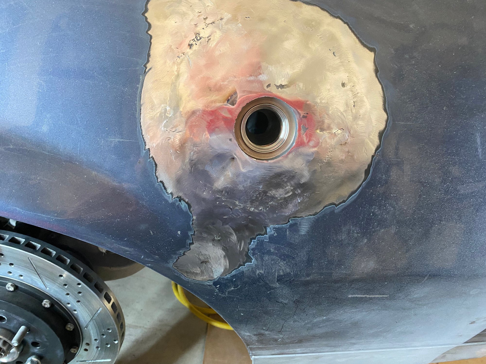

Cut the hole for the new cap flange
TIG weld the filler
All done. Needs body work and paint
I decided to put a flush mount gas cap on the car to match the flush door handles that I’m about to install.

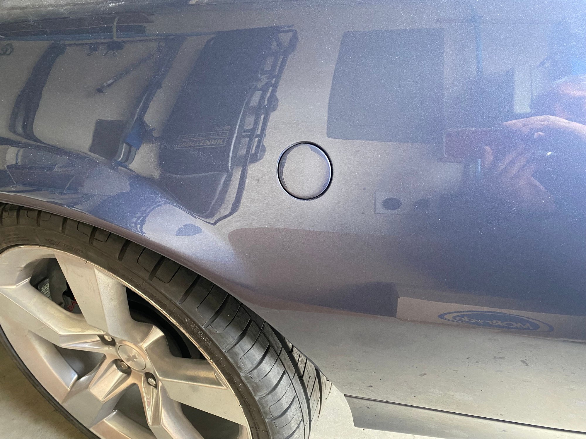

Final update to this thread. Car is painted and is being reassembled.

How does that open?

Originally Posted by battmann
How does that open?
Push it in and twist slightly counterclockwise and it pops out. Then it is like any other gas cap. It is a popular modification to motorcycle gas tanks.
