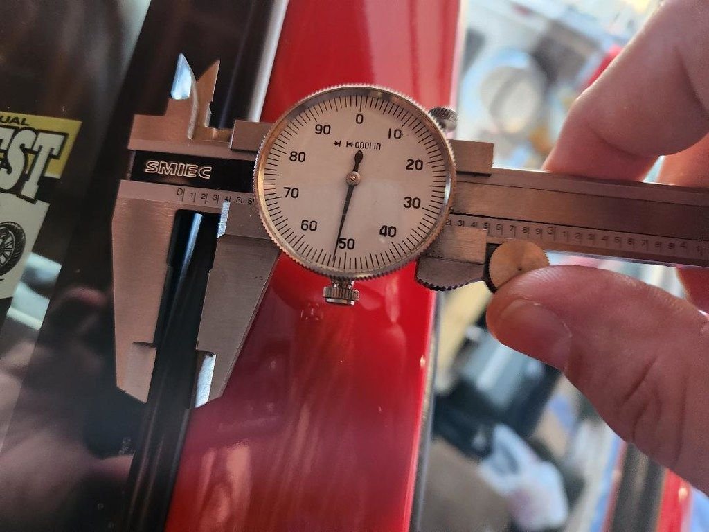

Factory width on my 88 IROC is 3/8".

Here's what I came up with. About .352"
...a hair under 23/64ths?

Just measured the one I got. The width is a hair under 1/2” (15/32”). Part number is WFS203 and made by Precision. Just bought it on Rockauto a few weeks ago. I paid more for shipping ($10) than the part ($5).
