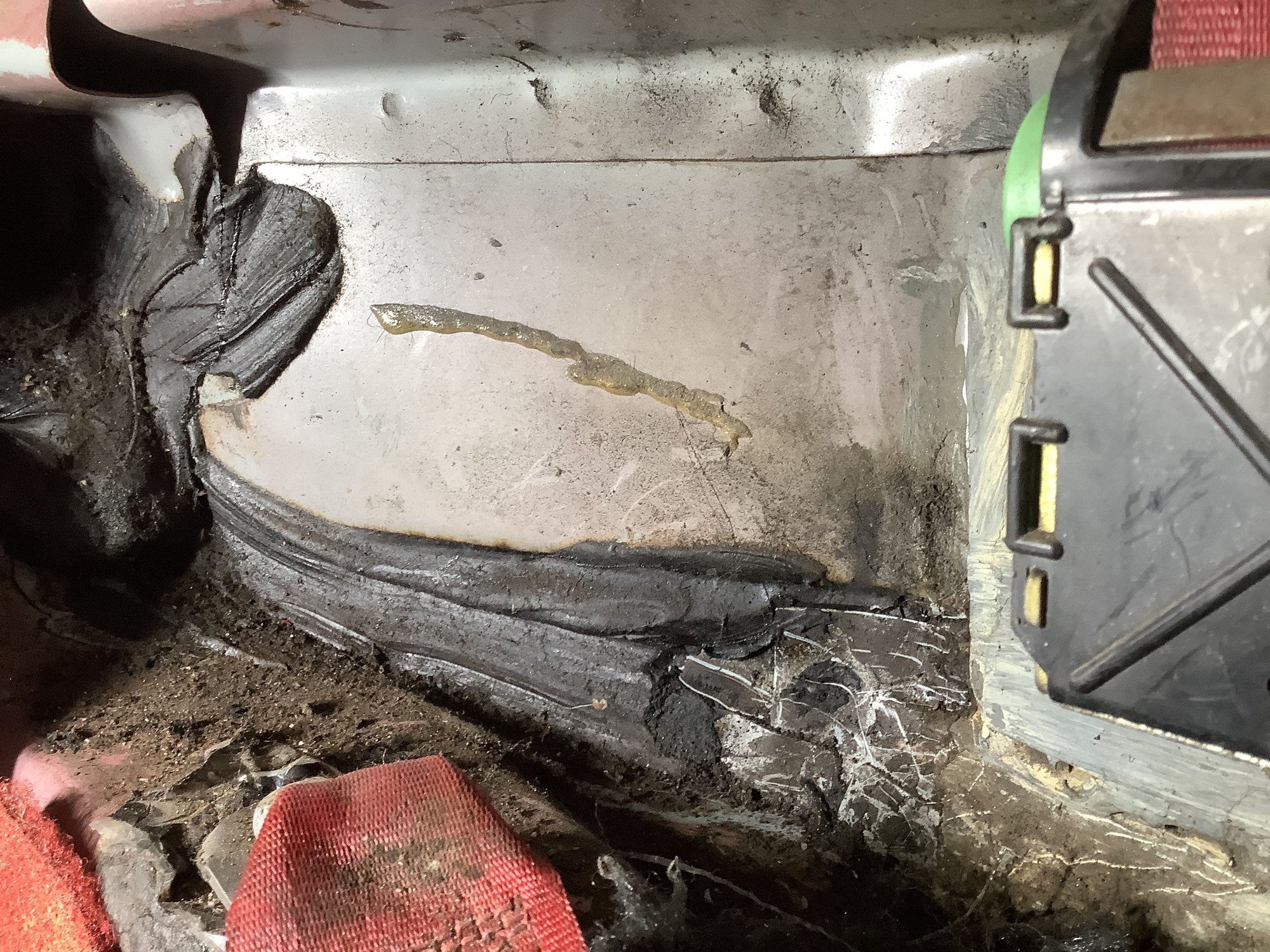

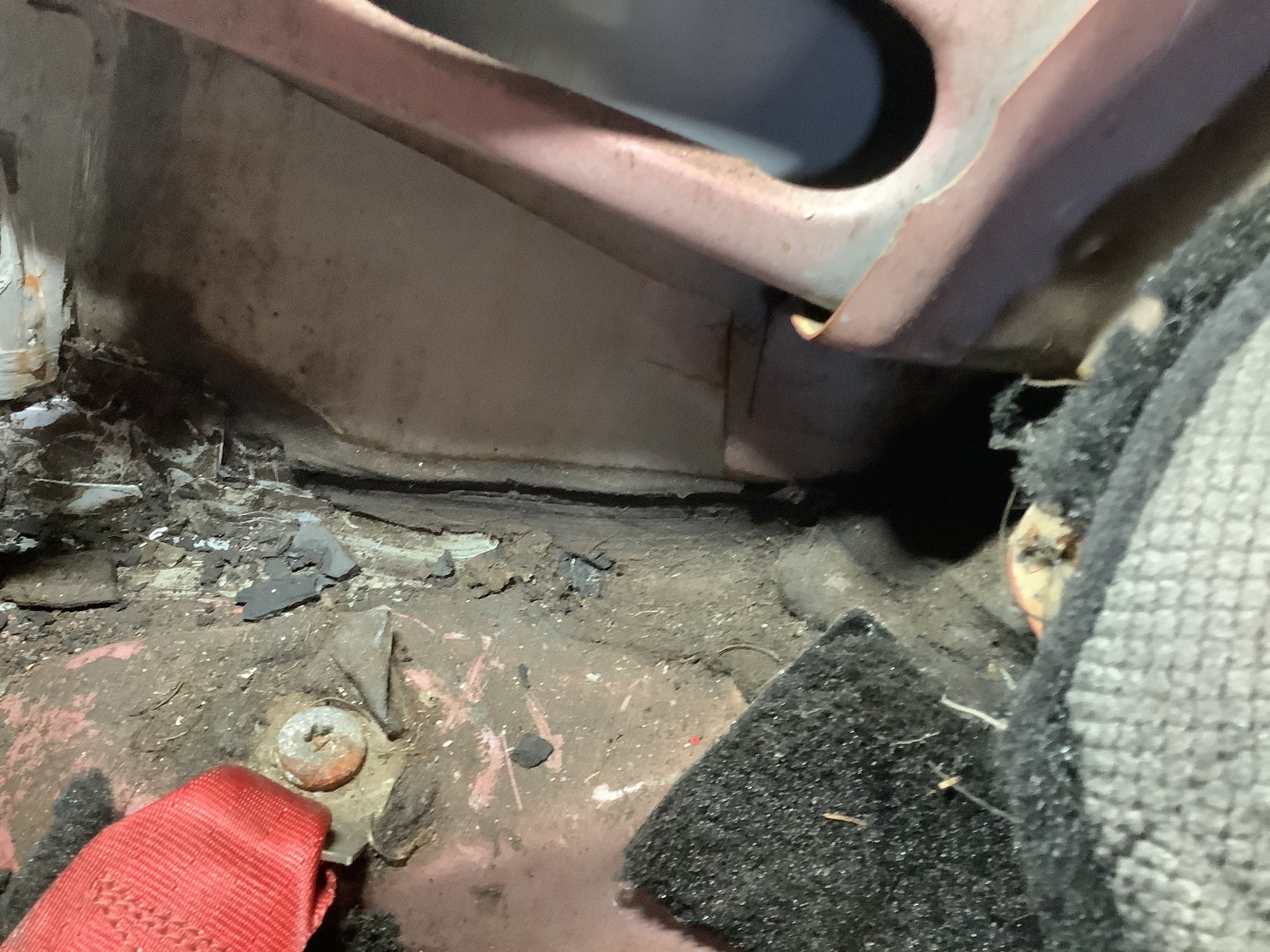

I am gonna attach photos, hopefully.

Anyone have an idea where the access holes might be, or where to drill? I hate to guess (calculate) and end up drilling more than 1 hole!

Re: Can't REACH 1989 IROC VERT elusive NUT at rear of ground effects rocker molding
On my friends 89 they are just next to the seat belt retractor. Sorta between that and the rear shock. Near the bottom right about the body sealer, but I remember them being not very well aligned with the nut/s at all. I had to use the flex wrench on one side because of the mis-alignment.
