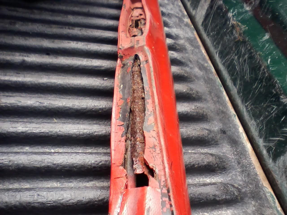

This one actually looked decent before we removed it to paint the car. The new fiberglass wing is so much better and a fraction the weight
That's a good point. Even if they look OK, this is typically how they will be underneath and inside and won't survive being removed.
It's one of those things where if it's on the car and looks OK, just leave it be. If there is reason to remove it, then trash it and get the fiberglass.
