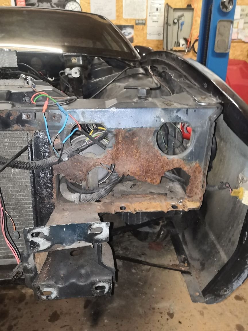

hi friends! I'm a brand new owner of a TA1982 from France (sorry for my bad English!) in order to build a K2000 replica. As I started to remove the front facia rusted, see picture below, I was wondering if this part was available in spare part?
front left
front left
Thanks for you reply

That's known as the Radiator Supporr..

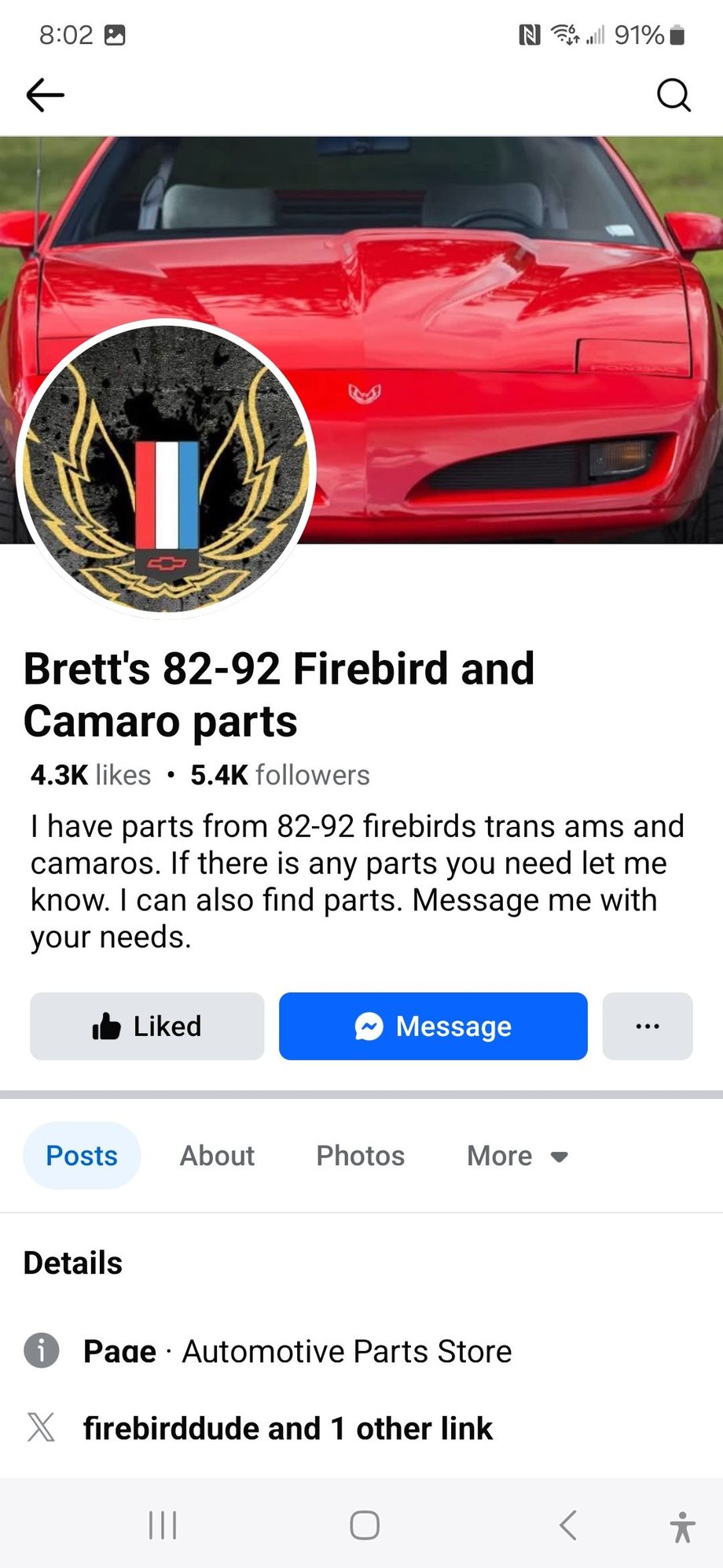

Send your picture and explanation to Brett via message. He has lots of parts, and hes legitimate. Ive purchased from him before.

Seems there are many "brett" in this forum. Do you have his username please?

@firebirddude142 That is his member name here at ThirdGen.org
Below is his thread where you can inquire about parts.
What do you need? I’ve parted over 40 cars...

This part is most commonly called the core support or radiator support. Used is going to be the only option for that. Will need to drill out all of the spot welds and plug weld in the replacement panel.
That's quite a bit of rust there and it's not a real common spot to rust through. Might be a specific reason for it, but how is the rest of the car (rockers, floors, wheelhouses, firewall, cowl, etc.)? Best to evaluate the whole thing before tearing into this rust repair.
^^^^THIS.
Seems very odd to me that there's so much rust on that one part of the car while there is no apparent rust anywhere else in that pic.

The battery sits right behind that, perhaps it suffered a bad battery leak at some time and the acid contributed to the rust/rot?
The battery is on the passenger side in 82-84 firebirds. Unless this car had a rt hand drive conversion and the moved the battery to the left Side.

Found a solution from my own. I'll make some metallic angles to be welded. this will cost few euros and not so hard to make it!
