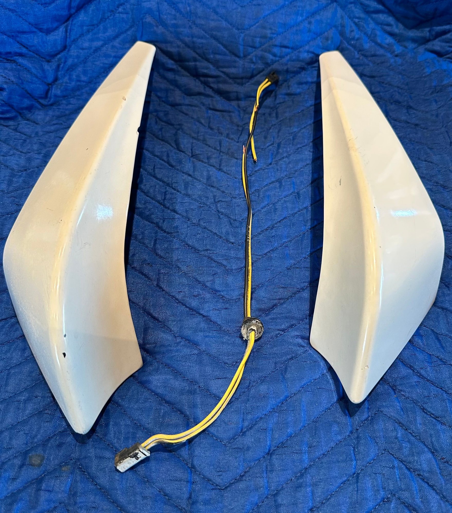

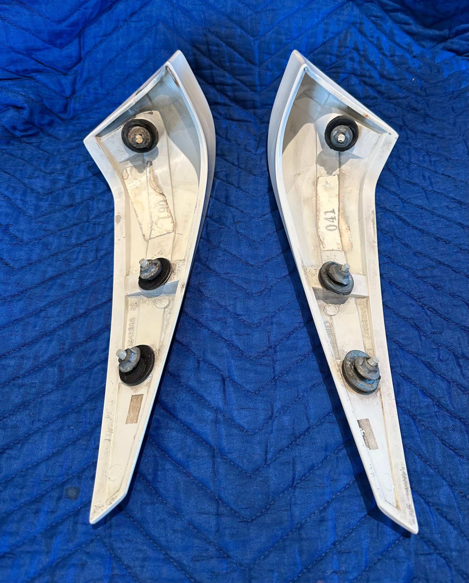

I've got these spoiler pieces from my white '88 basket case Iroc I had about 10 year's ago. Have the wiring harness too (portion from the decklid to the lamp)  but it would have to be repaired.

I would only need the left corner piece. I think I'm just going to fiberglass over the 3rd brake light area so I don't have to worry about the wiring.
