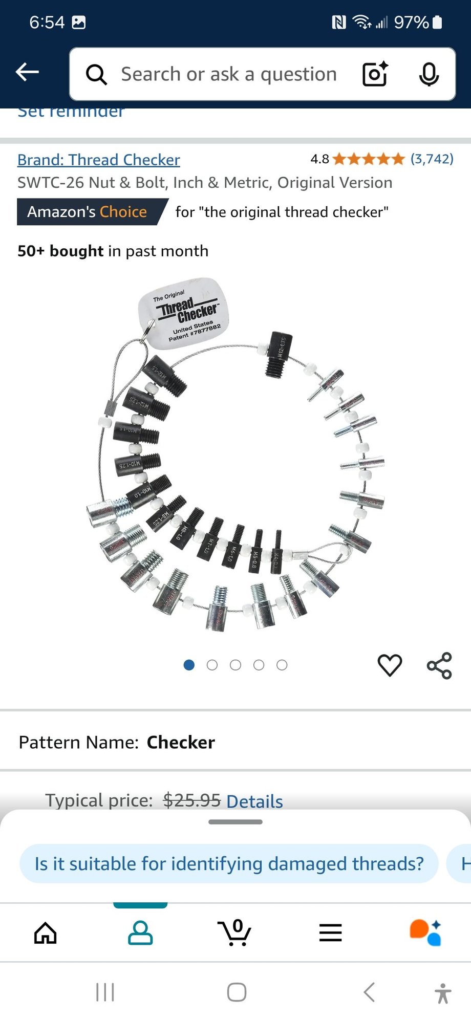

Get one of these. You won't have to ask anymore.

That doesn't do much good when you can't remove them to screw into the holes. I have some of these but on a plastic strip. I ended up getting an answer from a Facebook group. They are 6mm x 1.25.
