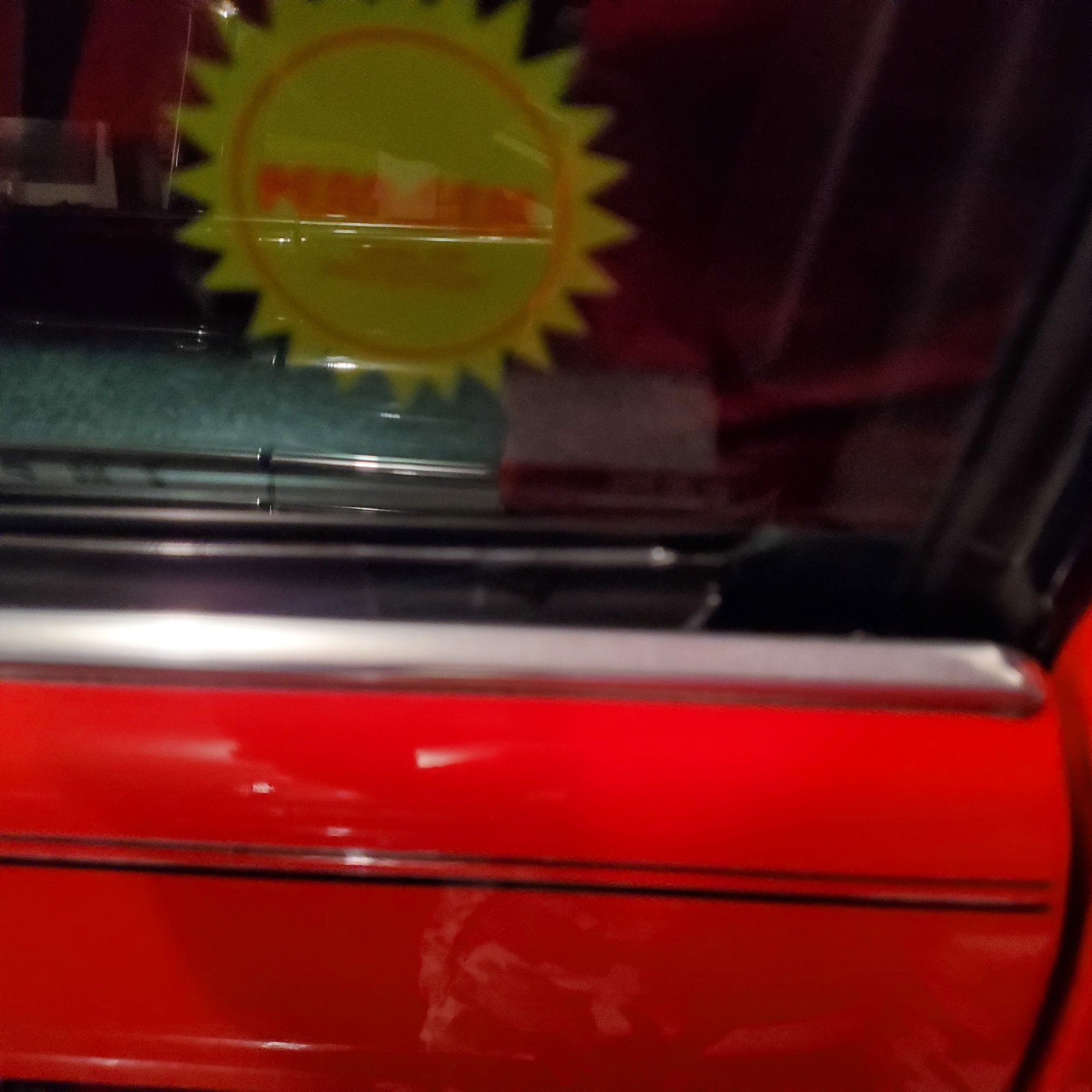

My one-owner 1985 Firebird needs the outside window sweeper moulding replaced. It is hardened and cracking, one 1' piece broke off on the drivers door.Q: What is the best place to buy new ones? Q2: Are they hard to pull and replace?
Thanks everyone!
I need the curved black trim behind the chrome edge.

A bit of a PITA to replace, but not rocket surgery. Window is somewhat in the way when removing the screws that hold it on. The triangle seal needs removing too, mark its place for re-installing.

Before u start removing the tiny screws and or reinstalling these screws, place a towel to catch the screws that fall off your screwdriver.
also, magnetize your screwdriver to hold onto the screws because it it a small space u have to work in.

Removing the door panel and moving those window stops a bit wil ldefinetley help!

Yes. Remove stops, lower window. But it took 2 days to re adjust glass on my sec Gen, new strips threw it on a bad angle
