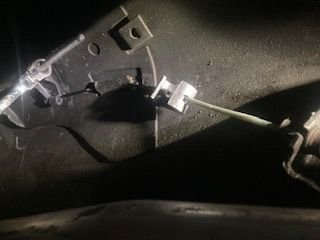

Old thread but the best (though confusing) I found regarding information for parking brake cables for LS1 conversion.
After reading this thread many times I gambled on Raybestos BC94264 and they fit perfect. Only need to make the brake end a bit bigger with a file and route the cables under the axles.
My car is a 1985 IROC with 4 disc brakes and have adjustable parking brake.
Here's a few pictures.
Adjustable parking brake
Left
Left
Right
Right
Result
