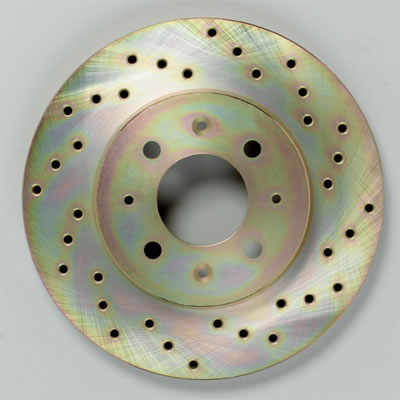

Or you could take this opportunity to slap on some nice HP rotors that are slotted and drilled:
More info HERE
Sure... you pay more for these rotors but they will last longer and will work a whole lot better than stock.
More info HERE

Thanks, the rotors are pretty much gone, so I will be replacing the rotors and pads, the calipers are still good from what I can tell.
Did that 1LE cars come only with the L98 motor, or did they also with the 305 TPI HO motor. And is the 1LE rotor size 12"?
Thanks for the link to summit, I think I will shy away from cross drilled rotors because they tend to crack with the cheaper rotors under extreme heat (or spirited driving) unless you get the high doller Porsche type or cyro'd rotors.
Atleast I have noticed this on all my friends 4th Gen's with cross drilled, and on my own 93 Z28 that I autocross. The slotted work great for me.

Look better yes but last longer...no. Drilled rotors are MORE susceptible to heating and therefore cracking around the holes since there's LESS metal in drilled rotors.
Ed

Originally posted by Cadillac
I respectfully disagree... but then again, it's a free country.
"I respectfully disagree".
You cant disagree with a fact.
Drilled rotors are more prone to cracking and excessive heating.
http://home.columbus.rr.com/trackbir...led_rotors.htm
Straight from StopTech's website...
DRILLED VS SLOTTED ROTORS
For many years most racing rotors were drilled. There were two reasons - the holes gave the "fireband" boundary layer of gasses and particulate matter someplace to go and the edges of the holes gave the pad a better "bite".
Unfortunately the drilled holes also reduced the thermal capacity of the discs and served as very effective "stress raisers" significantly decreasing disc life. Improvements in friction materials have pretty much made the drilled rotor a thing of the past in racing. Most racing rotors currently feature a series of tangential slots or channels that serve the same purpose without the attendant disadvantages.
