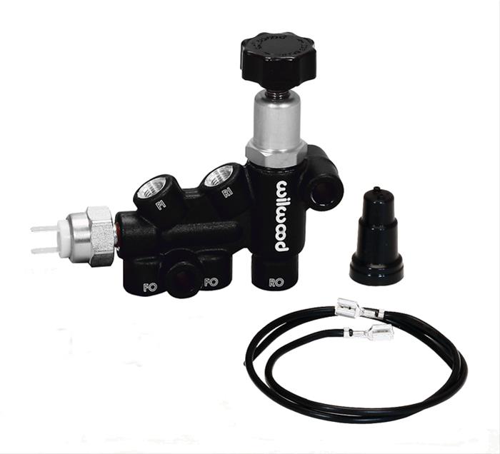

took 5 seconds to find this on the Summit site:
http://www.summitracing.com/parts/wi...1179/overview/

Nice thats a nice looking piece now would this be a direct bolt in or would i have to change the brake line fittings and flares i have all bubble flares my guess would he is that i would need adaptors to make it work

so I dont need the prop valve in the front lines? and just run that wilwood adjustable in the pic above in-line on the rear line? just making sure i understand this right?
Yes, the valve goes in the rear brake circuit.

you want full pressure to the front brakes, the adjustable valve cuts pressure to the rears to help deal with premature lockup as the weight shifts to the front of the car in a hard stop.
