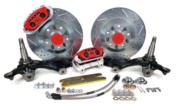

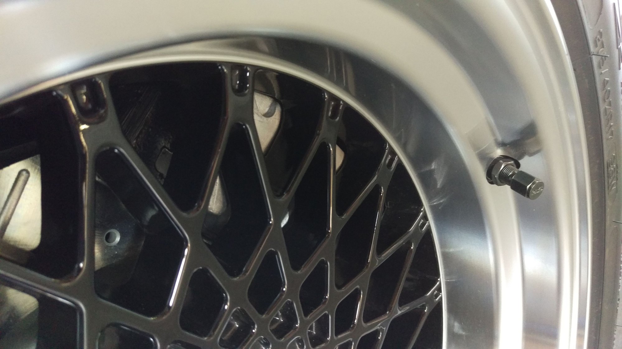

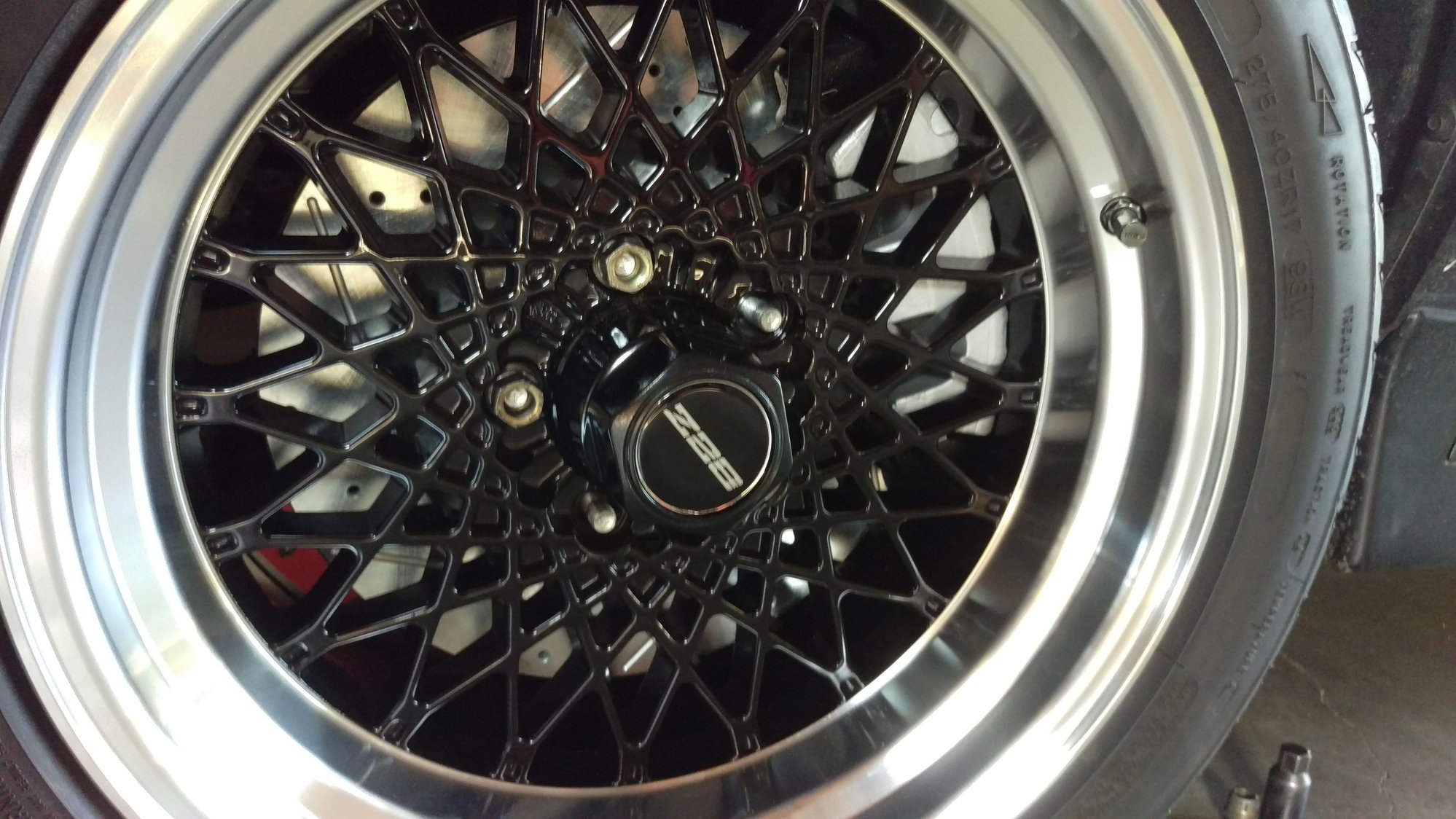

Couldn't find any post regarding fitment.So thought I would post mine.17" GTA hawk wheels with C6 vette 12.8 rotors.They fit, but barely.Had to file the "corvette" logo off the caliper & my wheel weights are hitting the caliper, but those are the only interference issues so far.Road test yet to come.
I'm using BBUs hubs/rotors & calipers/abutments/brackets I bought from a forum member.

That is the most disappointing brake clearance I've seen in a while...

Yeah, not thrilled with that either.Hopefully it works out well.

I wanted the z51 option, but w/ that 13.4 rotor, it would never work.
I did drive it today.No unfortunate sounds & i gained a bit more clearance.Guessing the pads weren't completely seated against the caliper.

Still looks like more clearance then the ronal firehawk rims I have. As the pads wear, the caliper will move inward more.

Yep, I was relieved when I realized that's the closest they would get, being those are new pads.

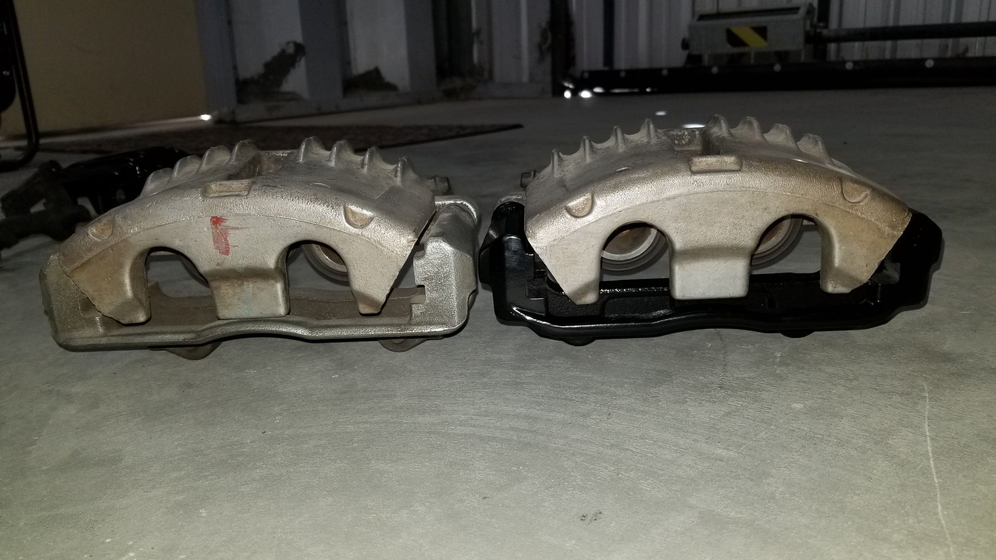

Nah, the spindles shouldn't have anything to do with it. But C5 and C6 brakes have the same fitment, and both type have raised letters on the face of the calipers, which apparently matters too, so that's likely why you needed spacers with C5 brakes.
LS1, C5 and C6 calipers are virtually interchangeable, so you might also need a spacer with 12" LS1 front brakes too.
*Edit: I had a comparison picture here, but I mistakenly posted the wrong calipers, so I've removed it and posted the correct pictures in post #24 below.*
Or you might not need a spacer. The LS1 rotor's hat is about 1/4" taller, which means it will sit about 1/4" deeper (farther back) than a C6 rotor. And with its bracket and caliper centered over that deeper rotor, that might give LS1 brakes (or your C5 calipers with the LS1 components) enough clearance without the spacer. If nobody else has tried it (and a couple of posts down somebody reported that he did it successfully), and if Hawk's hasn't test fit the combo, then it'll be trial and error for you.
On the other hand, according to Hawk's, that spacer is needed "for proper fitment on the front of the car." That might mean the spacer is necessary for tie rod clearance, so I'd suggest you ask Hawk's. Tie rod clearance is why factory 16" front wheels have about 5/8" less offset than the rear wheels (zero vs 16mm), so you might not have a choice but to use that supplied 1/4" spacer, regardless of the brake package. But if you've got tie rod clearance without the spacer, then LS1 might work without the spacer. And if you do need it for tie rod clearance, then, at least, you should have very good clearance with LS1 brakes.
And 12" LS1 rotors and calipers wouldn't interfere with the wheel weights in the barrel of the wheel.

Arent those the rear calipers though. I assumed ( you know how that goes) he only had issues with the front wheels since he mentioned 1LE "spindles". I think thats why hawks supplies 2 spacers only. Ive no issues on the back wheels.
As for the weights, the tech just moved them closer to the edge of the wheel. Again, only on the front.
91formula, are you using a standard (non 1le rotor/hub)? The 1LE rotors have a taller hat than standard rotors. This taller hat moves the wheel out another 1/4 at least. Combined w/ the 1/4 spacer this gives you the needed clearance, but only by about 1/8.

Oops, lol, yes, those are rears. I scrolled through a bazillion pictures on my laptop, and it took a long time to find that one. I transfer from my phone to my laptop and upload from my laptop, so the fronts must still be on my phone, which has a bazillion more pictures. Pretty sure I clicked some before I sold the LS1 calipers, so I'll look. But the fronts are interchangeable too. When I was test fitting C6 Z51 brakes, I mocked them up with both calipers. Sorry 'bout that lol.

Found 'em on my phone. Here are two pictures comparing the C6 front caliper to the LS1 front caliper; pictures I meant for the previous post. One is a side-by-side comparison of the two. The other shows an LS1 caliper in a C6 base/standard (not Z51) abutment bracket, for people who might want to use (or already have) the cheaper and easier to find LS1 calipers with C5 or C6 brake upgrades. I apparently didn't take a pic of a C6 caliper in an LS1 abutment bracket, but it fits and so will a C5 caliper, for people who might want those better and stronger calipers with an LS1 brake upgrade. Pretty sure most people don't mix-n-match though, but there it is.

I'm using the exact same hubs, just with std C6 brakes. So there's probably a difference in the rotor. Placing the caliper farther back.
Or does the stronger C5/6 caliper not clear maybe because its thicker than the ls1 part? What makes those C5/6 calipers better/stronger, i guess is what I'm asking?
The manufacturing process changed. 1-piston and 2-piston aluminum calipers for 3rdgen, C4, LT1, LS1, C5 and C6 are from PBR. C6 calipers are pressure cast, which makes them denser and stronger. Prior to C6, the calipers were gravity cast, which was always sufficient but can leave inconsistencies in density and strength.
LS1 calipers were good for 12" brakes (and probably fine for larger brakes under normal duty, but under extreme duty, probably too, but you never know). C5 calipers were fully ribbed to make them more rigid to handle its larger brakes. But then C6 Z51 (Heavy Duty) brakes got even larger, so the manufacturing process was changed to make the C6 calipers stronger, not larger, just stronger.

Ah! pressure casting. Reminds me of back in the day when manufacturers started making sport bike frames that way vs the old gravity cast method. Didn't know that about the calipers. Learned something new.

Wouldn't this work on your 1991 Formula and fit under Hawks 17x9 GTA style wheels?
Isn't this more or less the C4 J55 13" HD PBR front disc brake conversion for 3rd gens except using the Baer branded PBR front calipers?
This kit uses a more robust/rigid high pressure cast caliper, similar to the ones found on the 96 Grand Sport & Collector's Edition C4 Corvettes rather than the earlier finned type gravity cast 1LE caliper.
Baer Brakes 4301678R Baer Brakes 13" Classic Series Front Brake Kit
MSRP $1,406.95
On sale for $1,123.95
Seems like a reasonable price for the massive upgrade it would be over the stock junk.

I'm not sure if that will fit behind my wheels or not. I was hoping to salvage the C5/6 Kit i have. Looks like I will be ordering some 1LE rotors, and have them machined down to make hubs.

Originally Posted by Airwolfe
Wouldn't this work on your 1991 Formula and fit under Hawks 17x9 GTA style wheels?.
if it would fit, then im buying it..
but need a definite yes or no on it

Did you check the fitment template against your Hawks 17x9 GTA style wheels?

If that kit is anything like the C6 Z51 kit, probably not.
