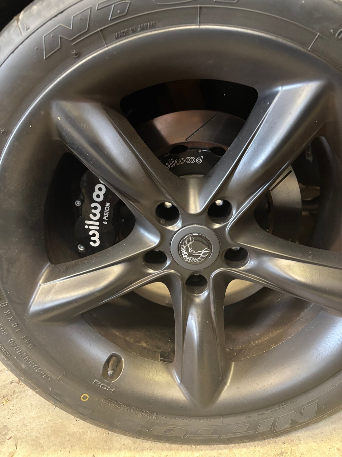

Originally Posted by rs_gera
I went with the 5th gen brembos as stated above. Great stopping power and they look great.
Nice Set Up What kind of Brakes are those on the Bottom left they don’t look like 5th gen brembos they look different

Do any of you guys have Wilwood Brakes
If I wanted to use those calipers is it the same as any other Big brake upgrade by getting the spindles brackets and pads and stuff
Old Mar 22, 2019 | 08:13 PM
LAFireboyd's Avatar
Joined: Jan 2004
Posts: 2,963
Likes: 377
From: Las Vegas
Axle/Gears: 9-bolt/3.45
Re: Which Brake upgrade to buy?
Contact Scott at bigbrakeupgrade@gmail.com and tell him what you would like to do. He has brake upgrades that work with Wilwood calipers, Z06 calipers, Brembo, C5/C6, and he can help you outline what you might want.

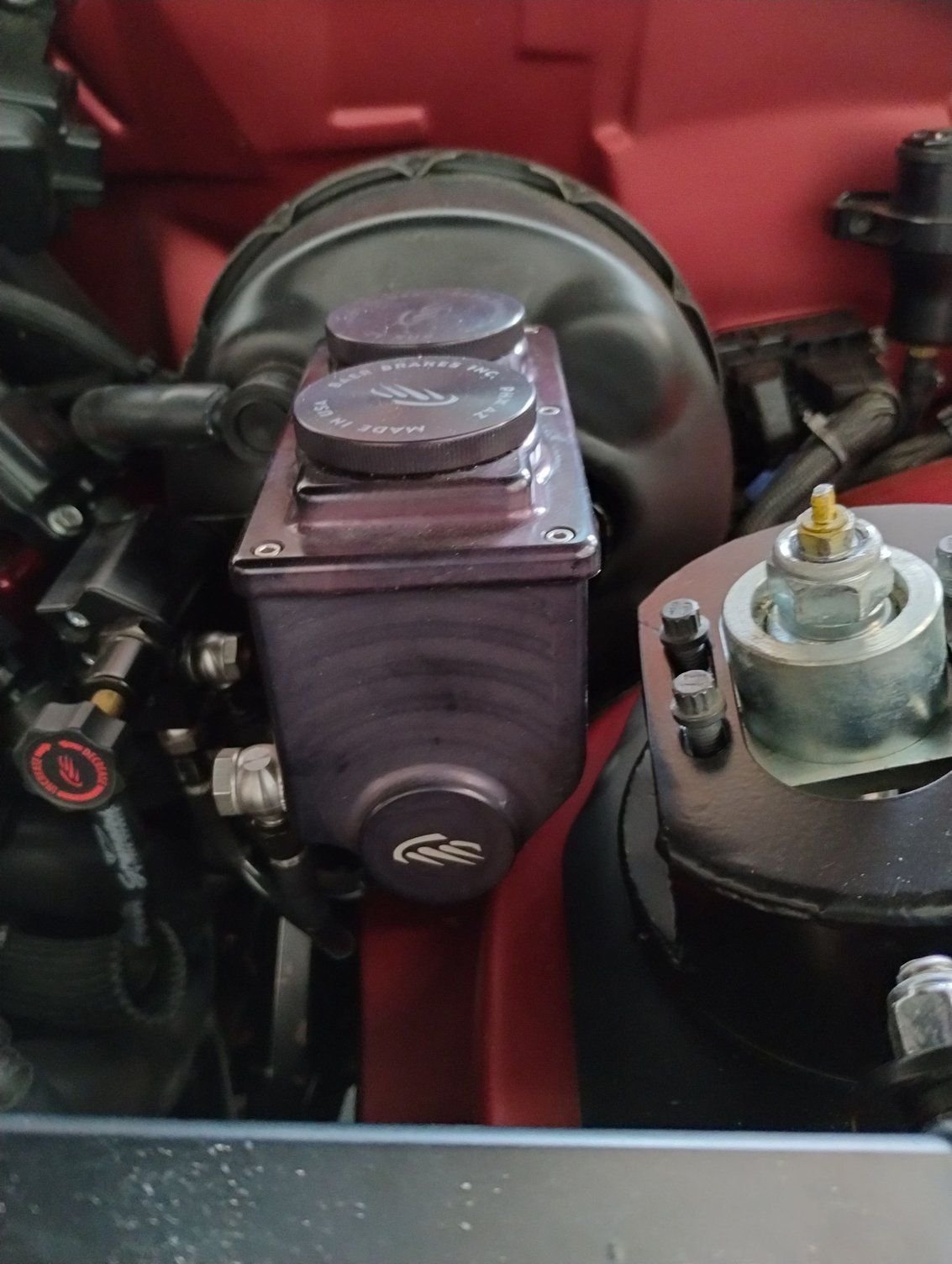

Finally installed the brakes. I haven't tested, yet, as I still need to bleed the brakes and put diff back together (spider gears walked out of place).

which 'big brakes' fit the 17" hawks GTA reproduction wheels?
staying 17", not going any bigger
Can't speak to the repos, but I have no problems with the wildwood dynalites inside my original ROH 17x8 Snypers.

Wilwood 13 inch/12 inch rear. I used a kore3 setup w their aluminum hubs. They fit in 17x9 roh RTs and stop awesome.
