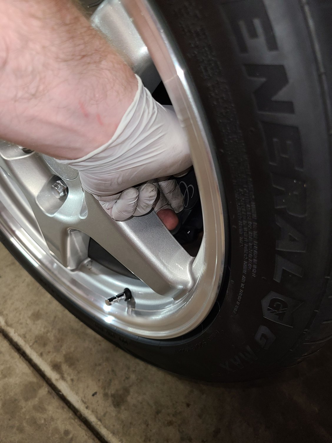

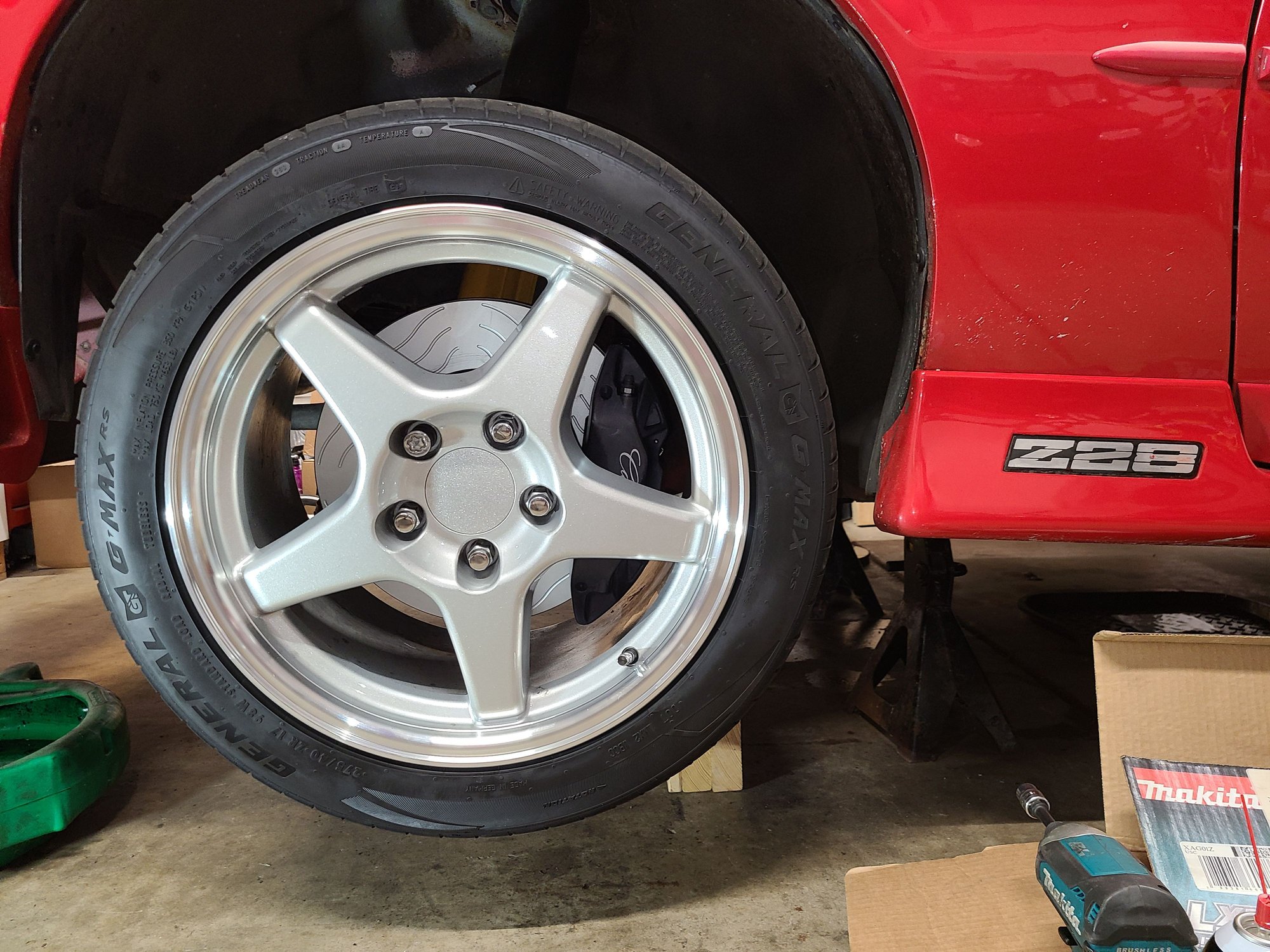

Hear is a sneak preview, the wheel is only on as a mock up, haven't actually torqued or hooked up the calipers yet...

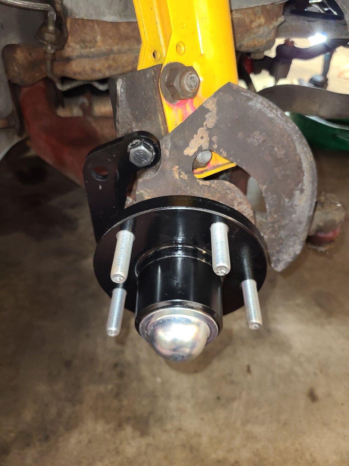

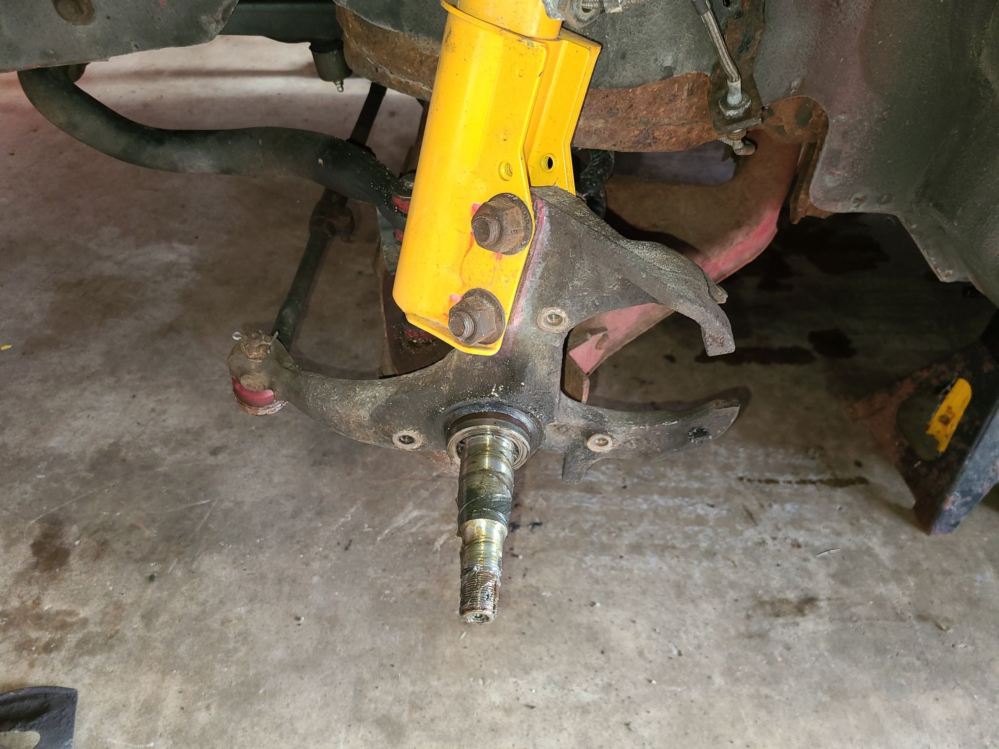

So for some finings, tips, and questions: (Sorry if this gets long winded... read it... look at the pictures... skip over it... If it even helps one person in the future it will be worth my word vomit, lol! Also, I am not a professional, Just been working on my car, for the last 20 years, and I am a design engineer professionally, so I cant help the way my brain works...)
As may be evident, I don't think I took any unreasonable shortcuts, but I did make the conversion as simple as I could. With this in mind, I did complete it with the the steering/suspension fully assembled. This means I did not remove the spindles and do all cutting, grinding, drilling and tapping on a bench, vice, or drill press. I understood there was some risk, and if you attempt, you should consider the same risk! That said, I think it worked out pretty well this way. I bought Cobalt drill bits for all the final hole diameters to get as clean of a bore as I could, and to minimize of snapping a bit off anywhere. I did use a cutting lube intended for ferric metals on the drill bit, tap and in the hole. I admit, for some reason the drill bits were grabbing pretty badly on the first side I did, so I would frequently stop, reverse to clear any chips, and carefully try again for a little more depth. On the second side, I think I figured out the level of pressure so it wouldn't grab, and it turned out to be VERY LITTLE, you really had to be gentle with the drill bit. It didn't seem like it was cutting at first, but then chips started coming out of the hole. I also took a smaller drill bit wrapped it in a little masking tape and stuck it in the last shield hole, so I could use that and the spindle to have visual reverence for the direction my drill bit had to be in.
As tar as I tore things down:
The tap I used I believe was a pipe tap style which means it had a medium taper. For the blind hole at the top, I drilled the hole to a depth of 1.10" before going back and tapping it only about 2-3 mm more than I had to. I cannot screw a screw in flush without the bracket in place, but that's ok. Make sure you really clean out and blow out all the holes of chips before you run any fasteners in, I used brake clean and compressed air. I tried running in one screw before this, and the threads got a little funkey, not terrible, but I learned from my mistake! I tapped with a proper two sided tap holder only going a quarter turn at a time until I was in about 4-6 full threads, then I started going 3/4 of a turn at a time using an adjustable wrench. Again because I did it in place, I had a little less space to work with, but it was not terrible.
I wasn't sure of the amount of spindle that really needs to be cut away. I've seen all the pictures, but again doing it in place, I didn't want to have to remove the strut bolts and cause myself to need an alignment. Turns out the top wing doesn't have to be cut back far at all. I fond a thin point on it and cut parallel to the strut bolts, then cleaned it up with an angle grinder. I used a full length 18 (I think) TPI blade for this. For the bottom wing, a simple vertical cut within 1-2mm of the mounting lug seemed to be enough, I rounded it a little bit which gave a little additional clearance. The tricky cut was the steering stop. You basically need to cut almost as high as you can. You also need to cut down your Sawzall Blade so that it does not contact the steering stop. Even at full opposite lock, I needed to cut about 1.5-2" off. ALSO, AND MOST IMPORTANTLY, only cut with your Sawzall on the steering stop in the direction from the front of the vehicle, to the rear!!! I had that in mind at first, but needed to take a little more off, and stupidly ignored my own warning. I didn't lighten up my pressure enough at the end of the cut and I nicked the boot on my ball joint! Now I need to figure out how to replace that, and I'm pissed, save yourself the frustration... only cut away from it. Any tips on changing the boot? I bought another ball joint, but I don't think I damaged the joint itself, can I use a pickle fork to separate it and just put the boot from the new one on the old one, put it back together, and re-grease it? Once everything is cut, test fit everything. I also took a socket for the bottom caliper bolt, put the bolt through the hole, pulled it and pushed it up as high as it would go, and found I could not fit the socket in there, so I used the angle grinder to relieve the bottom a little more until I could fit the socket with a little clearance. I shielded the spindle itself, and hit the cut surfaces with a little black spray paint.
So I have read how many people just do not replace the shield, others modify it cutting away everything except the hub grease guard at the center. Looking at it, I thought it looked like the design was also intended to scoop more air towards the rotor to improve brake cooling, so I experimented with various designs, cutting a little away at a time, until it fit, but I felt it could still fulfill some of its original purpose. I understand it is much smaller than the new rotor, but I don't think it can hurt anything, and should help pull a little extra air into the center of the rotor, which is the intake for the cooling veins. Since the piece was a little larger that just the center grease catch, I bent it slightly to give it tension against the spindle when tightened. I also cleaned and treated the rubber rings behind it with some rubber cleaner and conditioner. I then centered it and zipped the one screw back in with some blue Loctite.
Thoughts? Well see if it gives me any trouble.
I was worried about cutting off the steering stops, and having to come up with a solution to make up for it, but it turns out on my specific car, the steering stop on the A-Arm is tall enough that even after cutting off the leg on the bottom of the spindle, it still contacts it well enough, and it contacts inside of where the caliper mounting bolt is so there is no interference, or contact on anything I don't want there to be! So nice when something just goes your way isn't it???
I take LOTS of pictures as I work thought projects so if there is anything in particular you want to see, ask!
About an inch of spoke clearance with my wheels and 2\" spacers
Tonight I hope to hook up the new stainless hoses and torque the calipers, but it is supposed to be about 100 deg F this afternoon in the Chicagoland area, so, we'll see how much I want to sweat. I do have an autocross even Saturday, so I has to get done!!!

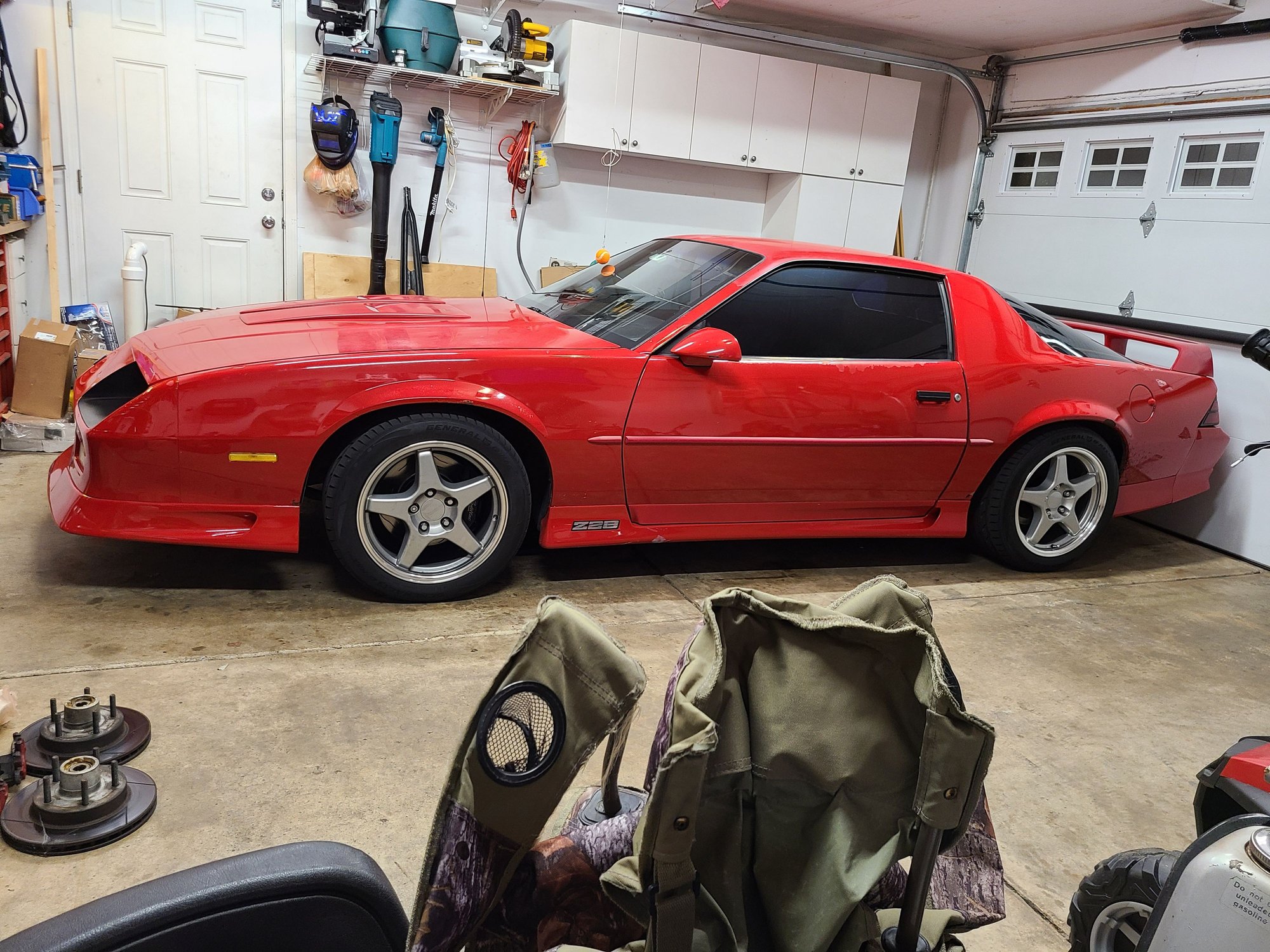

Never shared proper before and after pics:
Before
After

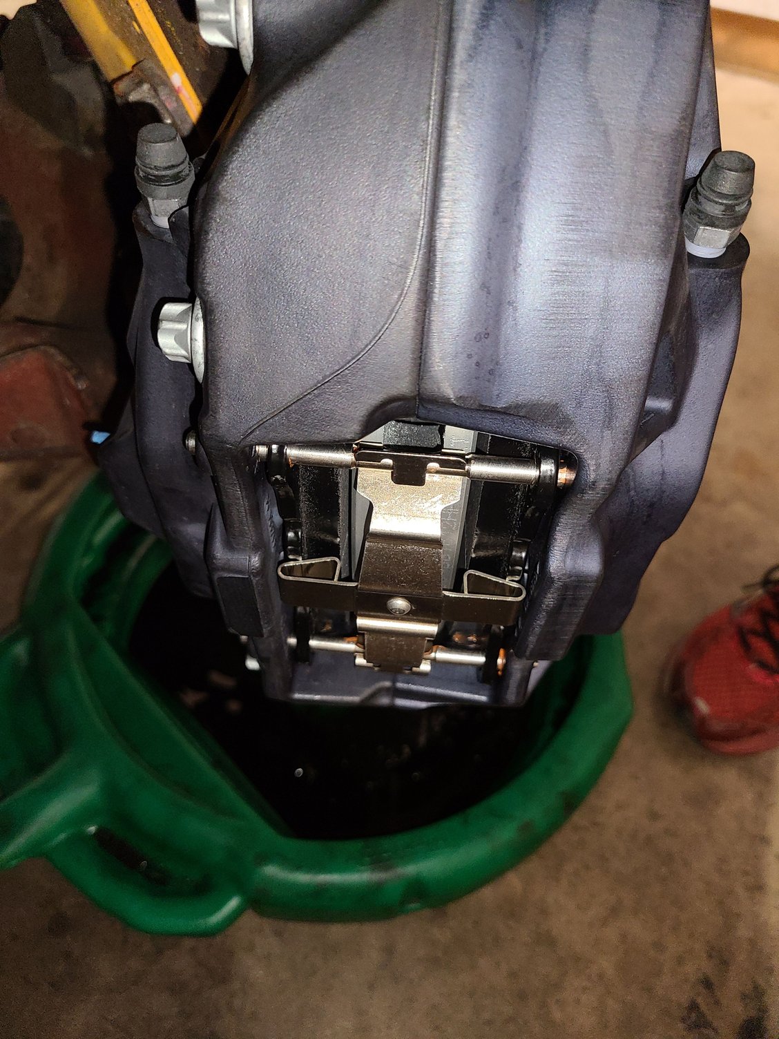

All in all, still breaks great! Also, maybe it was a result of flushing some more old fluid through the system, or doing a good old fashion two person bleeding job on the new front brakes, but my pedal while driving at least feels much firmer, and applies more braking pressure with the pedal in a higher position than before the upgrade. I still cant quite understand though that while stilling still, I am still able to push the pedal to the floor with the engine running. With the engine off, the pedal is hard as a rock. Is that how it is supposed to be???

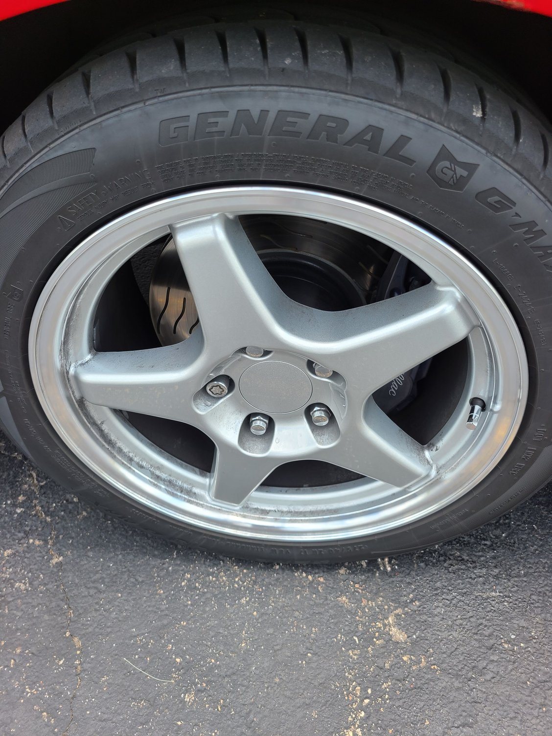

Quick shot after the do it yourself wash... Maybe it was the combination with the rain, but this brake dust was hard to get off, missed a bunch and I went at it with the wheel brush for a little while...

Originally Posted by raptere
Yea, so the improvement in braking performance is pretty EPIC! Last night when going to start my bedding process, I started applying the brake for a firm stop as I would have with my old stock brakes, and I instantly LOCKED both front wheels! From there it took a little getting used to the new feel of the brake pedal, but this decrease in needed pressure is exactly what I was hoping for! With my old brakes I had to press the pedal literally as hard as I could, and brace myself in the car to do it, and only then would I lock the front tires.
The drastic increase in front braking makes me glad I had previously put in one of the 1NCR5 springs in the stock proportioning valve to add additional pressure to my rear brakes. Without it the rear brakes would have been doing even less. With this configuration they still generated some heat during the bedding process, so they are working still.
I should also note, I used a good amount of the Permatex Orange Silicone Extreme with Ceramic Solids brake grease on the back and sides of the pads as well as on the pins, but so far there is absolutely no squeaking, squealing, grinding or anything! I don't recall if I mentioned it in this thread but I saw the note about autox in the description and went with the Hawk HP+ pads, then quickly got nervous they were going to be really annoying on the street, but so far so good. They do seem QUITE dusty though...
Quick update on these two topics:
The Hawk HP+ pad and rotor combo I'm using DOES eventually begin to squeak/squeal at low speeds with light braking, basically when they're cold. Nothing at high brake loads or higher speeds where you get a little heat into them. I think it comes with the territory, so I'm just ignoring it. You can adjusts your braking style to minimize it for street driving. I almost treat it like a badge of honor for having racy brakes...
While I'm not advising against it necessarily, I just want to share a word of warning to those using or considering the 1NCR5 springs in the stock proportioning valve. It really does seem to increase rear braking. I was driving spiritedly yesterday, and hit the brakes pretty hard on a highway off ramp from about 70 mph, and for the first time I actually noticed the rear end loosen up and start to step out on me. Luckily I was able to just release the brakes to get the rear wheels spinning full speed again then engage the brakes softer with no problem, but its something you have to have in the back of your mind, and be prepared for. I think it also allows me to get a little more rotation when trail braking at autox events which is helpful, when I get it right, since my car tends to understeer tight turns.

Word to those out there considering playing with their proportioning valve springs. In my setup at least it was brought to my attention that at a recent track event, when I braked heavy into one of the turns, I was locking up my rear brakes, telling me I got the bias too far to the back. The 1NCR5 spring is 1.5" long with a 30.82 lb/in spring rate. I need to try to find a spring with a slightly lower spring rate... based on my calculations the factory one is somewhere around 18 lb/in.
Old Mar 27, 2025 | 03:20 PM

The brakes are still amazing overall. I just finished building a new 383 engine, that has a bit less vacuum so we'll have to see if that has any effect. Not quite on the road yet...
I did end up swapping to a WD Jones #278 spring. It is much closer to neutral, but still a little too much to the rear. I'd suggest anyone starting down this path, just plumb in the variable brake bias valve. That way you can tune it how you want...
If you're considering some variant of these brembos, I'd say absolutely go for it! Only regret possibly is not spending the few extra $ for the calipers from the cars that say Camaro on them instead of Cadillac. But if money is a significant challange, the Cadillac calipers are still the cheapest way to go...
