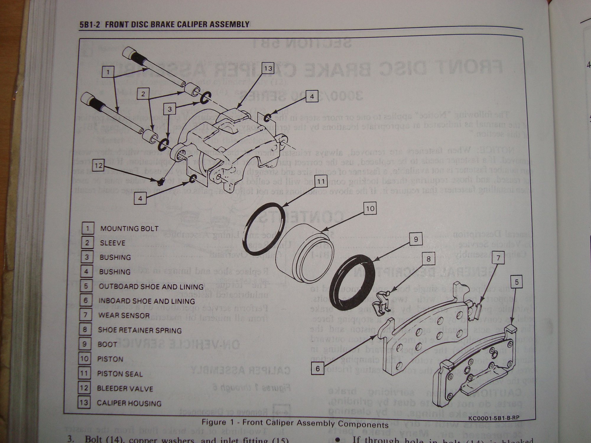

Need to lube the sliders for the calipers. The two metal sleeves on the caliper retaining bolts that slide on the rubber o-rings that are in the caliper. Plus the end of the retaining bolts and o-rings (#1, 2, 3, 4 in diagram). I use dielectric grease for this.
And don't forget to squeeze the two retaining tabs on the outer pads, #5 is pointing to one of them.

Thanks for those diagrams. And I agree for all the reasons stated about the leading edge.
It's just weird that I never heard anything in the forward direction - only reverse.
But that happens so quickly that it's easy to dismiss. How much time is spent in reverse compared to forward?
