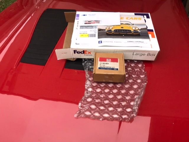

I just ordered my kit from Aaron Hardy at Connell Chevrolet Connell Chevrolet. $63.00 It includes free overnight shipping. The phone number in the thread is the fax number. It is 714-546-9400 to speak to Aaron. He still has over 40 kits.

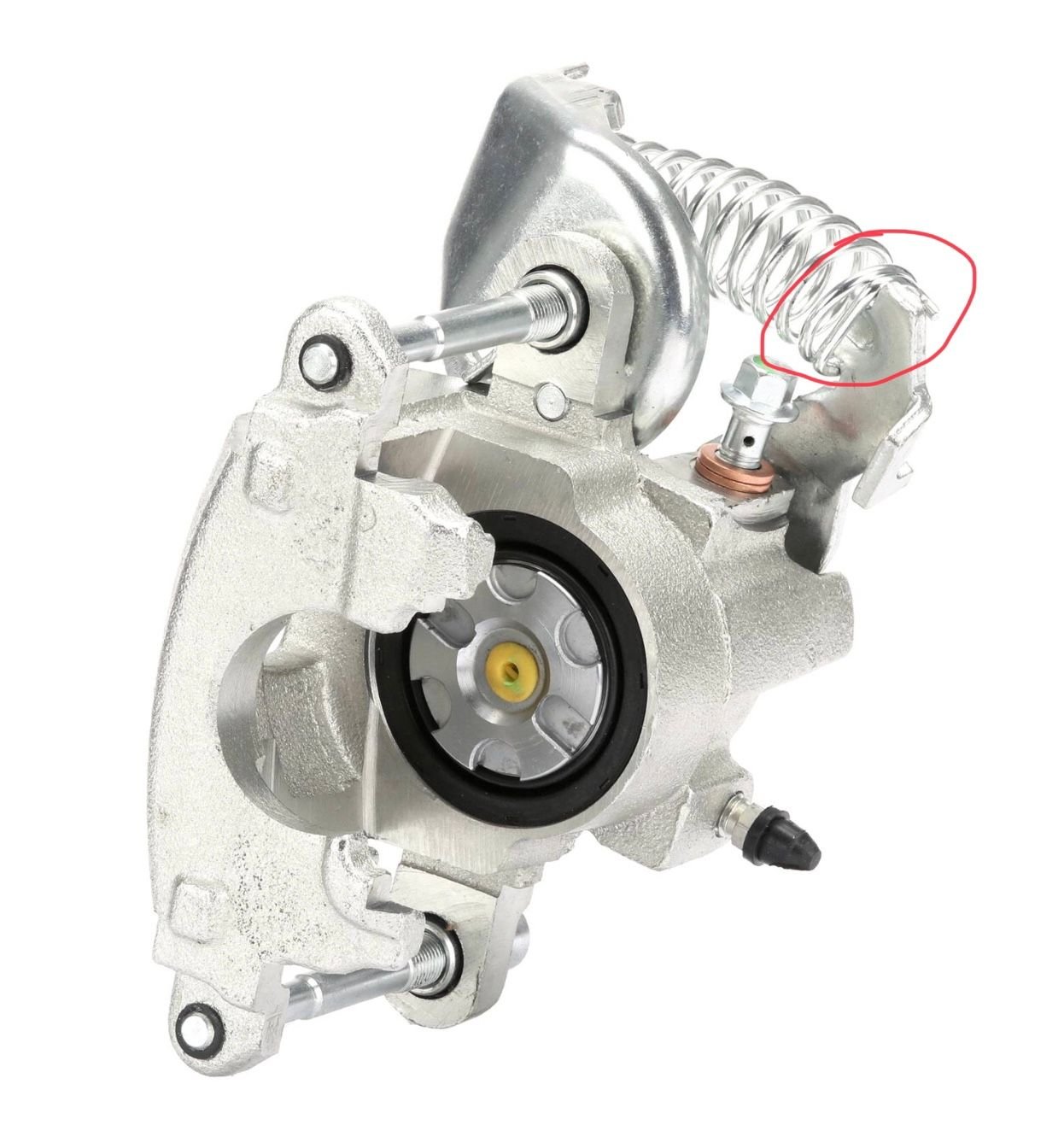

ok great, I hesitate also to buy on the web site rockauto, 2 new calipers NUGEON, the price is not high, but this product fixe also the problem on poorly ebrake and the bad rear braking ?
https://www.rockauto.com/fr/moreinfo...51414&jsn=4596

Kit received from Aaron Hardy, Connell Chevrolet. With FedEx overnight shipping.

That is one solution, I have also send an email to NUGEON for confirm if their products are fixed and no ? their response is yes fixed with last upgrade(but i have a doubt... )

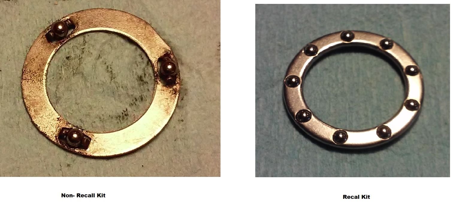

I bought two ACDELCO rebuilt calipers #18FR790 from Rockauto in 2018 during my resto.
Neither had the repair kit installed, nor did they work due that fact.
Bought a kit for a few dollars on ebay, installed it and everything was golden, night and day difference in operation.
What makes the kit actually work is a new bearing assembly with more ball bearings and a different spring to change the tension.
Comparison of the bearing assembly inside the caliper piston.

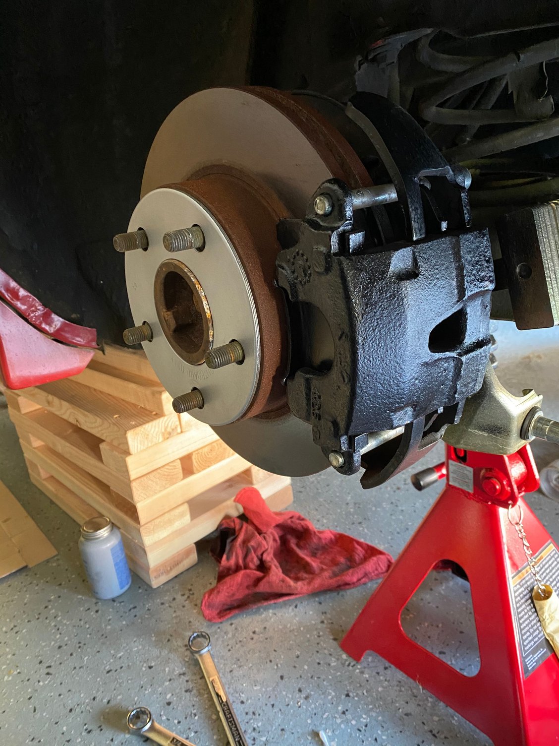

Thanks dude, yeah I'm going to swap out the calipers as clearly the drivers side isn't backing off after hard braking...
https://www.oreillyauto.com/detail/c...=caliper&pos=6
That should solve that problem.

Yeah makes sense, thanks as installed the calipers and bled them out. They grab nicely as you can see the bushings move way better than the old ones. Also cleaned up and threw some brake grease on the pads so no more squeaks.
Plus the driver's rear shock bolt was completely undone sitting in the foam piece so tightened that down, thank god it didn't wreck the body mount. That's fixed as the jingle is gone and feels tight in the rear, go figure if a nut isn't on a bolt
Took it for a drive the pedal is low so need to adjust them but there is no more rub sound so fixed that for now. However, the parking brake brackets and springs are a bit different than previous ones so I have slack in the cables and I can hear the cable(s) dancing on top of the driveshaft. So need to adjust the calipers with the procedure and cable slack as believing there is an adjustment towards the center of the car?

It’s up here...
and make sure that the spring is on the arm here. I made mistake and had to move it, as I left it on the front 90* where the cable slides in. Then after checking, I realized it needed to be on that slot to give more tension.

Re: Rear caliper repair kit 18019028
Thanks... explains the noise on the driveshaft, ugh that looks like dropping the driveshaft though
Think I'm going to see what the difference is between the levers on the new vs old and swap them during the adjustment procedure. The other thing was the lever on the passenger's side was rubbing on the brake hose. Will report back later.

Not necessarily, I used a small vise grip to hold the long adjustment screw, then used a long socket turning it little by little by hand. Tighten with vise grip, move both vise grip/socket, then tighten again, again, again, again...I think you get my point 😁

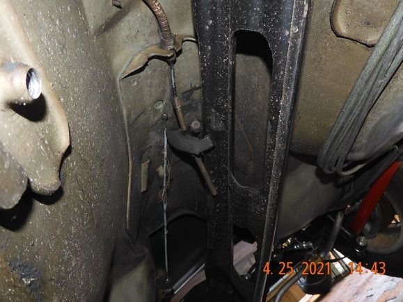

All fixed up, the cables had fallen from the body mount and one came out of the pull mechanism. Easy fix and adjusted them up with the backoff procedure and they grab like a burr on a pant leg now, lol...
No rattles, groans or squeaks

What were you referring to with the spring on the arm? How does it come from the store?

I was asking early about the springs because I needed one ( before these arrived with new springs installed). Except for the brake line, and the fact that the spring is removed in this pic, this is exactly how these came out of the box:

Sorry you had troubles @Annihilate hopefully the new ones will be easy-peasy. On my rear drivers side, it was hard lined and did not use a soft line (rubber brake line). When I shopped at Pepboys here in NJ, they had the calipers in-stock and they where complete with arms, springs, etc... All you needed to do was slap some pads in, note front pads are the same as the rear disk pads, and hook up the brake line. I bought my pads from Advanced Auto, their brand 'carquest platinum'. They work very well.
