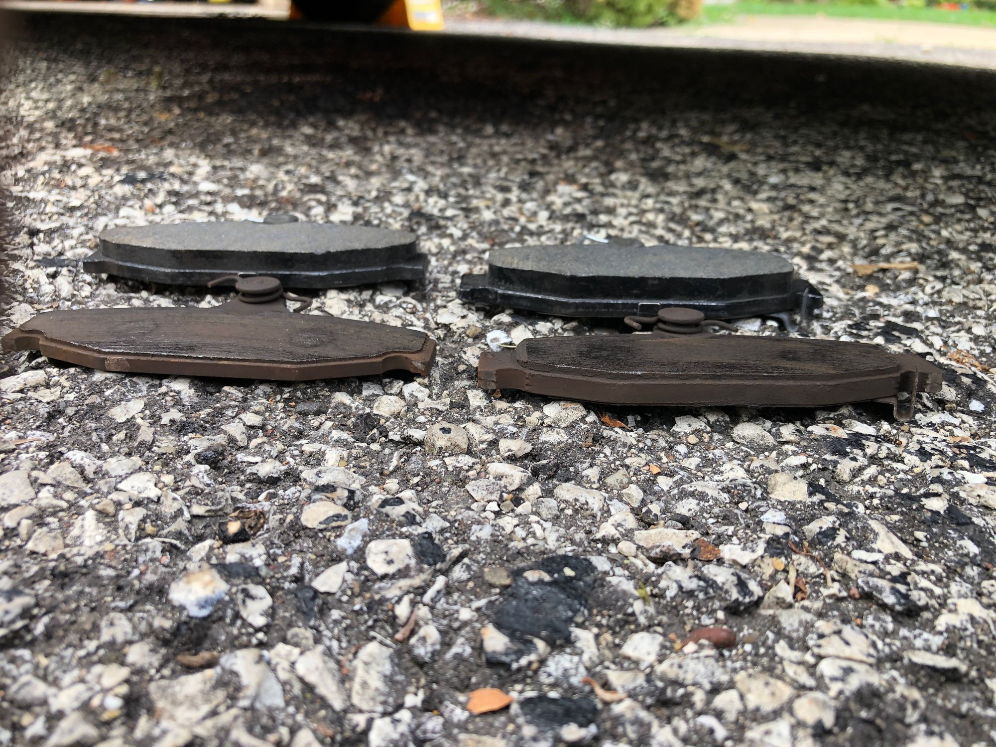

I need new brake pads for a Baer kit I put on 20 years ago. I remember being PBRs up front but are the rears PBR also? The car doesn't go to the track any more so just need something low dusting and inexpensive for the street. If I search for pads for a 1996 Corvette would that work?

Pictures of the calipers will help a bunch but if they are what I have, 1LE/ f-body, L98 C4 vet use the same pad.
Different materials from factory I'd bet but for just cruising around, you'll be fine with any performance replacement pad for those calipers..

My guess is the front is LT1 Corvette, and the rear are LT1 Camaro. Call Baer and ask if they have records of what they made going back that far.

Went with the '96 Corvette pads and was correct. As expected, much better than my stock especially with drum rears. I don't track the car any more so just Amazoned some ACdelco semimetalics. At the time there weren't as many options figured out and I and a Baer discount voucher.
