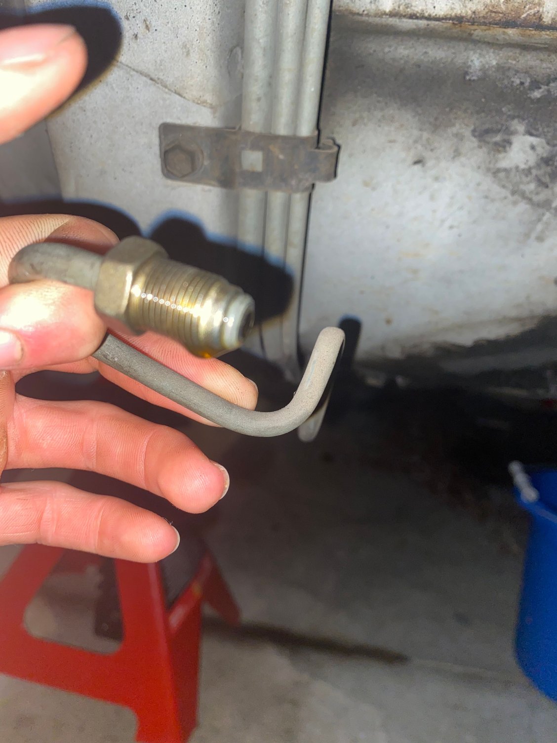

My car is a 1989 and it was equipped with drum brakes in the rear. My issue is that the hose that bolts to the axle with the "T" to go to each caliper was cut from the previous owner (to remove the axle I believe) and I was going to reuse the one from my third gen but the fittings look different. See pics below
This is the line from my third gen. The fitting is slightly different compared to the one from the 4th gen.

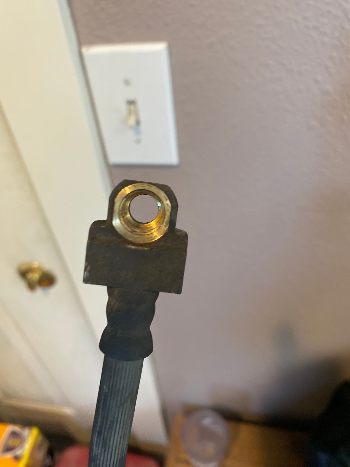

3rd gen line from the top. This is the hole where it bolts to the axle

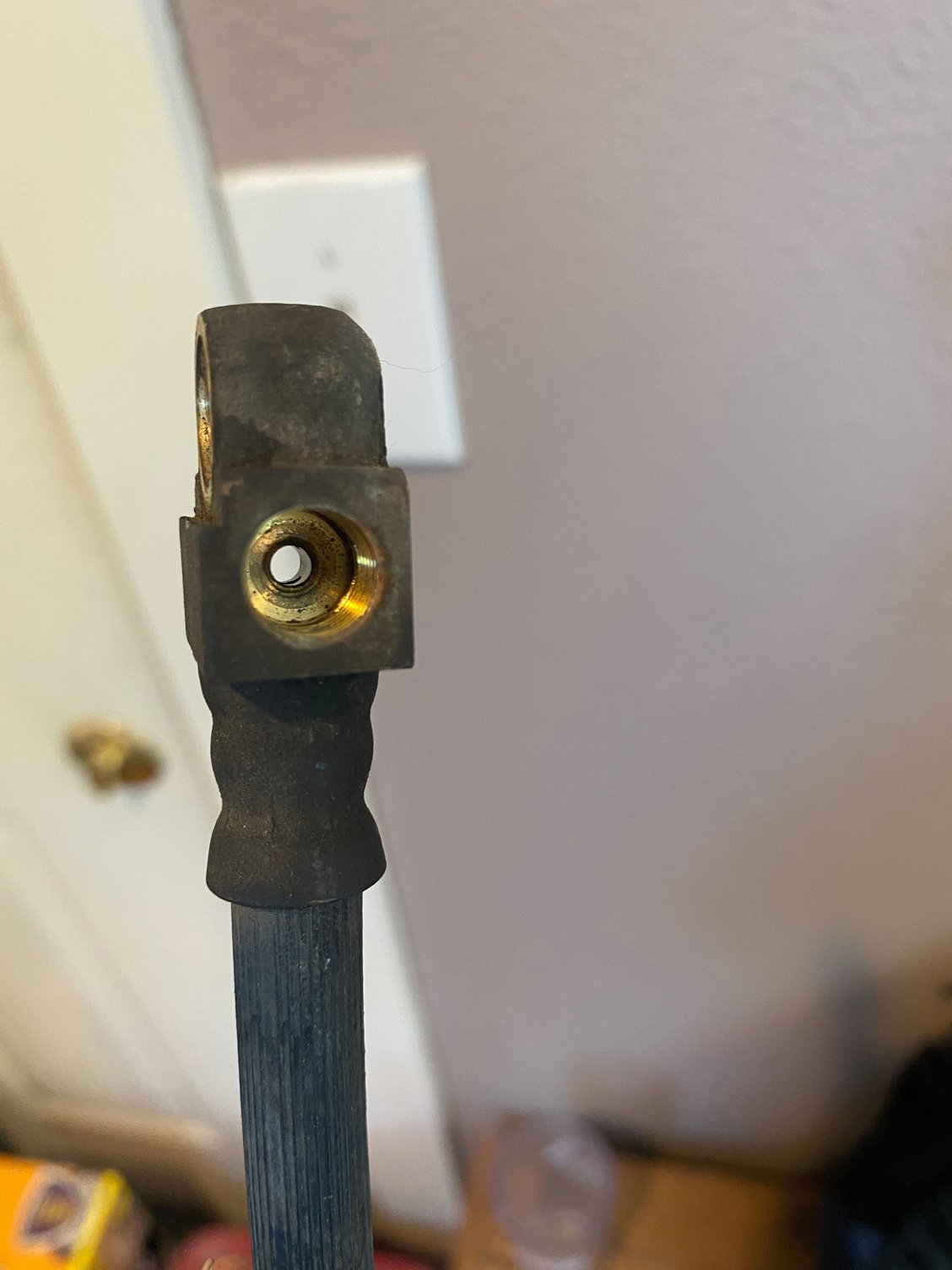

4th gen line. Again notice the difference from the 3rd gen one.

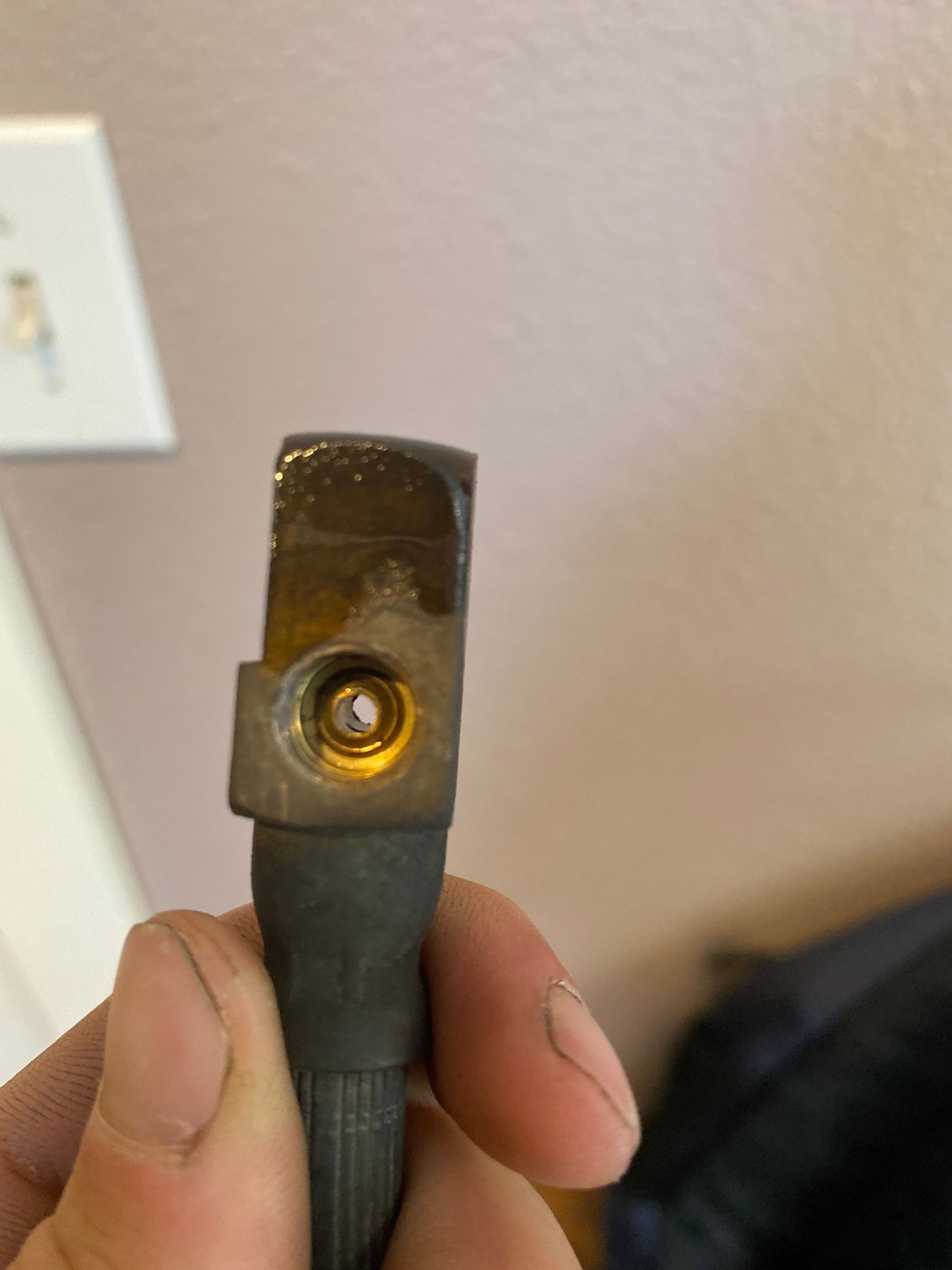

4th gen top view.

The 3rd gen line is SAE inverted flare. The 4th gen one is metric bubble flare. Prob 6mm.
You'll have to look at what's on the car, where the steel line screws into the rubber one, to see what it is.
IMO probably the easiest thing to do would be to make the rear match the car totally. If the car is SAE there, then get an early rubber hose, and replace the lines on the rear with sticks of line you can buy at the parts store, and use SAE -> bubble flare adapters at the calipers. If the car is metric bubble then you should be able to just buy the right rubber hose for the 4th gen and use the bubble flare lines that are on the rear.

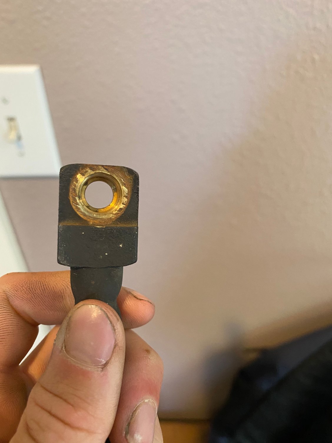

Just to be clear, the hardline I sent a picture of is where the softline screws into. The hose I bought solves my issue with the calipers, I just need to mate the car to the center brake hose now.
The hose I bought is below.

OK, the hard line on the car is metric bubble flare.
The hose you bought is SAE inverted flare, at least, where the steel lines on the axle go into it. Not compatible.
If your new rear still has its original steel lines on it, you can probably buy the 4th gen hose, and it will hook up to all of what you've got, and work. The hose you bought, won't.
