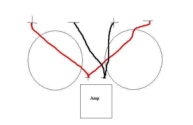

if one sub hits in then out, and the other out then in, you have the polairty of one of them switched... they both should move the same way no matter what... unless for some reason you have them in sterio, not mono, and the sound is only on the right/left side
No. If you have them running out of phase, one speaker will do the total opposite of the other. This will cancel out the sound of both subs. Don't believe it, try it. You will have two subs that will be moving a hole lot of air, but not creating any sound waves.
The same thing happens on any speaker. If you have two 3 1/2" speakers with a 1" dome tweeter on them and you run them out of phase, they to will cancel each other out. It isn't as noticable because the sound waves move so fast at higher frequencies that it's harder for our ears to detect the change.

but what im saying is that if you hook up subs in mono, witch most people do, because they bridge the channels on the amp, i cant change the phase, because they both hit at the same time because they are in mono

I know what you're saying and what you're saying is wrong.
If you hook it up like the pic below, the speakers will be out of phase and you won't hear much bass, if any at all.

why would you ever hook up subs like that? out of all the ways ive ever seen subs hooked up, or hooked them up myself, i have never seen that. if they are ever hooked up like that its with the + to + and the - to - so when each sub hits, it hits the notes at the same time so because the sound waves are being produced at the same time and frequency the amplitude is doubled.... either that or you run them in series + to - but then again they both hit at the same time.
Normally the only reason you would hook up + to - is if they are in series, not parallel.
Ya know what. I misunderstood this post. I thought you were simply telling him that even if you have them running out of phase, they should move the same way no matter what.
Now that I read it again, I understand that you were simply pointing out that if one moves out and the other moves in, then that means you have them out of phase.
Then in the next sentence you point out that they both should move the same way. Use actual sentences. The "...." is used as a continuation of one sentence which is why I misunderstood.
Now I understand what you were saying. The reason I drew that pic is to show what it looks like if you run them out of phase. Basically what NOT to do.
Sorry about the confusion. We are both on the same page, I just didn't realize it by the way you worded your post.
