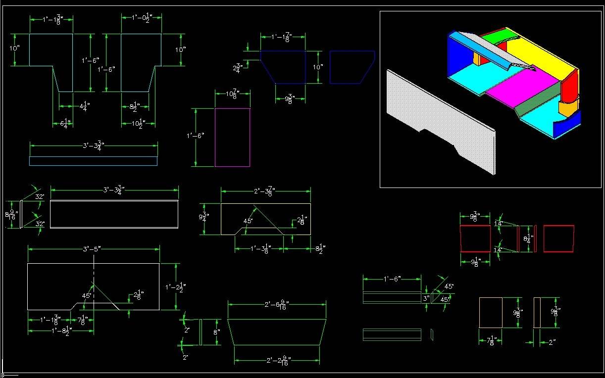

I need sub box dimensions
Old Feb 2, 2003 | 07:47 PM
91GTA350's Avatar
Joined: Dec 2002
Posts: 72
From: New Jersey
I know everyone says they are posted all around, but I cant seem to find them. I need the dimensions for a dual 12'' box thats fits in the rear well so tyhat it looks flat.
Any help is greatly appreciated. My MDF is sitting in my friends garage waiting to be cut.:hail:

I need about 1 cu. ft of airspace for each sub. They are either going to be Infinty Kappa or Infinty Perfect 12'' subwoofers. I do own a tape measure, but Im not very good with cutting wood, and i need speicifc dimensions so my friend can go ahead and put together the box.

i can measure mine for you if you need it but its not level, its angled. it is 1cub ft per sub though.

i swear you must not of looked hardenough cause for the past three months i have posted the dimensions 4 times... it isnt that hard man. let me find em for you....
https://www.thirdgen.org/techbb2/sho...hreadid=152606
less then a month ago......

yeah, i'm glad i held onto that diagram from when i built my first box (2-3 yrs ago). i post it about once a month around here. a sticky would be a good idea. too bad i dont know who i snagged that pic from. want to give credit where credit's due.....one of few who actually spent time on a schematic now if only i stopped being lazy, i'd be able to make a diagram of my 1/2 well single 12" box....

The dimensions in that picture are wrong. The notch for the top is too small and doesnt match up with the bottom. I just tried to remodel it in autoCAD and it had me pulling out my hair trying to figure it out. =P
It's not supposed to.

Has anyone actually built this box?
Has anyone actually built this box? I keep reading that posts that say the dimensions are off and others that state they have never built their box from this blue print.... I have a couple of buddies and we are all getting together this weekend to build speakler boxes. They are building for home but I'm building for the bird. Thanks!
