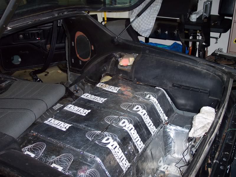

Anyone ever remove Dynamat Super sucessfully? I'm really not looking forward to this cause it's on good and has been there for a while. I've done the huge stereo thing in this car, now it's time for a little resto work and I've got Dynamat everywhere.....(usually a good thing)! Any thoughts?
The Back.....
Passenger Side.....

sharpened putty knife, heat gun, and a LOT of patience. I dont envy you this job. It sucks.

Try and get it as warm as possible, to get the glue tachy and maybe it will come up.
Why do you need to remove it all?

The car is being changed into a race car of sorts, and it's not going to have any carpet or floor coverings and I don't want the Dynamat down anymore.

Well, I've got a decent solution to it all. You have to get Dynamat Super just past warm and pull it like you would pull double sided foam tape. As it stretches the glue breaks free. You can't get it too hot or it will turn to gum and too cold and it just breaks up into tiny pieces. This is about 2 hours worth of work. It took a lot of trial and error, but I think I found about the right temp to pull it all up pretty quickly. I used the torch to see if I could burn off some of the glue without getting the panels too hot to where they would start to warp and stretch.

Well, after much trial and error, i found out that we all pretty much had it right the first time. With just enough heat, the Dynamat gets pliable again and the glue becomes tacky and you can pull the foil backing off and then pull and stretch the Dynamat itself and the glue loses adhesion and comes off. You can see where I tried to scrape on the top of the well area and it left LOTS of residue. Pretty much everywhere else is pretty clean with only small spots of glue left.....and that will come off easy enough.
I still have the pass side floorboard left and the very bottom of the back well, but know that I know how to get it out, it won't take any time!
