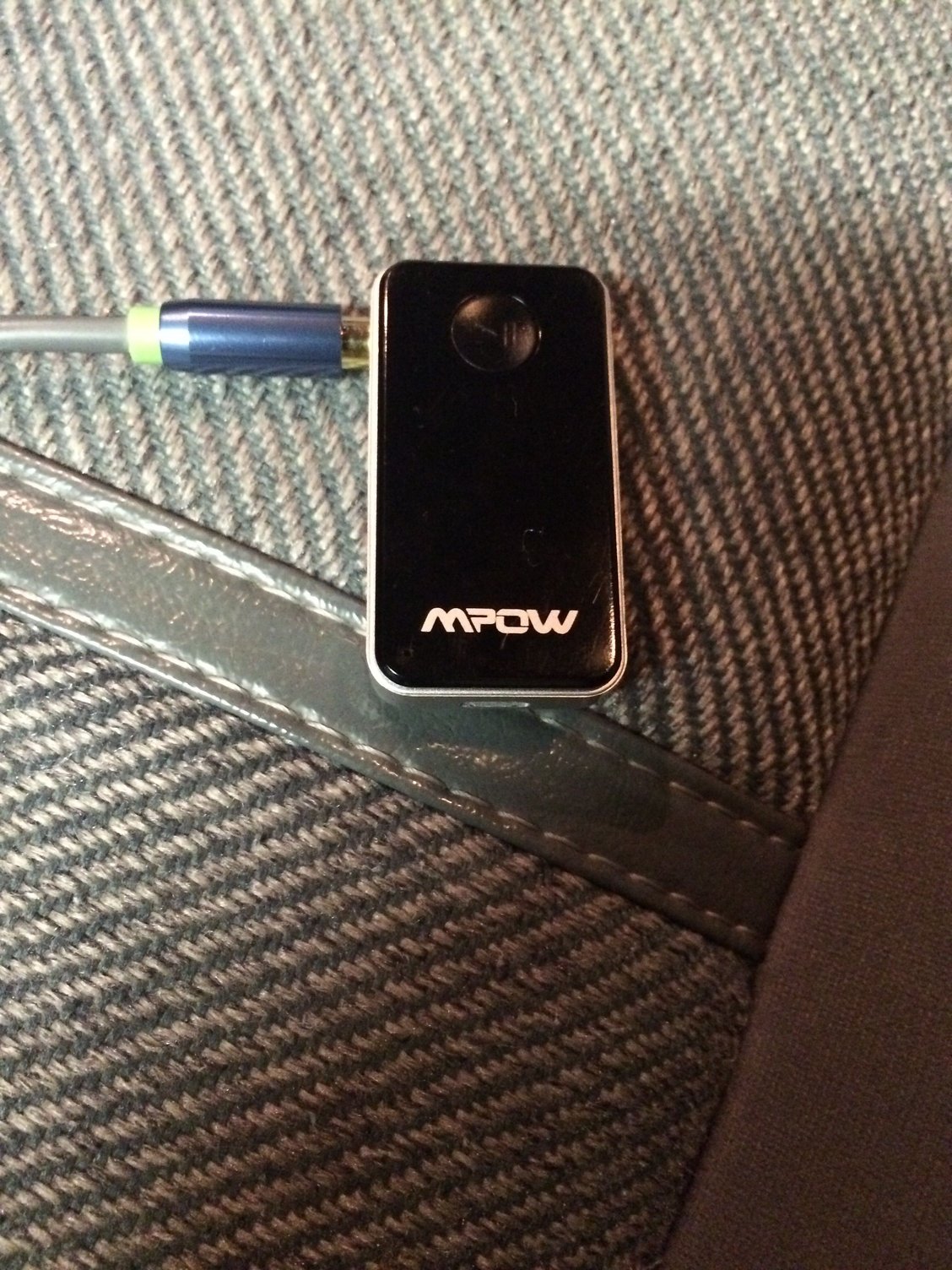

This is what I plug into my factory radio's newly installed aux cable connection. Not sexy but it works.

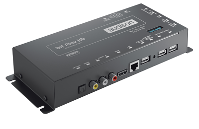

Yo should also checkout the Bit Play, which is really what you're looking for.
Audison bit Play HD240 SSD
