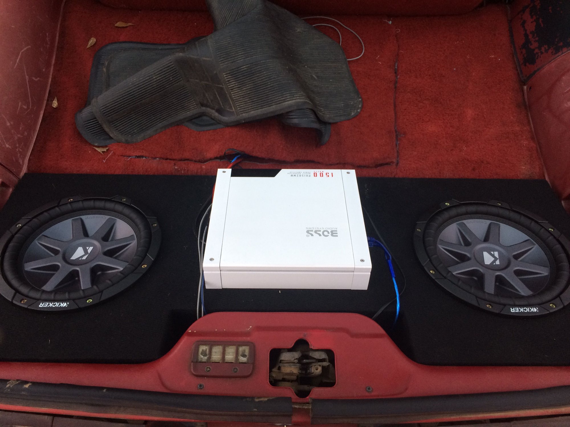

I actually just got a RS last month I looked on crutch field to find speakers that would fit then when I found some I like I checked Amazon for a lower price
It's 4x6 in the front but my dash was cracked to I just cut it and through some pioneer 6x9 in I have a pioneer HU
I bought these for the sail panels http://www.crutchfield.com/p_20641D6...41DSC6934.html after installing I realized my HU can't fully power 4 6x9 so I'll have to get a highs amp.
My subs http://www.amazon.com/gp/aw/d/B004JBNKCG
My amp http://www.amazon.com/gp/aw/d/B00BQOASC4
I bought the box from hifi sound connection
I ran 8 gauge wire as for wiring I rem the seat and ran the wires straight back

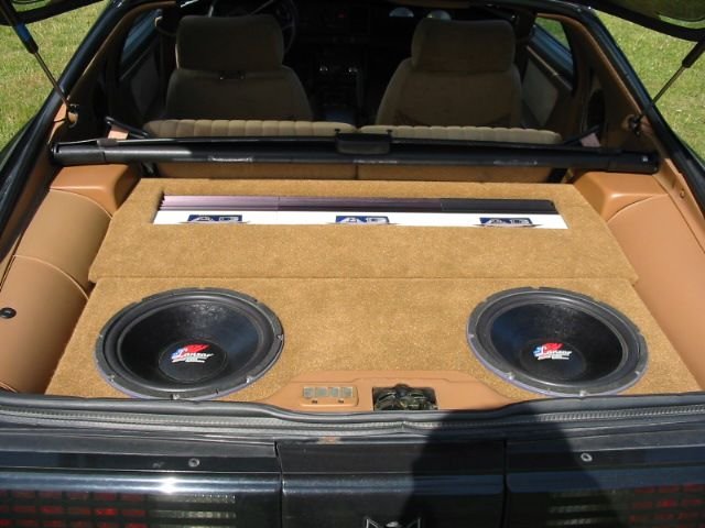

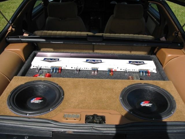

If you want "loud" bass, then you need big bass in our cars. Dual 12's .. Properly sized for their box. Seal the box well. If you also want quality bass then you need high end subs. I had dual 12, Aluma Pro subs in mine at one time.
You'll need quality Amps too. At least one for the subs and 1 for the others. You don't necessarily need high wattage. You need high quality.
Ditch the 6x9's and used round speakers. You'll need to fab up a plate out of MDF but it's easy.
Ditch the 4x6's in the dash and go with door or kickpanel speakers. Again, quality...
Ditch the factory wiring for the speakers too and step up the awg.
Be prepared to compensate for the squat in the back with the weight from the subs/box .. at least I had that problem.

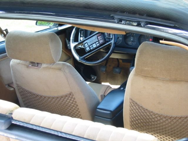

Here is what I did, I ditched the rear speakers all together and focused on my front stage.
I created some kickpods, using a 6.5 mid and tweeter, using the stock panels.
For the sub box, fiberglass is the way to go. It will be much lighter, and once you practice a little working with it, it's not that hard to do.
passenger side kickpods
Drivers Side kickpods
IDQ 12s

Can I get some more pics of that cup holder and how its working for you?
How do you think that would be on a Manual?

Pics are old, but was my set up back in the day. I quickly swapped those subs for better Aluma Pro 12's.
6.5's in the kicks and 5.25" in place of the 6x9 but oly because they were high end JL's .. 6.5" would be preferable.
Those are 3 amps that I mounted together. Custom amp box that has the wires glued to the bottom of it.

Re: I need help, creating high quality audio.
Sorry the car is kind of a mess right now, haven't had a chance to put everything back together.
But here is another pic of the cup holder, it works great for smaller items like soda cans. Taller items it tends to get in the way.
cup holder
