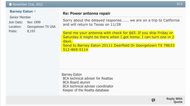

I pulled mine and sent it off for repair. The common failure with these is the nylon ribbon that drives from a drum on the motor and pushes the mast up, or pulls it down when reversed. That nylon gets old, brittle, and breaks. This fellow replaces the nylon with a plastic coated steel cable. The DIY instructions are here on the forum somewhere, but I figured his experience at doing these was worth the modest cost.
Note his ad pictured below is from 2011. I have no idea if he is still with us, or if he still works on these.
