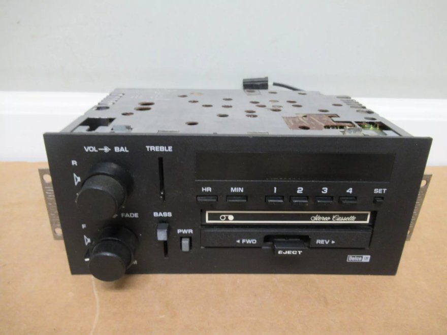

The 1984 Trans Am I'm restoring has the UU7 and UQ7 options. The car had an aftermarket radio when I bought it and I'm trying to put everything back to original condition. I had the radio in the picture below laying around that was removed from another 1984 TA parts car. Anyone know if this is a UU7 radio? I tried hooking it up and the clock displays for a few seconds, goes off and then does nothing. No sound. Fuse is good and dash speakers work (I removed and tested with a receiver to make sure). Guess I'll have to send out for repair. I've seen M&R Auto Electronics in MI recommended in some threads on here. Anyone have any other recommendations?
Next question is what is the gray wire connector on the left side of the radio for? I'm not seeing anything under the dash for this connector. Was it maybe for a power antenna option?

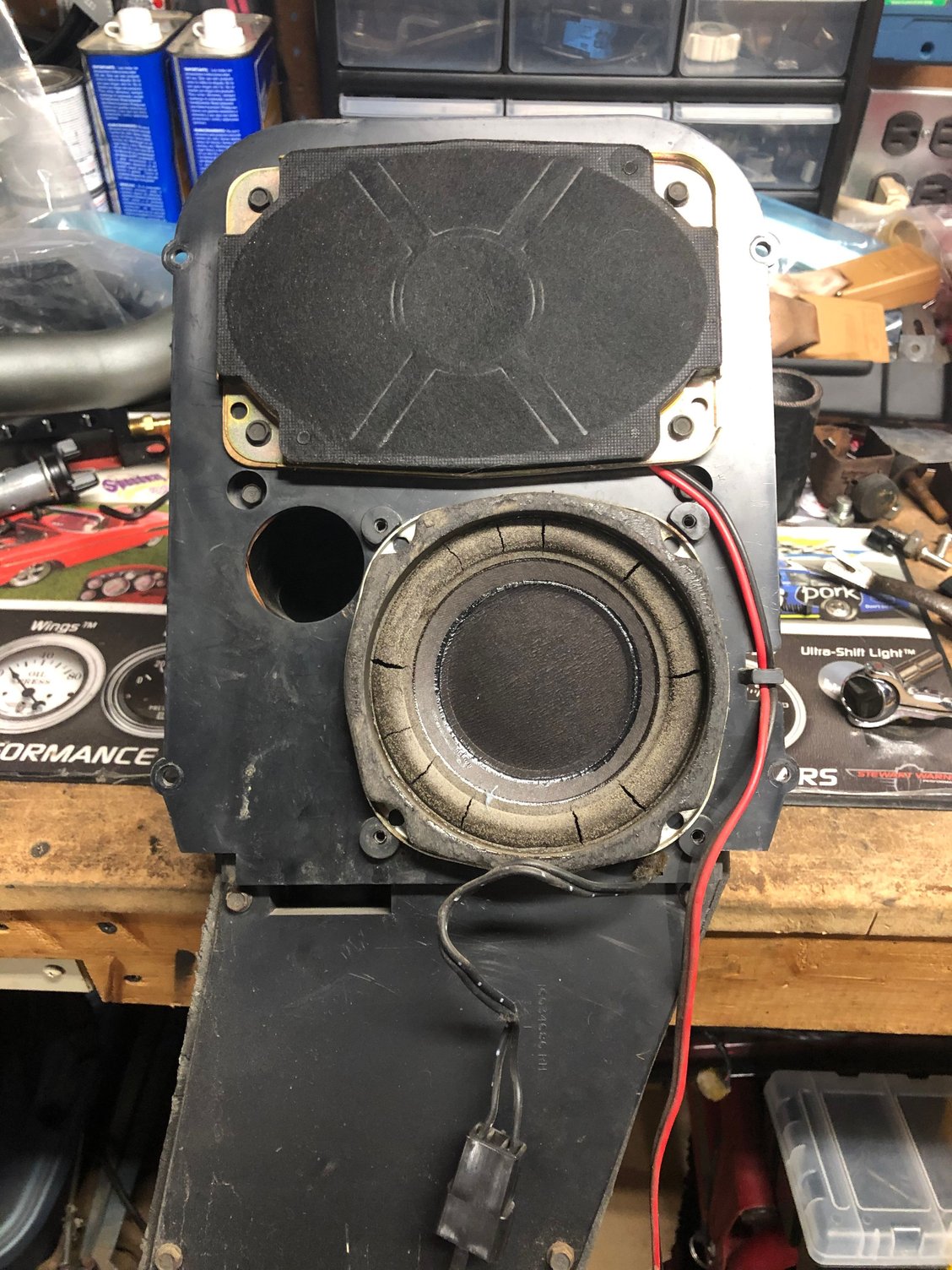

It seems all of the components for the UQ7 option are present, but I'm not sure if they work. I did remove and test all the speakers. They all work fine, but the subs need new foam.
I'm planning to use DynoDave43's thread HERE to try and restore these.

According to the pics in this post I think I have the correct UU7 radio:
https://www.thirdgen.org/forums/hist...uu7-radio.html

Here's a couple pictures of the 1984 Pontiac UU7 radio.
( credit too https://www.fiero.nl The site had he UU7 code and radio part number listed,.. I found pics by searching google; Radio currently on E-Bay priced @ $299)

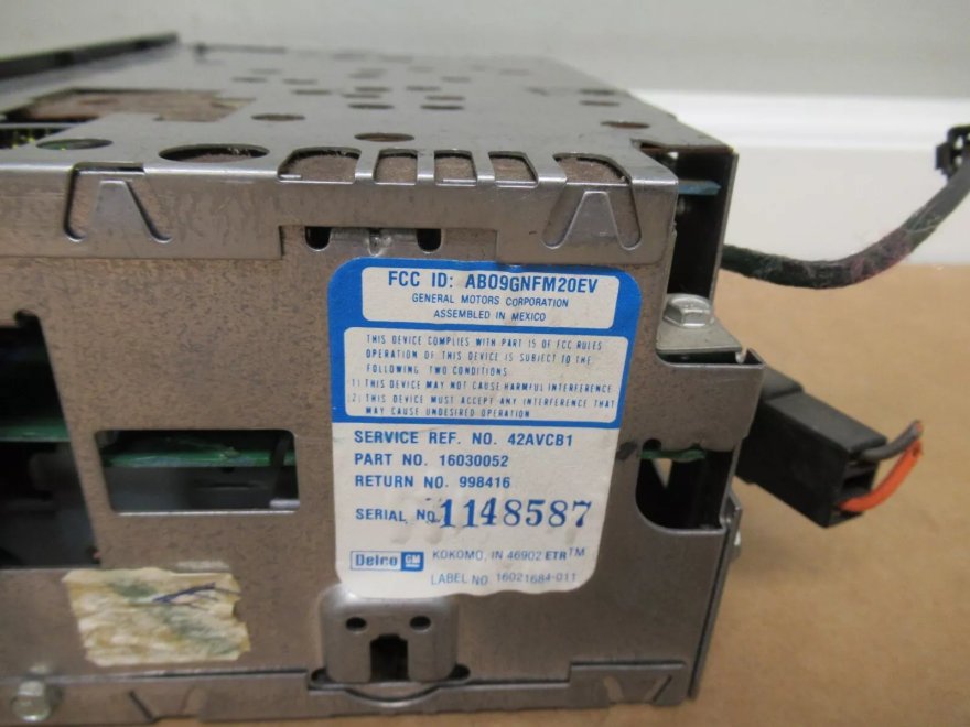

Gotta' search the Part Number ! ( 16030052)
Auction = E-Bay ITEM NUMBER 364325112635
P.S. WAY ( WAY ! ) overpriced !!!

Lol - I’m an idiot! I was searching for the serial number and not the part number.
