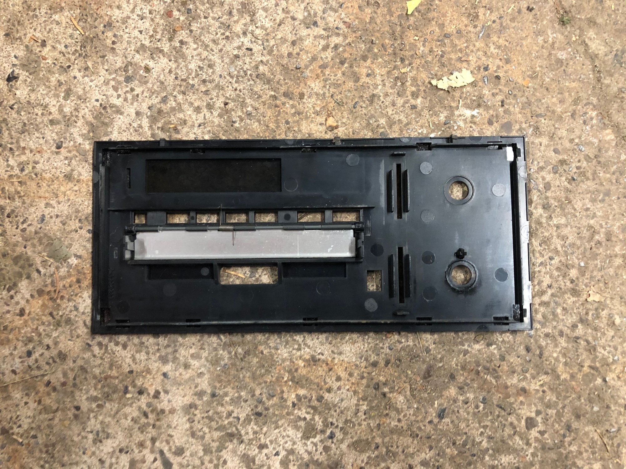

Little update: I installed the radio in my TA and there doesn't appear to be any back lighting. There wasn't any bulbs on the radio face when I removed the faceplate to investigate. I thought maybe the bulbs were just missing, but there isn't even any wiring in the typical bulb areas.

That's a first ! The radio is a little older than most that I play with,... but I've NEVER seen one without any back-lighting before !

I've never heard of a radio without any lighting from that era. Are you sure? Could the bulbs be deeper?
What car did it come out of? Maybe that car had some sort of external light over the radio that shined on the face.
Ask the guys at M&R. They seem to know pretty much everything.

The radio was in a 1984 TA I bought for parts. No idea if it’s the original radio or not. I’m not seeing anything deeper in the unit for lights. I also tried emailing M&R since they’re the guys who restored the radio but I haven’t received a response back.

It might be original. But the faceplate seems kind of shiny black for a Trans Am. I thought that they were always more gray. And even the script writing of "stereo cassette" seems rather Buick-y. And are those chromed balance and fade controls? Doesn't seem quite right for a Firebird. But 1984 is older than any Firebird that I've owned so maybe that's what they used back then.
John (who also seems to know pretty much everything about this stuff) mentioned Buick above, so I thought maybe that he thought that this was a Buick head unit.

It looks like this unit definitely doesn’t have backlighting because the back of the faceplate doesn’t have any transparent areas for the text or anything to light up. Looking like this isn’t a correct Firebird radio. Guess I’ll just have to settle for period correct.

No backlighting. That's really odd. I wonder how well lighted that area of the car was.

My baby brother tells me the grey wire is for the background lighting... he has an 83' Camaro with a similar radio.

He sent me this link and says the lamps are on the circuit board like this later model Delco radio...
https://camaroforums.com/forum/audio...acement-83739/
