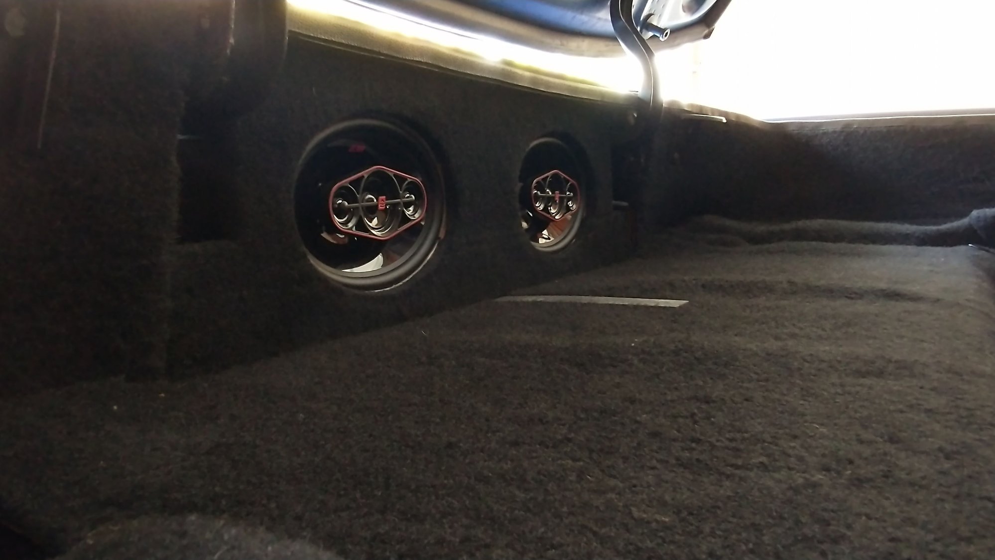

Cerwin Vega 4way 6x9, but their in my vert. So i can verify fitment in your application.

Doesn't the vert have 6.5" in the rear?

Yes, got those too, but i put my 6x9s further back.

Those look good 84 1LE, Kincer did you also replace the front dash speakers??? I was thinking of doing those while I’m at it but heard the fit of the dash ones is tight and not all fit. I do not want to hack it up to make it fit.
