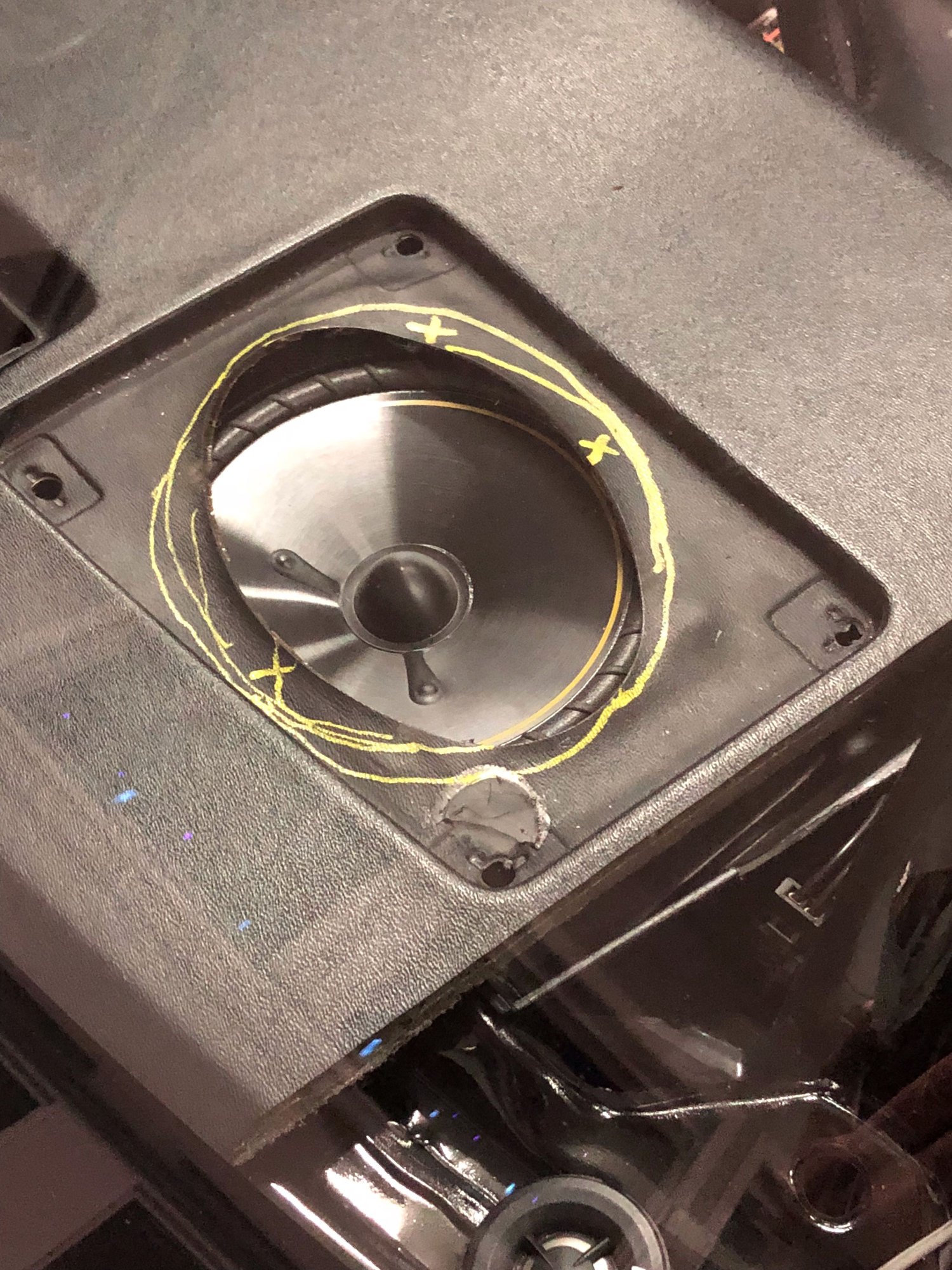

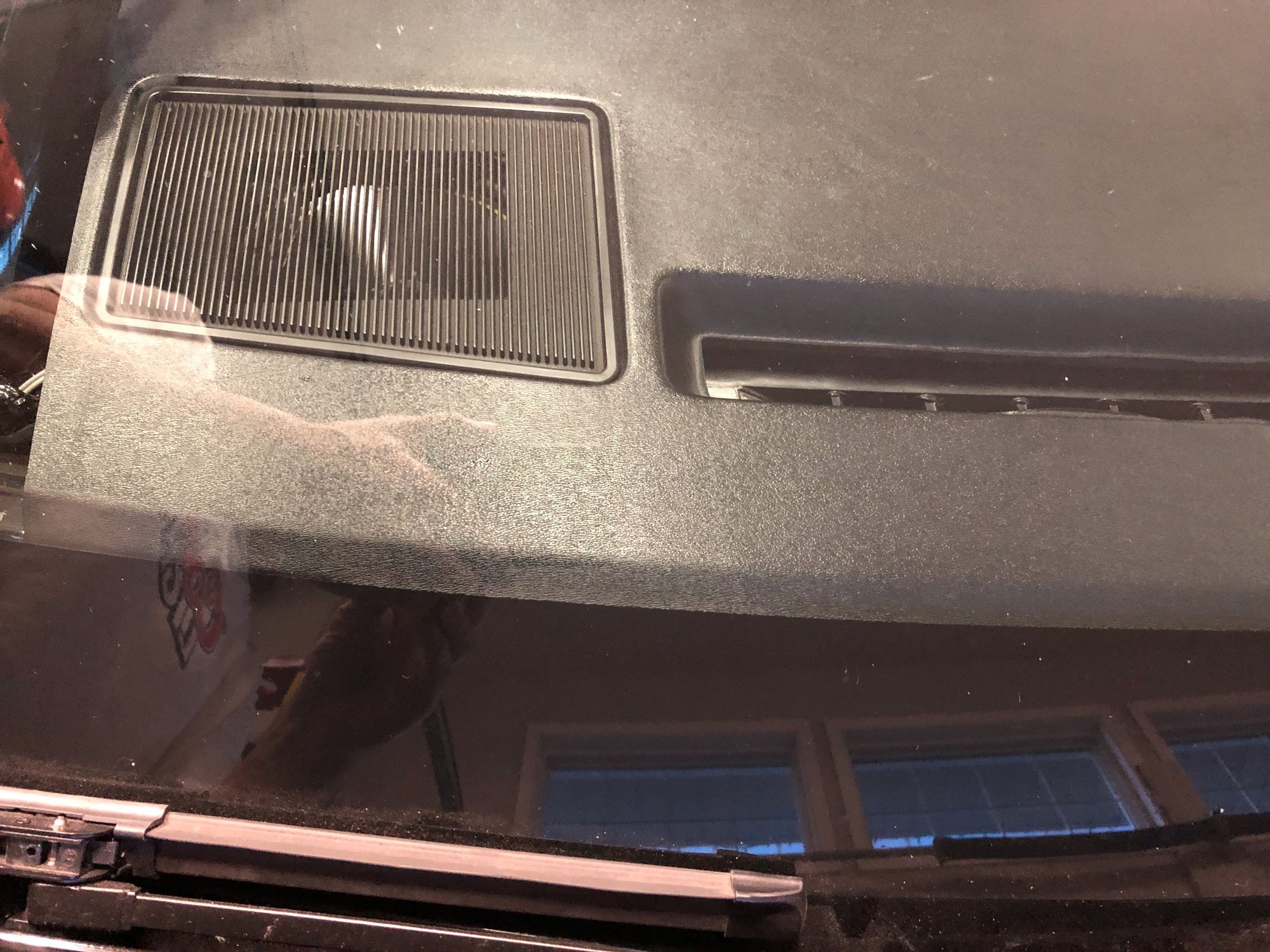

Throwing out another option to door speakers, 5.5 or 6.5 components in dash. Tight fit and requires some mods to vents under dash, but keeps the stock look, other than tweeters in corners on top of dash, also gets rid of POS 4x6s which cannot handle any real power without popping the cones anyway. Can throw some real power to these components and have tweeter DB adjustability.
Couple pics to show some mods required. I am running 75 watts RMS to these, Kicker DS 6.5s and they sound great! Work under grills was performed to prevent speaker cones from hitting dash pad under full cone extension.

It can probably get louder, but unfortunately, without other modifications, it's not going to sound any better than the 4x6s. The big problem with the dash location is that there's no isolation of the rear soundwave, so your lower midrange is non-existent, which makes vocals sound very thin and shouty. I'm in the process now of trying to lay down some MLV on my dash to see how effectively it isolates the rear wave in hopes of getting some of my lower mids back.

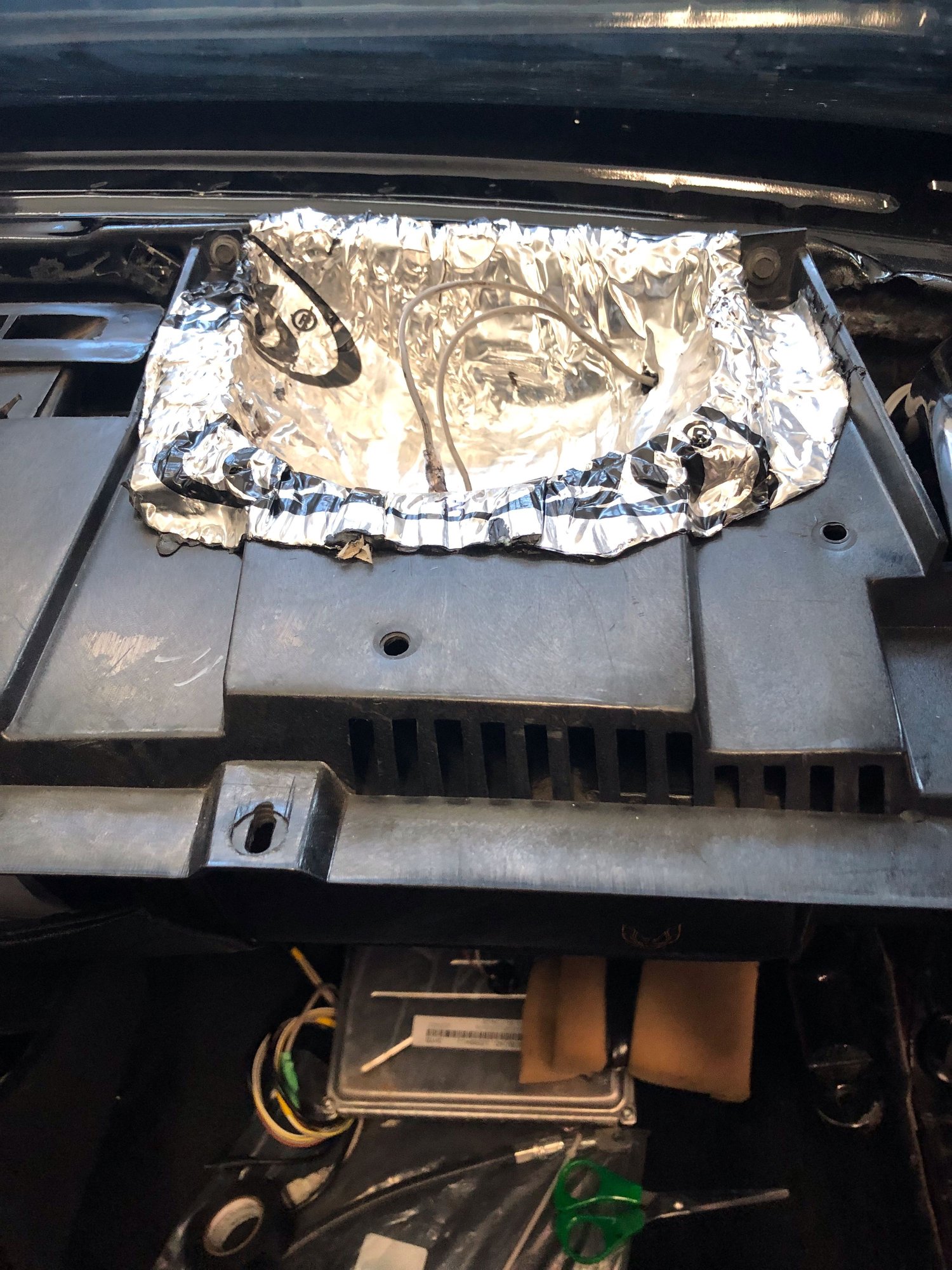

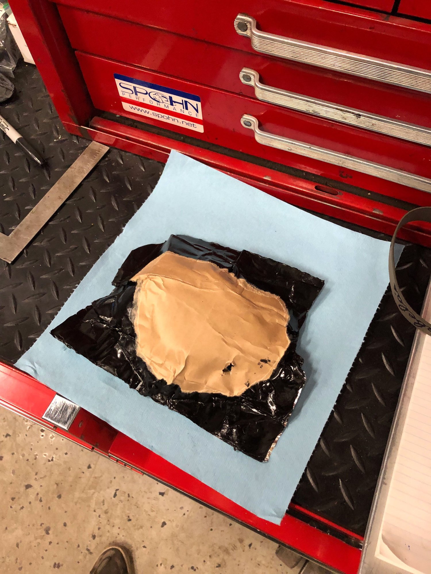

I feel the same way. To combat the loss of a box, I created an enclosure behind using Dynamat. It is not to any specific enclosure size, but does provide reflection from the rear. I left the paper backing on where I did not want it to stick to the under dash components, removing only where it would seal to dash.
